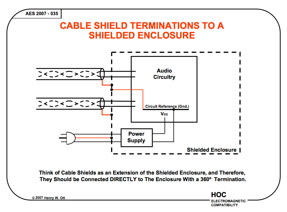

The shield (not the signal return which is inside the shield) is very likely to have current flowing in it.Correct - you should not have current in the shield (XLR or single ended). ...........
H.Ott tells us why and goes on to tell us that the shield should be chosen to have low resistance.
This applies especially for a shield between separate pieces of metal enclosed chassis, but also applies to the shield around internal wiring protected by an enclosing chassis.
Joffe's paper that I linked a few days ago shows WHY the current flows and HOW to reduce that current.

Page22 gives a number of solutions for reducing the shield currents or reducing the voltages generated by the shield currents.
It NEVER claims to eliminate the shield current.
Page36 shows how NOT to and HOW TO terminate the shield.

I would like to think that the only shield current in a correctly set up system should be the signal return current. That there are mains currents circulating through the shield attests to the fact that wiring, and specifically grounding, on the mains side leaves a lot to be desired and this is where initial efforts should be deployed to resolve noise problems.
Often you get ground potentials between the equipment chassis via induction and the earth connection is primarily via the shield and not the ground (ie earth) wires on the mains plugs. This of course causes noise. It is for this reason for example that on power amplifiers I separate the signal ground from the main amplifier ground with a 15 to 22 ohm resistor. The main amplifier ground is then connected to the chassis directly, or through a GL (ground lifter), and the chassis bonded to other equipment chassis through the mains earth connection. This system works well on double insulated gear as well.
This is why Hennry Ott recommends a low resistance shield, its not that the grounding is wrong as such, sometimes the low frequencies can find a lower resistance route via the mains earth wiring. Using a cable with a good low resistance shield helps minimise or avoid this problem.
