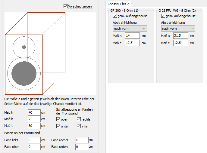

To the OP: try Boxsim. I fiddled around with an 8" and a 1" in the WG148 waveguide, in a 10x16x12" enclosure. The app is quite reliable and this design will almost certainly sound pretty good. Not that you'd have to build it. But it's a good way to learn designing

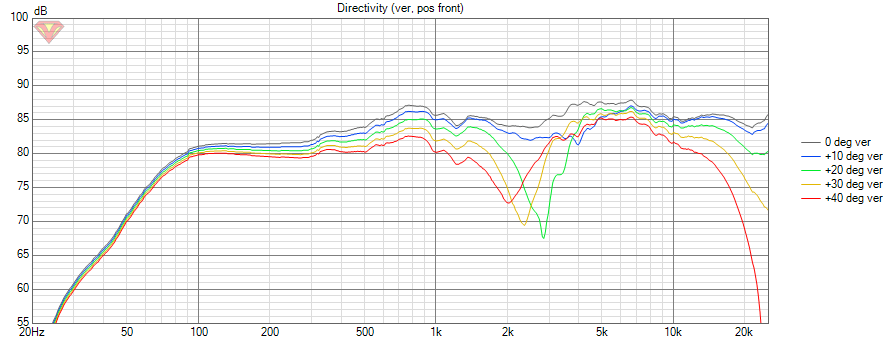

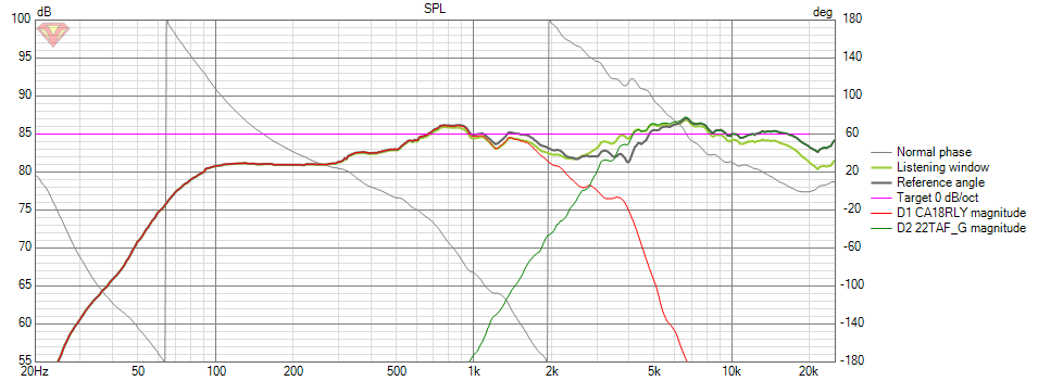

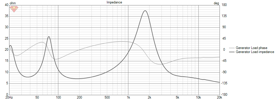

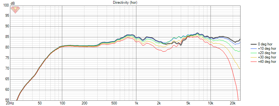

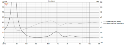

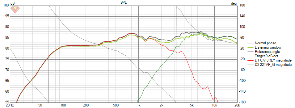

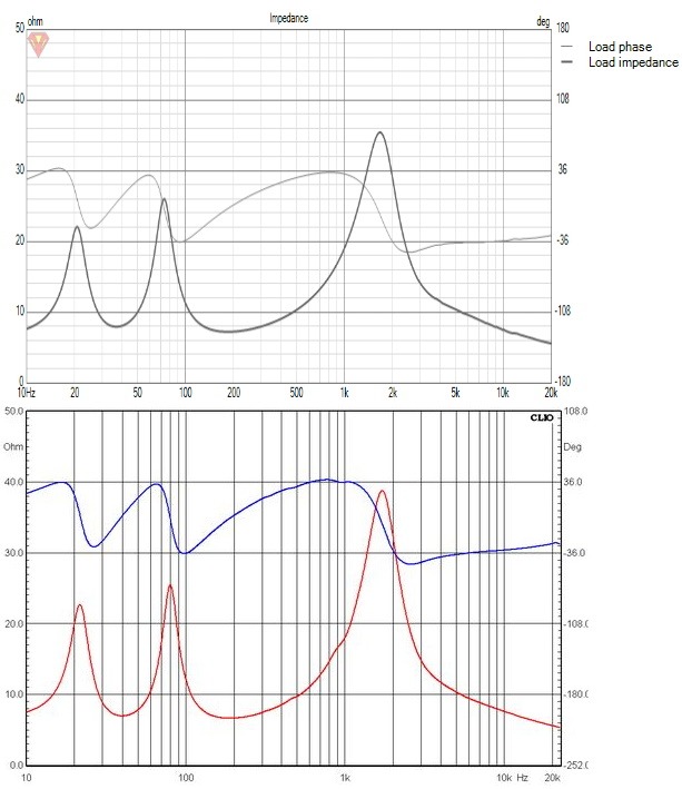

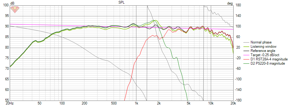

Sim for the Troels Seas 18RLY 24 liter
Quick stretchy doo to see sim vs the posted
data for comparison. Load matches, good
enough to see freq response/filter
and 38 ohm peak at crossover.
So now can see data without weasel merges below 450 Hz
just look at full space and off axis.

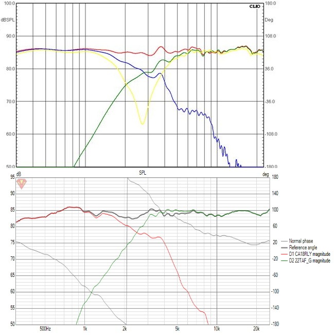

Better match for 8 ohm transformer...smoooth , fixed 40 ohm peak
sealed 24 liters , same baffle.

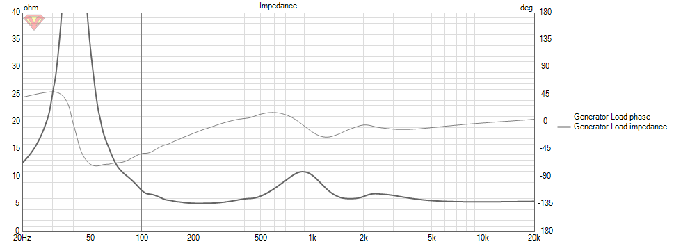

Original Troels Vented 24 liters impedance / load phase
can see the skinny baffle step at 500 / 600 Hz in full space.
possible to pull that out. but sensitivity be down to 82 dB
to actually be flat. Or add second woofer, or wider
baffle , or use typical slight bump on bass knob.

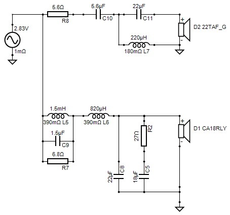

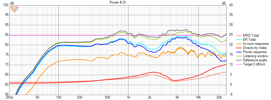

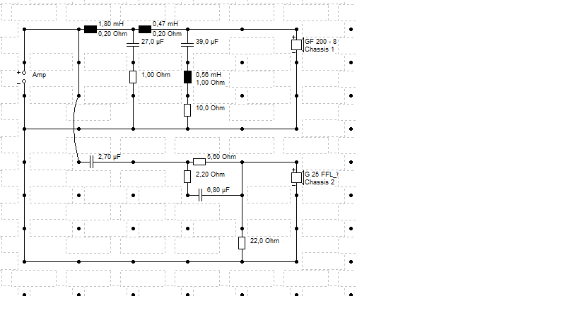

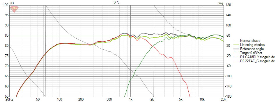

Revised Crossover using same small baffle as Troels above
even with baffle step taken out. The Troels Seas 6.5" technically hits 85 dB
but if the skinny baffle step was fixed better. It is actually be more like
82 dB.
Yours all good 85 dB across . Just need to fix that 65 ohm....peak at crossover.
Make it smooth for tuber and solid state.

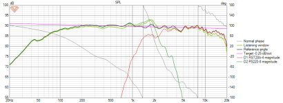

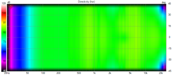

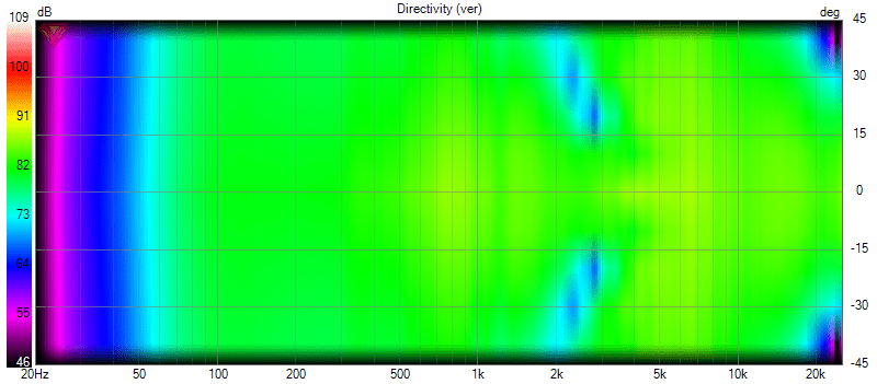

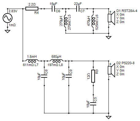

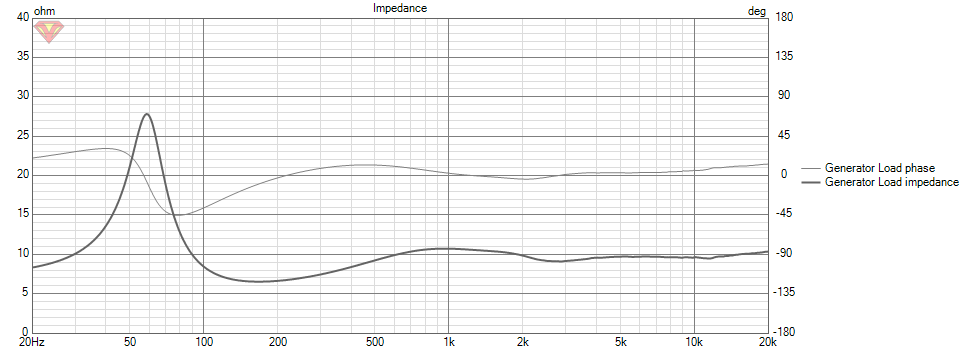

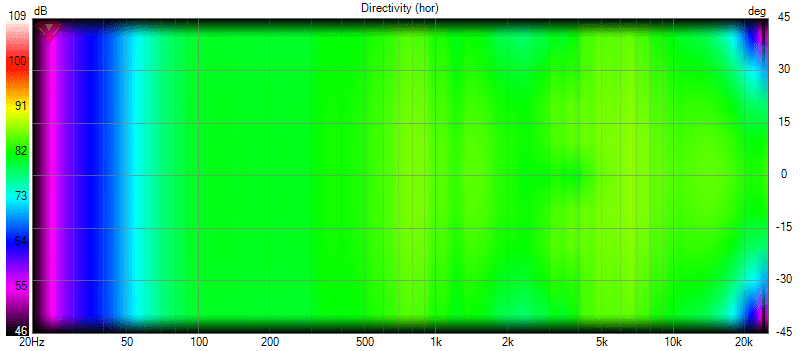

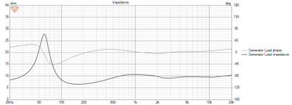

I did quick 8" 2 way with PS220_8 to try and get up to 90 dB
Smooth impedance. Large metal dome no waveguide.
Just large rear cavity tweet for low Fs. To bad no go for
Dayton stuff for OP.
Good way to go 8" 2 way, my sorta thing, Nice, Is actually flat across 85 dB.I fiddled around with an 8" and a 1" in the WG148 waveguide
82 dB.

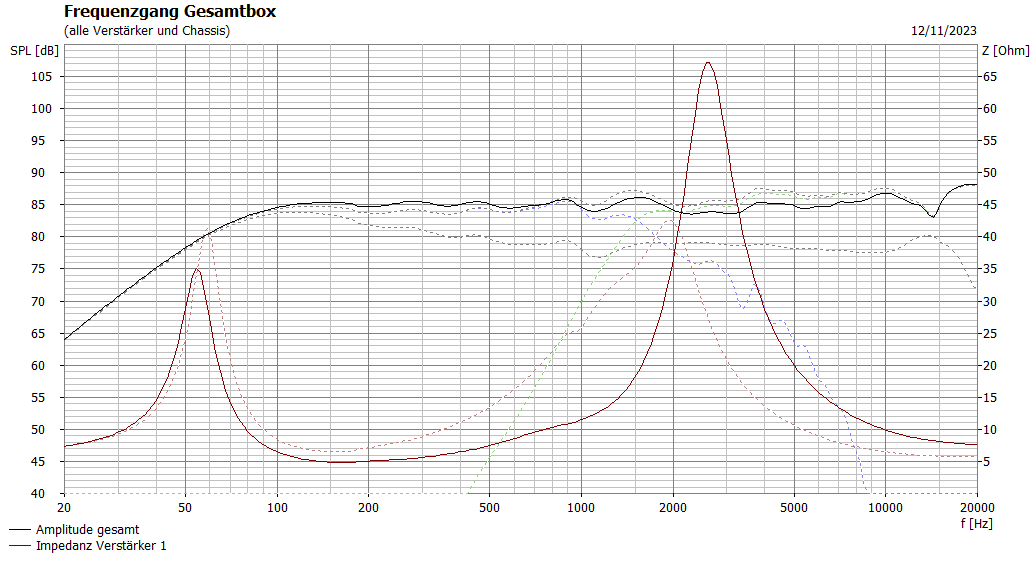

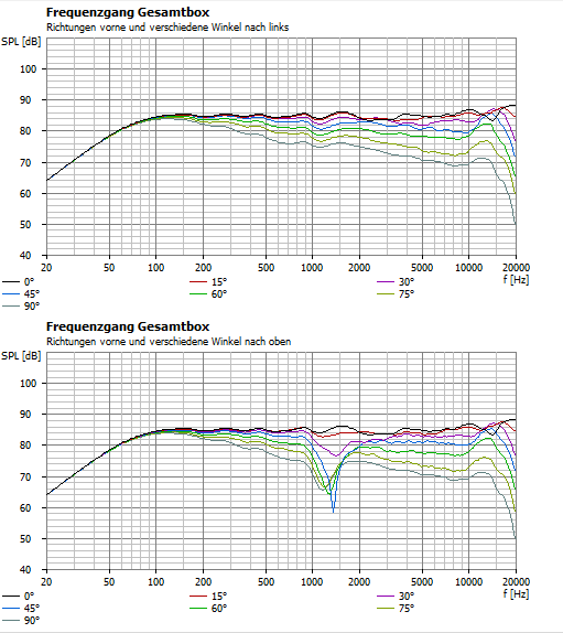

I had a close look at the previous simulations. Not one of them would make Andy happy. They just pronounce the shortcoming of his weak amp with high output impedance. The Visaton simulation has a grave mistake in the tweeter x-over, that will net high distortion (6dB).
