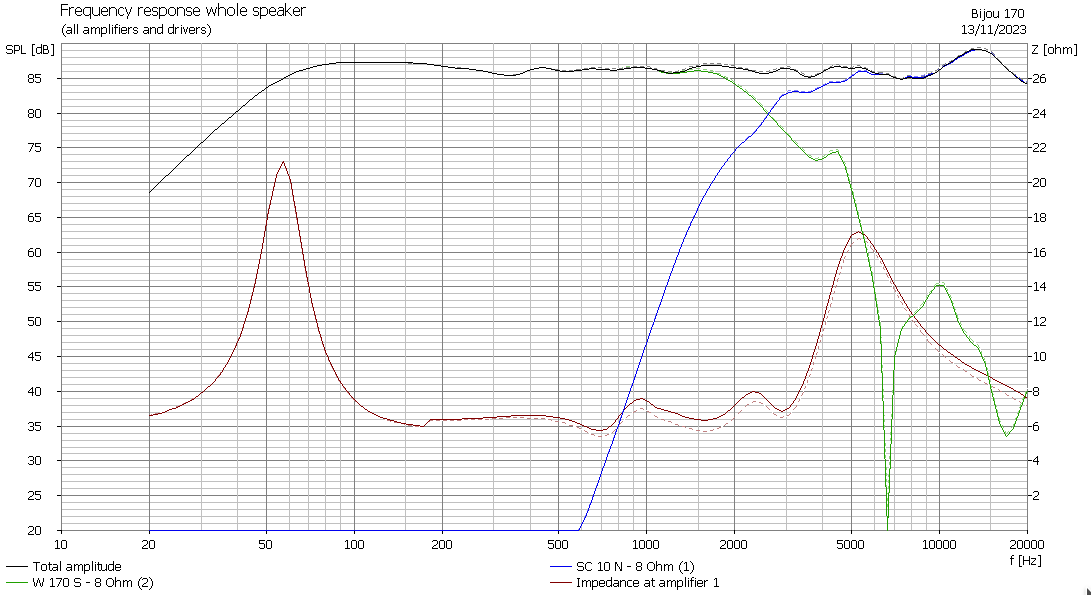

In the Visaton Shop I found another design, the Bijou 170. This actually does have a crossover for the WS170 and SC 10 N fabric tweeter at 3.2K. This could be a viable starting point since in a 20 litre sealed box we get F3 at 50hz, which is the best so far. Maybe the tweeter could be replaced?

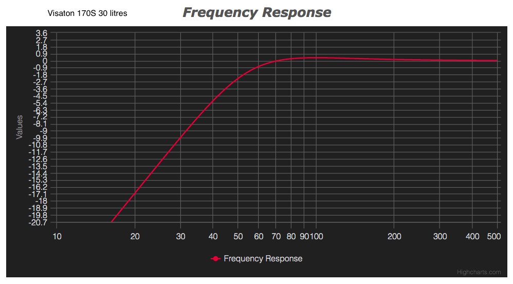

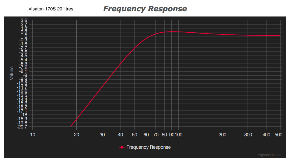

Attached simulations for 20 litre sealed and 30 litres sealed if I add another aluminium piece to the sides. The bass response in 30 litres looks really good - F3 is 47Hz. 30 litres also opens up the box for numerous 8" designs with waveguide.

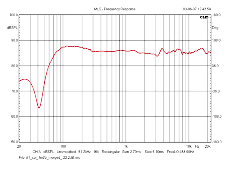

Many thanks for that. The response on your sims falls 5db or so below 1K. Should I be worried about that? The baffle will be wider than the original, though. I don't know what that will achieve. Troel's published frequency response in 16ltr ported is flatter. I'd like to know what's happening here if I'm thinking of using Troels' design.

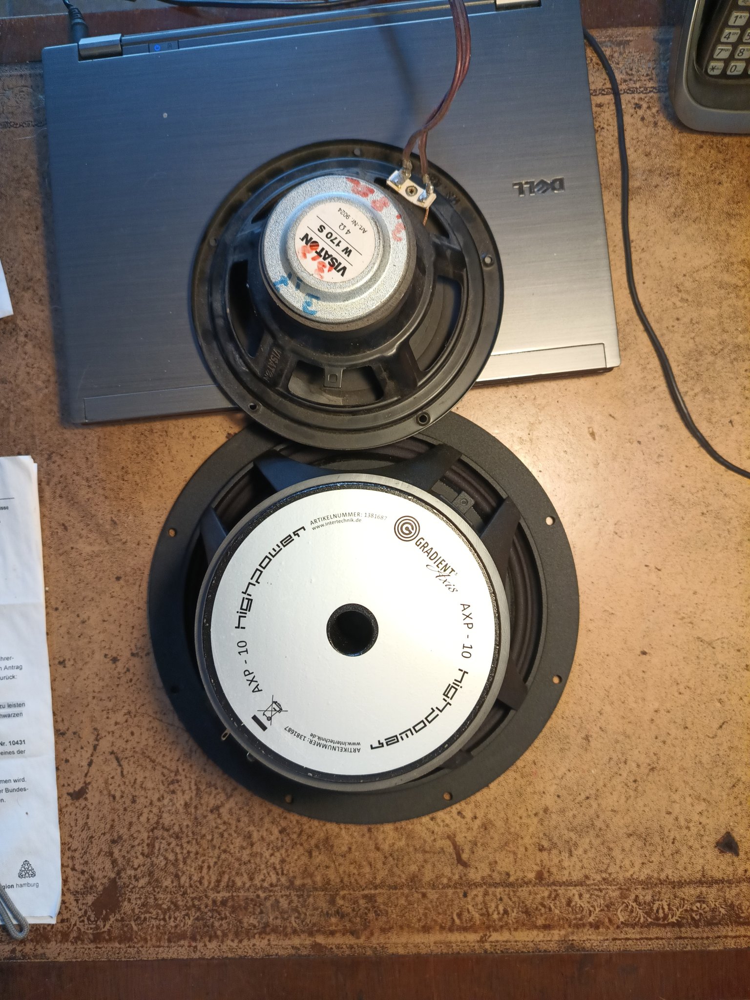

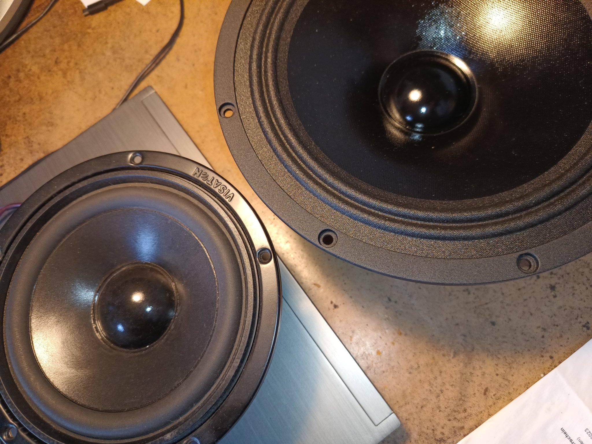

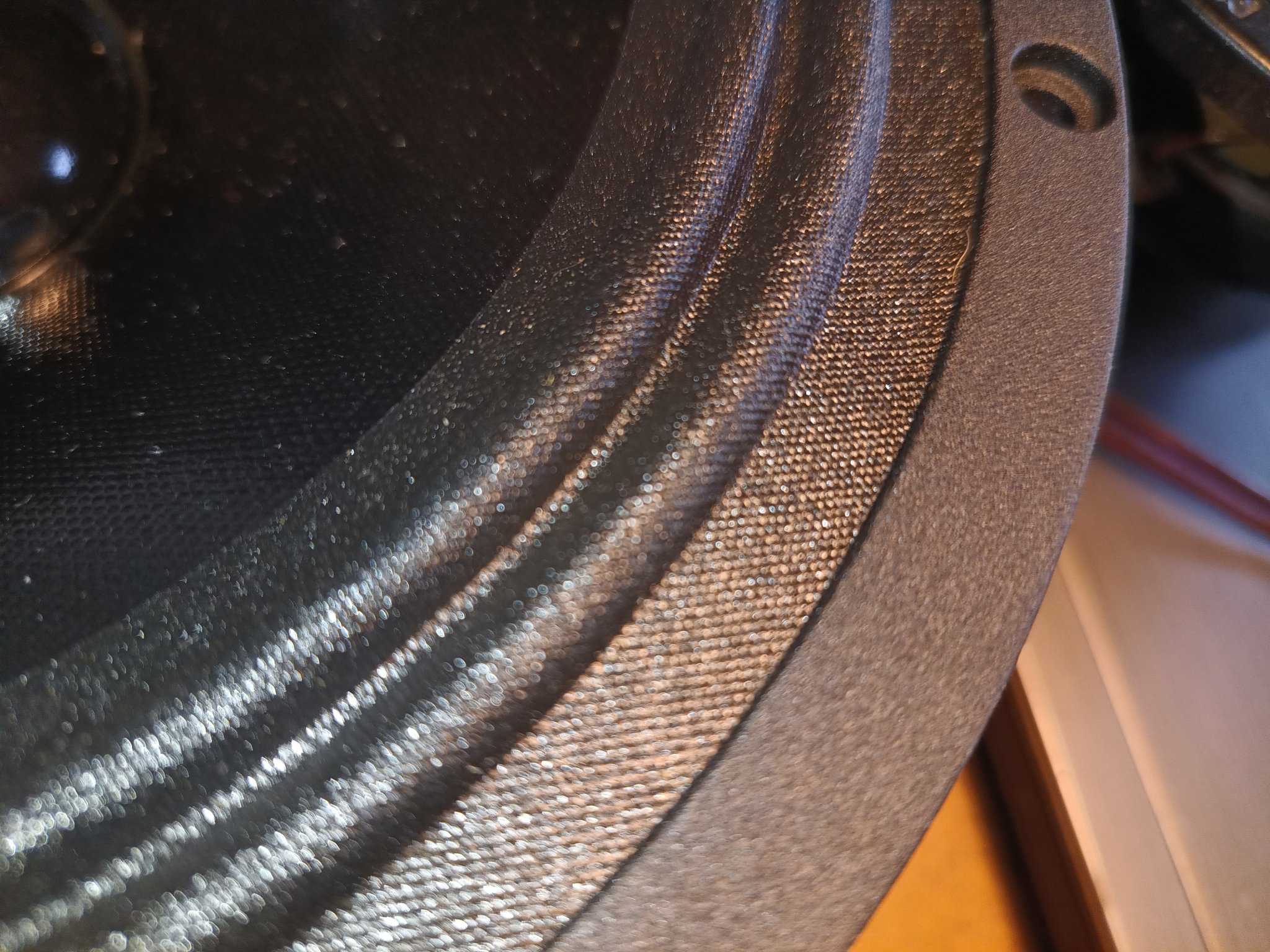

I attach a picture of the Visaton W170S you just mentioned, compare it to another chassis. Membrane suspension and magnet size. Your amp has a lot less work to do on the large speaker and and can play much louder! 86dB compared to 93dB!
This point has been ignored in some parts of this thread. Even when your amp plays loud enough on paper, music is dynamic. While the average may be only a fraction of a watt, some short impulses will need quite some energy. You will not even consider these to be very loud, it just takes more energy to produce them.
So the conclusion: I don't listen loud, so I don't need amp power and can use a low effiency loudspeaker is wrong.
You are a musician, so you will like good recordings, not over compressed main stream chart junk. Jazz music is often very impulsive, an amp running into it's limit sounds just awfull, even at a low level. A 3dB more sensitive speaker will double your headroom.
So, the usual low effiency, compact 6 1/2" plus 1" Hifi speaker will not be right for you.
For example, the MAGICO 1A you mentioned, would be a huge disapontment in your room, with your amp and listening profile. Even a 50W valve amp is no match for it. A typical example of a small speaker that needs a very powerfull A/B or D amp even for low level listening, just to controll the chassis and crossover parts. Think of 250 Watt or an amp build for extreme low output impedance, which usually comes with high Watt numbers. Even if you use only 1,5 W from it, a powerfull amp can make sense.

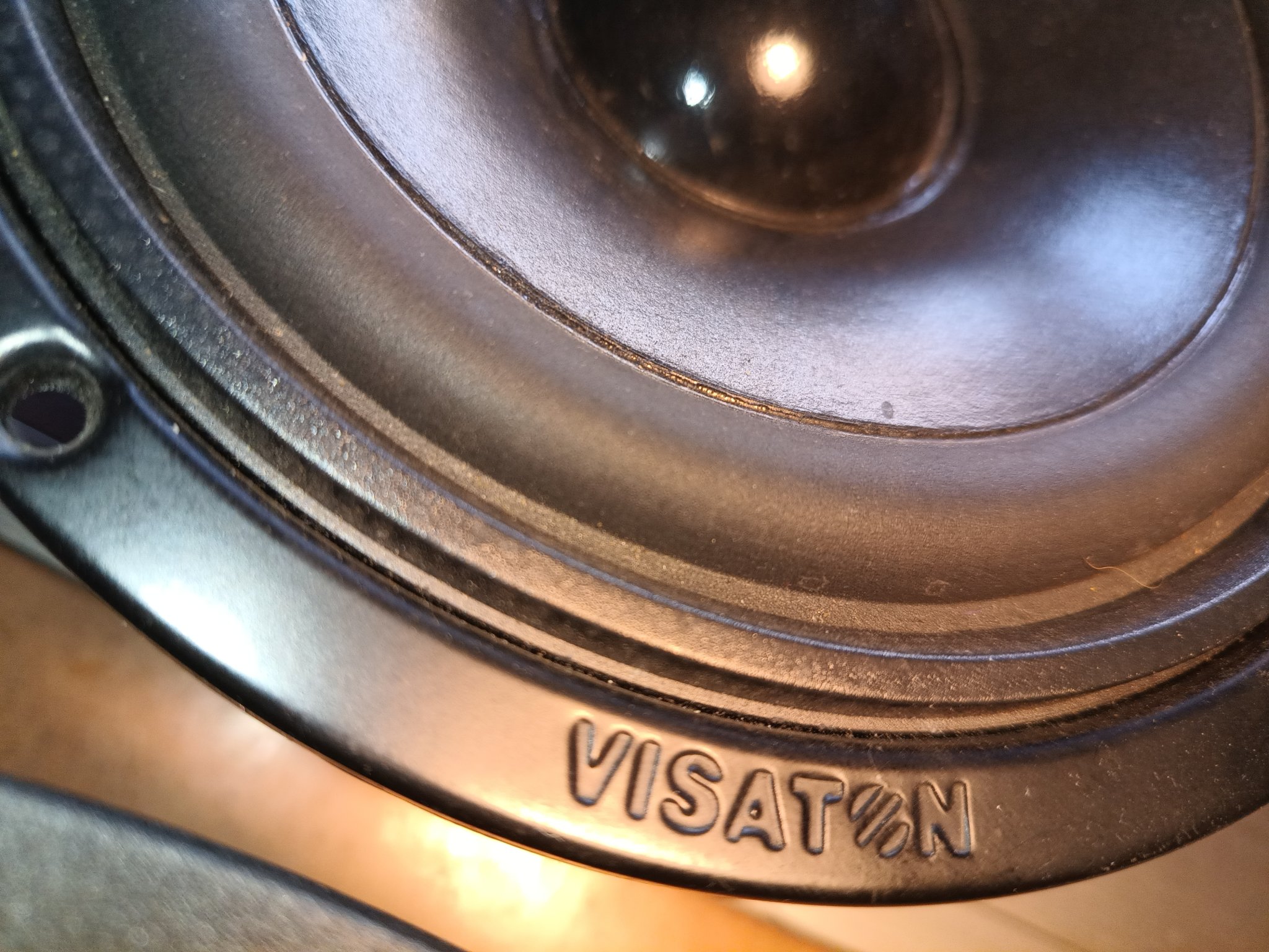

Turbowatch - do you actually have a pair of Visaton 170S and can you comment on any experiences using it? It's coated paper like the CA18RLY but that has a spl of 90db as opposed to 86db. I imagine it sounds better - has anyone used it?
The Seas FR in the datasheet is measured in cabinet so you do not have to apply the baffle step loss.
Simulation vs. TG FR (dashed line) is quite similar.

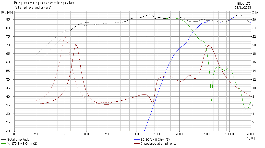

Bijou 170
I think that is an earlier version Bijou 170 Lite. The usual one uses a speaker with an aluminium cone. It was easy to change the cross over of the al one to the W170. This shows the result.
The solid line is with the default 11L sealed box. The dotted line a change to 30L, 20L does the same sort of thing. Looks different to Visaton shots as I use a different scale.

@Andy in fact I have two pairs of the W170S. It is an unspectacular speaker doing nothing really wrong. I used them closed, but with a sub. Two of them where in a closed box of 21 litres, making the sound for TV set. What they are not, is exciting in any way. If you ask me of personal opinion, I find them boring, that is the cause they went on the shelf. They lack the real bass you expect from the size of the cabinet. With a sub, they sound a lot better.

The W170S is missing the special spark that really good speaker produce when playing good music.
Everything done right, but not exiting. Please, this is a personal opinion. Maybe with some extreme tweeter it can do more.
I plan to use it in an MTM for the porch. Closed with 45 liter net, as they will be screwed to the wall. Maybe with a high pass capacitor to push bass a little. Together with an Audax TW025A0, similar to the HD100. Both are speaker designs from the early 90's , the Audax a step higher in class. For intense listening, I would not take them. For back ground, just fine.
They are worth not more than 20€ in my world, for 56€ there are much more exiting chassis around.

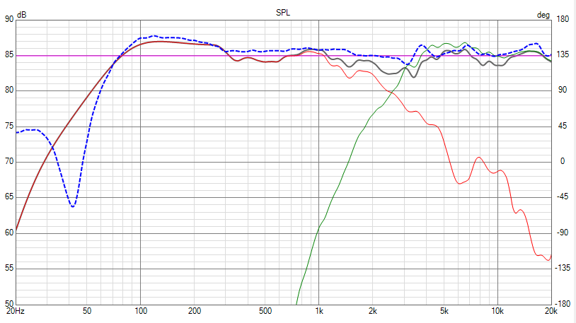

🙁I'm no cross over expert but was curious about what could be done to use the same parts in 20L. This is what came up using boxsim's optimiser with a 20L box. Same crossover circuit, different values.
Tried my best force 8ohms. I decided to model it anechoic. It's possible to set "walls" left , right, above, and below. This reduced the bass level however a separate plot indicates that use in a 1/2 room restores it. Tricky - 😉 need to build a design to see what happens. I doubt if any modelling system can predict what will happen in any room I happen to use a speaker in, The above is also using raw values rather than standard parts. Changing to E12 capacitors seldom causes significant problems - inductors can be a different matter.
