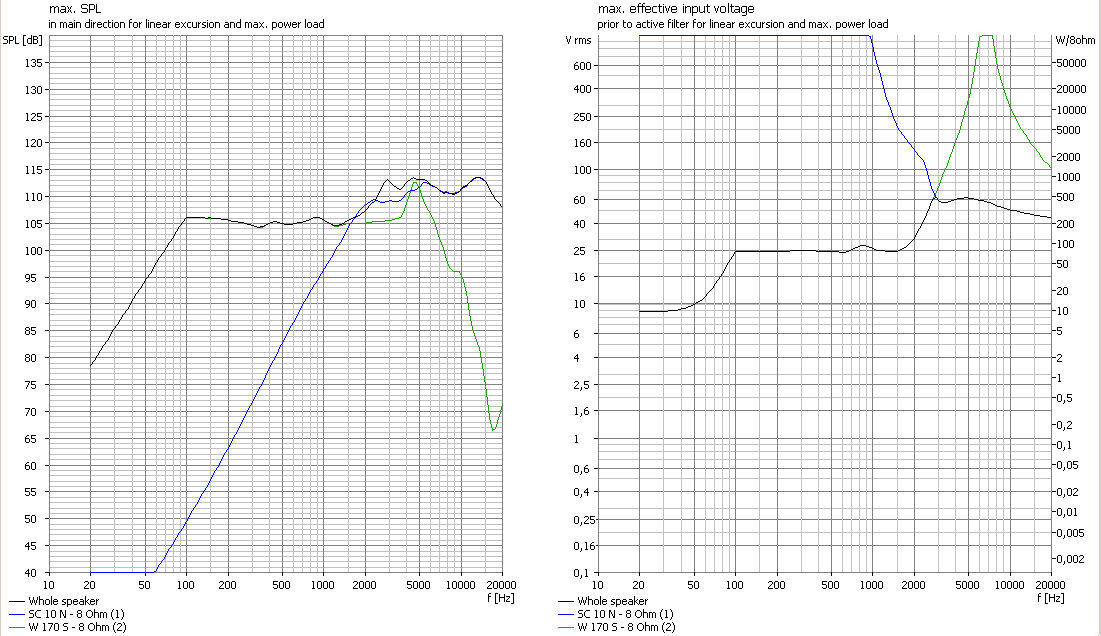

It's confusing. Boxsim comes with a Bijou version as a default projectDo you have the crossover for the Bijou 170 alu cone? It's not on the Visaton shop site. Or were you using the Bijou Lite crossover?
The alu cone version is shown in the shop but uses a far more expensive tweet. It's Fs is compensate and it can be used over a wider than usual F range. The SC10n is a cheapo designed to work in the low tweeter range. Some need a higher cross over F, more suited to 3 way.

The 170s appears to be the first one that crops up that is very likely to be ok crossing over at 2 to 3K
They also do cheaper 170's. All come with data. Boxsim is rather picky about how the data is measured.
Some people suggest a different route to designing a speaker. Buy the chassis and measure them and use these figures for the design as the makers data "may" be unreliable. Some do them in free air yet they will end up in a box. Some are designed for vented.

It has a very long cone throw to achieve that. Linear excursion 4.25mm per side, 95dB at 50Hz.
