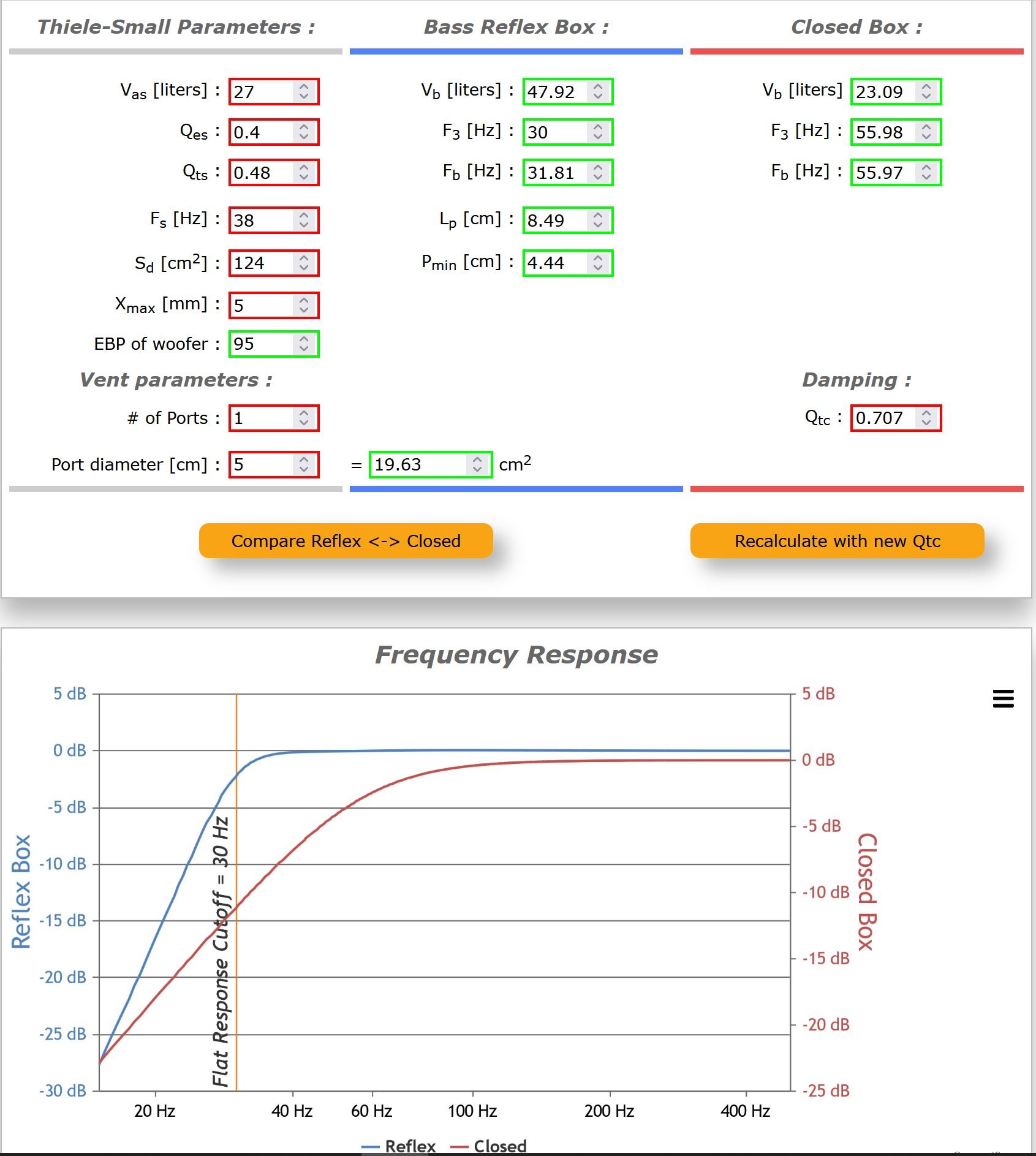

Your initial concern was 20 liters to big.
and no, 20 to 28 liters is about ideal. Will get nice Q
sealed for many 6.5" drivers that are mechanically designed
for sealed.
28 liters works fine, makes slightly wider baffle
no problem. And overall size could be very
similar to the mission 761 form factor.

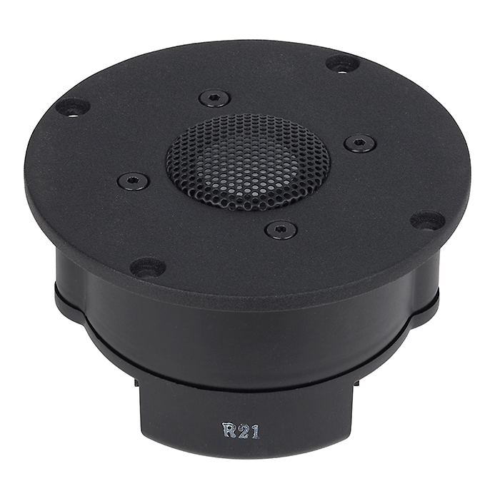

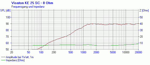

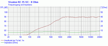

Visaton makes very clean clean ceramic coated
tweeter. Rivals clarity of many metal domes.
and very flat response.
KE 25 SC
Easy as that W170S woofer KE25 tweet.

Sealed is accurate and easy.
With right woofer, even tube amps love sealed.
No fart tube roller coaster impedance curve.
With right woofer, impedance peak wont be obnoxious
30 to 40 ohm peak.
Be normal 20 to 25 ohms peak.
all sealed and accurate.
tube amp love it, any solid state drive it
no problem.
not rocket surgery, just 2 way.
2 wires from amp. turn on, adjust volume
all done

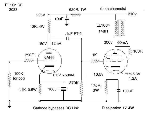

I'd estimate my amp as being 5W per channel max. Schematic attached. I must emphasise that I don't listen loud, my room is 4.5 x 3.5 metres and I have nice people downstairs. So going with stand mount so I'm free to play music any time of day and it won't go through the floor. I'm a double bass player and what is important to me is a natural and realistic tone to the double bass. I seem to be getting that better with a sealed box - it sounds more like a real double bass to my ears, minus a few notes at the bottom being softer. I listen to a lot of jazz, being mostly a jazz musician myself.
Thanks for the thumbs up, WhiteDragon. I'm Welsh so my dragon is red!
2x 5 Watt is more than uncomfortable under normal conditions, "normal" listening happens with a few milliwatt.
The problem is to keep the moving mass under control. Best for you would be a horn speaker 😉
Totally agree. My amps are massively overpowered. Even when playing loud, power to the speakers rarely exceeds 5W and mostly much less even with LT EQ.

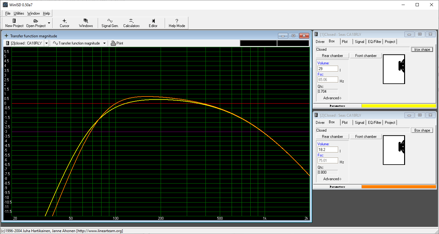

If your confident with the Seas CA18RLY and 22TAFG
cast frame woofer and metal dome nothing to sneeze at.
Straight forward Hifi
The sensitivity slighter better and seems to be expected performance
in sealed box.
Qtc for .7 to .8 is 19 to 29 liters
So troels compact box is hitting around .8 Qtc at 19 liters
box from 19 to 29 liters is good.
pretty normal for decent driver.
Volume has good range of tolerance.
For what people consider ideal or flat
.707 Qtc is 29 liters.
Troels has right approach as mentioned
steep filter 3rd order for tweeter.
And also as mentioned placement is tight and close
as possible to woofer.
Has classic case of garbage 40 ohm peak at crossover point.
Can be fixed to be better match for transformer coupled amp.
All in all 6.5" sealed driver can expect sensitivity to be about this
range. Just dont want box too small / too boomy/bloomy
Keep Qtc .7 to .8
And as noted shoot for clarity / performance with money tossed
at clean metal or ceramic dome for clarity / detail.
once we have baffle size, crossover easily optimized.
in sealed box.
Keep Qtc .7 to .8
