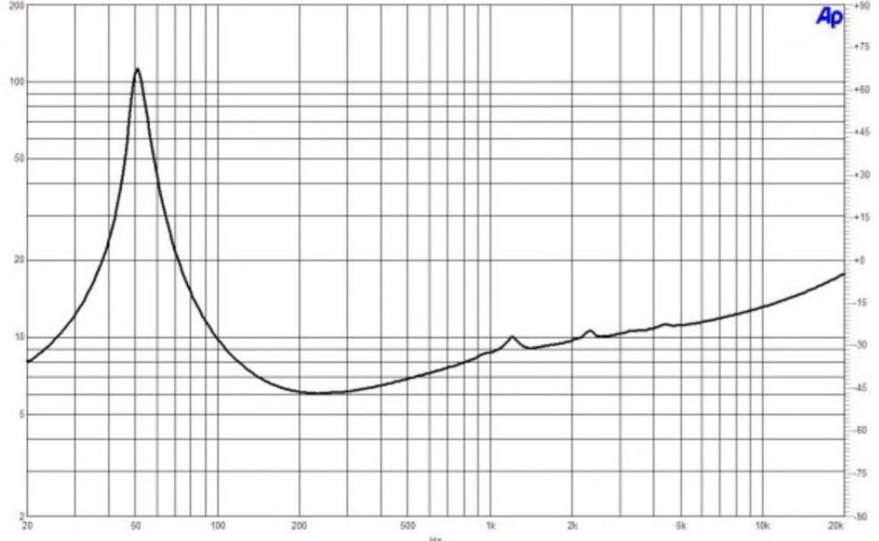

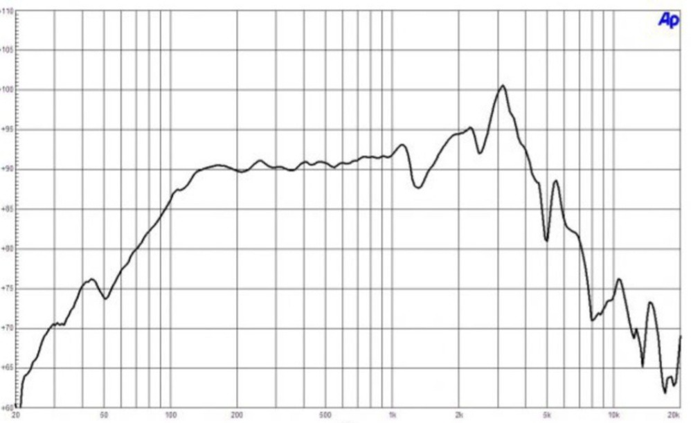

This is very similar FR to most of the examples of 8NDL51s I see (copied from the web). The peak at 3.5k isn't typically as pronounced as in this graph and it diminishes a bit with a flush mounted driver. You won't really notice it when coupling it with a tweeter even first order around 2.5k. 2nd order will for sure suppress it more than enough to be buried enough. Without the series inductor on the woofer, you can tell it has a slight rising response curve with a peak at the end. There are however no other real peaks after that point, which is why you can get away with the single larger inductor. The BSC is factored into this already.

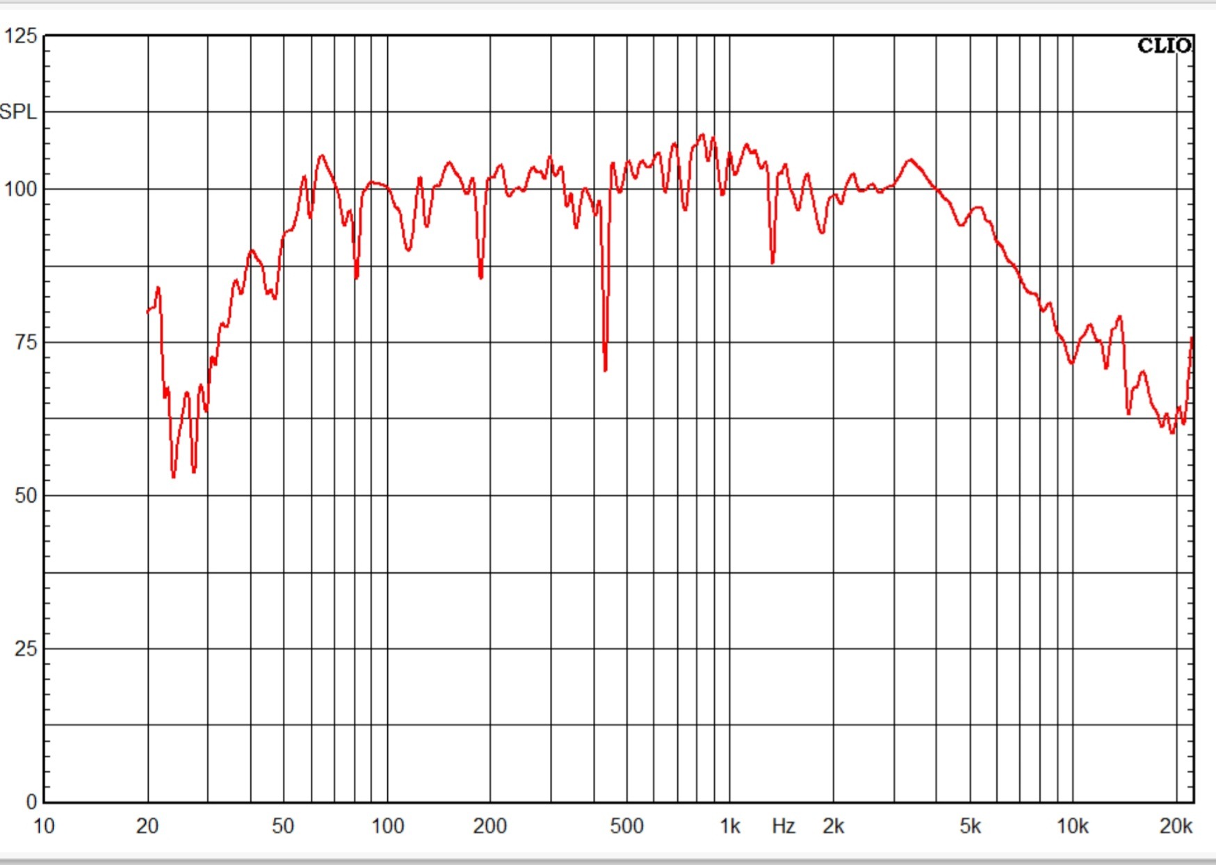

@PKAudio The 8BG51 has a pretty bad surround reflection at 1k. You can see it in the impedance plot pretty well. Not a suitable driver for a 2 way. Big rubber surrounds aren't good for midrange linearity. Very rarely do I ever see a decent midbass with a traditional rubber surround. Purifi does some tricky thing with the shapes of their surrounds to combat this, but they charge alot of money for their stuff.

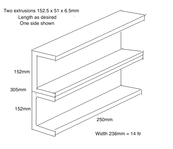

You are all welcome to call me "Andy" rather than "thread starter". Don't worry - this will be built. I have the aluminium pieces ready and then need the wood pieces cut to size for top, bottom, front and back. The first build will be with the units and crossover out of one of my pairs of Mission 761. That is a Vifa 6.5" and D19 tweeter. The 761 is a sealed design, so I'm just making the cabinet bigger. This thread, which has been extremely useful and full of good things, is for a "better build". There are good designs for CA18RLY (Troels), SB17MFC (Bagby) and SB17NRX (Troels etc), so that's the current shortlist.
I'm keeping an eye open for a build using an 8" mid-bass also, so not ruling that out, though that might be ported design. I'm getting a clear idea that the experienced builders here demand better/lower bass. If I need to I can add another aluminium piece to the sides giving me 30 litres. The top and bottom would stay the same, just would need taller front and back panels.
