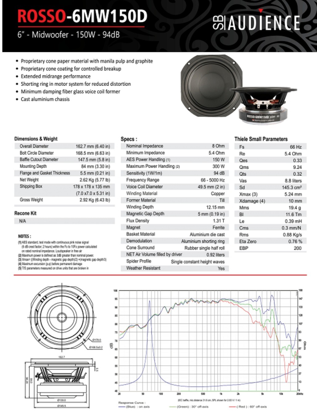

Thinking outside the box, there is also the SB Acoustics 6MW150D, which I really like alot. It also doesn't go quite as low as the other 6s, but the sensitivity is high, around 94 dB / 2.83V. Its VC is a whopper at 54mm, which isn't common for a 6 inch driver with rubber surround. It also has a vented fiberglass VC former, which IMO is the best material for stiffness, weight and damping.

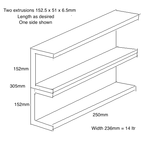

This all started as an experiment in building aluminium enclosures. Aluminium because I always liked the clean sound of the Piega speakers I heard. And also because I have very little space in my city apartment. Very small workshop and small kitchen. So I usually build tube amplifiers. I have all the carpentry tools and skills but not the space to use them. So the enclosures are half aluminium, and since aluminium is expensive there are limits to how big I can go. I'm very curious about aluminium enclosures - this is an itch I need to scratch.

I don't Iike all SS drivers, but the paper and slit cone drivers with foam surrounds are very nice, high resolution pieces. The motors are very good. For the money, I usually favor the B&C and Eminence drivers for higher sensitivity stuff. There are a few other hidden gems from PRV, Beyma, SB and Celestion as well. That SB 6MW150D is a bargain. Its a pretty fancy driver for $90.

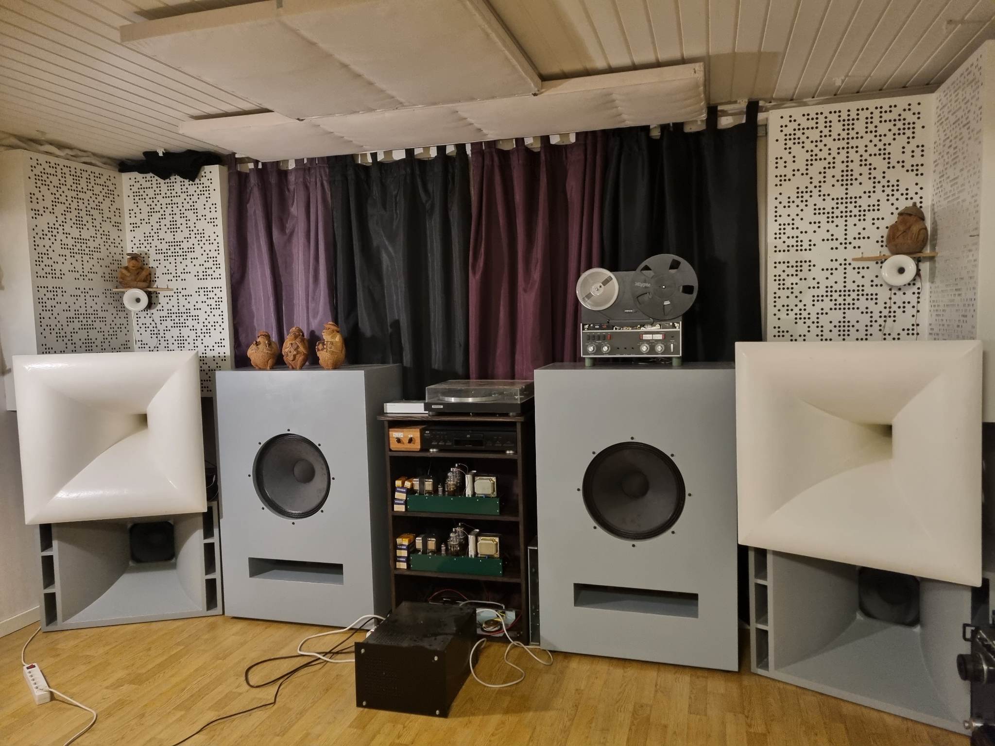

Funny, I searched online for Fane Sovereign Pro 8-225 less than an hour ago. It's not me that is looking for driver recommendations here but this thread is having a bad influence on me: I already have two big systems in my small house, the one in post 48 and another in the next room with corner bass horns, direct radiating JBL 2202H 12" midbass/mids in small ported cabs and LeCleach horns from 1200Hz and up.
Good systems both of them if I may say so myself, but I'm contemplating the possibility to add a third system somewhere in the house. Something very mimimalistic, like a pair of 6,5-8" fullrange drivers driven by a small SET and with only analog sources.
Opposites attract, and I guess this would be the opposite of the multi-amped 4-way system in my hobby room.
