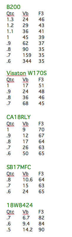

I think I'm starting to understand this in a basic way. So if I decide on 20 litres for the sealed enclosure, the best choices in theory would be something like the SEAS CA18RLY or SB17MFC. Both would give a F3 of around 64Hz. The Visaton W170S would give a F3 of around 50Hz, but the penalty would be a Qtc of around 1. The B200 looks impossible in 20 litres, though Kef put it in sealed enclosures way smaller than ideal.

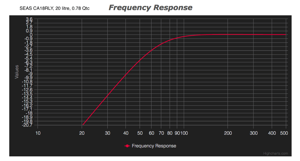

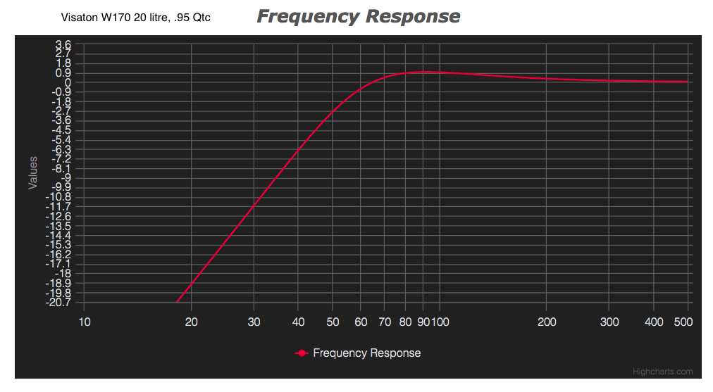

F3 of 64 Hz is not great. I'd take another look at the ScanSpeak that was recommended in one of the first replies. It had an F3 of 55. I built a smaller ScanSpeak based sealed two way a year ago that is the best small speaker I've ever owned. Accurate, clean dynamic. It's called the Ergo IX. And F3 around 53 but it took a year to break in! Something worth looking at. https://pinkfishmedia.net/forum/thr...-e-ix-mini-monitor-loudspeaker-system.112821/

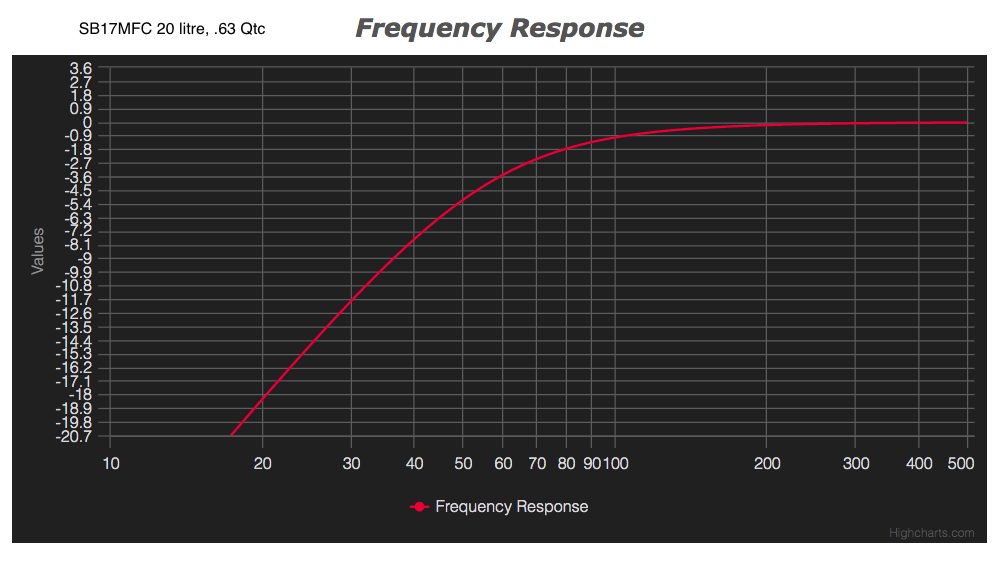

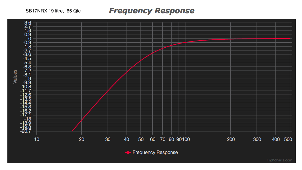

I'm going to build a sealed 20 litre cabinet with removable front and back to try out different speaker combinations in a 2-way. Here's the roll-off graphs for 20 litres. Looks to me like the CA18RLY is best, though the Visaton has more bass. Since my room is 4.5 x 3.5 metres I'd expect some bass boost which might be troublesome for the Visaton. All these four have crossover designs available.
Scan Speak 18W/8535-01 works well in closed box. I listened to 2way with ScanSpeak 9700. It is not easy to make the crossover for it though.

Turbowatch2 - thanks for your post, but you may not have been following the argument very closely. Of course I need a crossover design to build my speakers, and the mid-bass units I have put on my shortlist all have crossover designs available, in some cases more than one. That's why they are on the list. So there's no need to re-state the obvious, and I'd add that I have built a few pairs of speakers in the past so I'm not a beginner. But yes, I'm still in the process of understanding all the technical aspects of speaker design. I'm a quick learner, though, and as a past academic I'm good at research. So I'm not after some kind of "beginner's kit". I can construct a crossover quite easily from a published design and I have a lot of parts in stock. I build valve amplifiers so I have a well equipped workshop. So I just need the units and the crossover design.
Before I went deeper into this, I got the impression that the B200 might work in a 20 litre sealed box, but although I have a pair I'm not expecting much out of them, so I'm concentrating on 6.5" to 7" units. That's what I have already in my Mission 761 sealed speakers, which I like. So what I'm doing is upgrading to a larger and better box (thick aluminium frame) and looking at a wider choice of mid-bass units with existing crossovers. I hope that clarifies things for you.

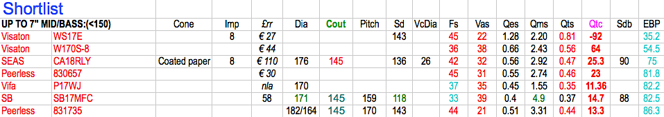

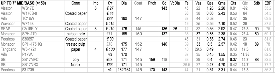

I think this is where the confusion may be coming from. The way you talk about 'crossover designs' makes it sound like they are specific to the midwoofer only, and portable between systems. What I believe turbowatch is saying, is that a well-designed crossover (even just the woofer section) is specific to the woofer+tweeter+baffle layout+listening distance system, not just the woofer. It is designed by measurement and modeling of that system, not by lifting a highpass/lowpass schematic from another application of the same driver.
The other thing is that there are ways to modify the qtc of a woofer+sealed box with the crossover. So if your modeling does not include the filter, you may find the total crossover+woofer+box response to be different. This also would extend to the past systems you may have heard, in which the crossover may have changed the response from what the 'naked' woofer in that box would have produced. You can see here:
