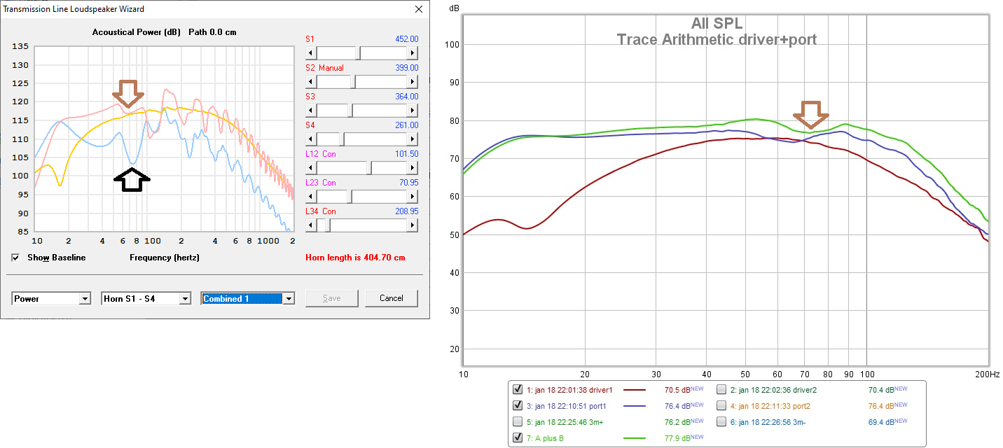

To be more specific, I'm referring to REW's "Trace Arithmetic" feature to combine the response of the vent and the response of the driver, as illustrated in the example below.
Hey Brian, thanks a lot! Found it.

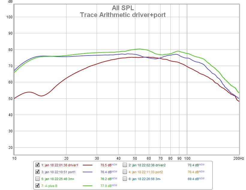

Look at this graph. I combined the SPL of the driver and the port.
And I put is in comparison with HR also.
Hey Brian, how do I adjust the vents response?Note that you'll have to adjust the level of the vent's response before doing the combination, based on the difference in surface area between the vent and the driver.
In my example's case, the driver and PR have the same Sd, so no level adjustment was required before combination of the two response curves.
Hey Booger, look at this picture. Is this what you mean?
The design and the measurement next to each other.
In Hornresp the first big dip is at around 75 Hz. In the measurement it is around 65 Hz. In my opinion the shape is 'confirmed', but shifted to a little lower frequency. Mention the same shift at very lows. The vent extends to 13 Hz instead of 17 Hz.

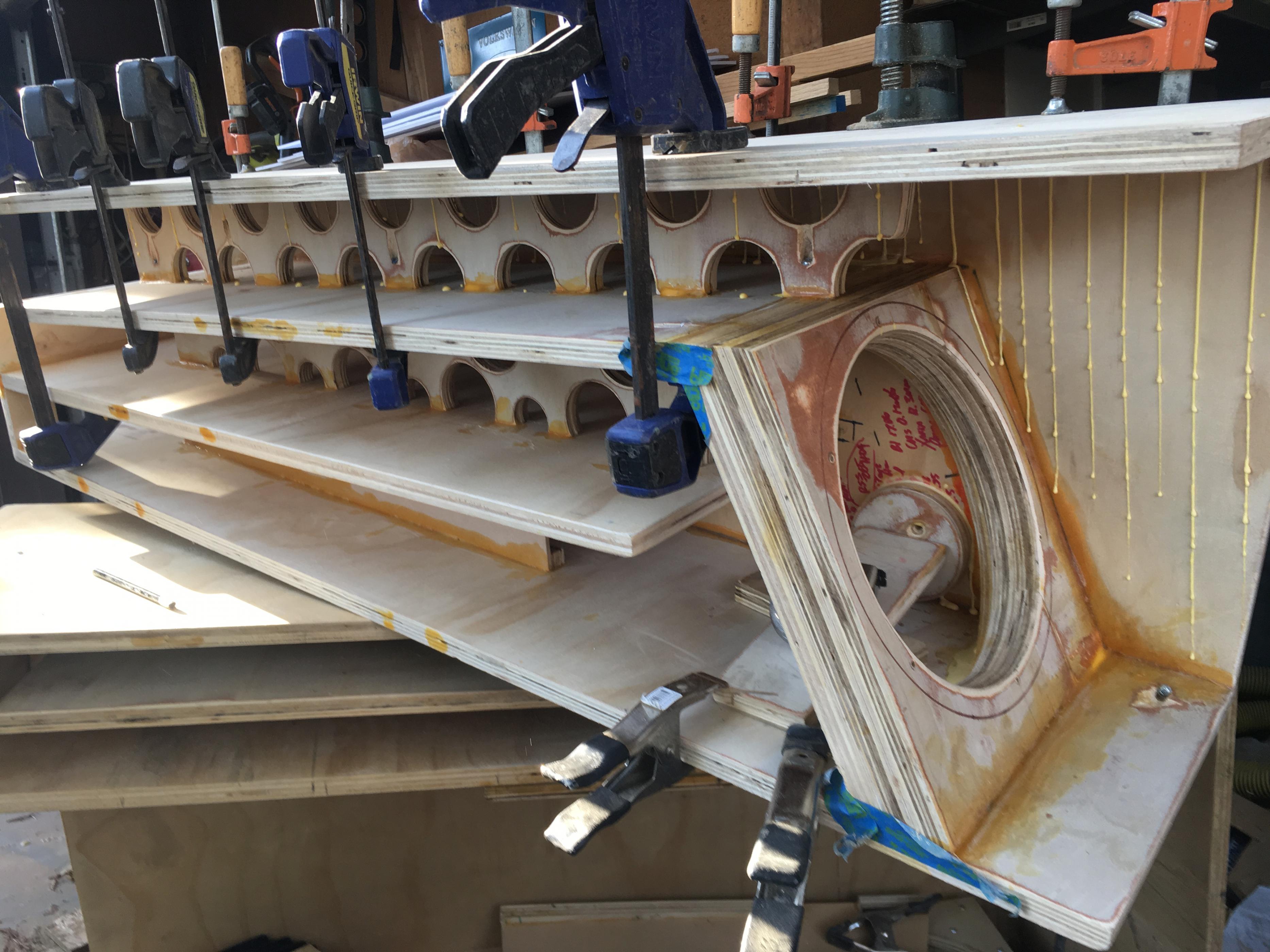

Yeah, looks like you found it. kinda fun to see what you created. i just about finished up a dayton rss 265ho4 sub in ~300 cm as 2 folds(3segments) and a couple goofy bolton ‘chambers to mess with that nulled spot
Can we follow that build somewhere?

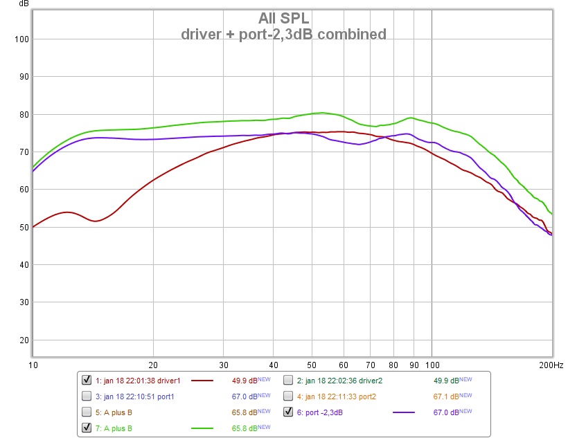

Adjustment = 20 log(Sp/Sd)
Example, if Sp (the cross-sectional area of the vent) is half that of the driver, the nearfield response of the vent needs to be reduced by 6dB in comparison to the nearfield response of the driver.
I dont think i could do a build thread without changing my mind and switching so many things around and altering silly little insignificants around justto daydream long enough to conjure up the next half baked version of theres never ever enough of these or the ways to tweak and twist the same basic air mass and driver in idea and almost guarantee thanks to all of ’better than any store bought that the DiY community and Mr McBean have grabbed

Thanx Brian!Adjustment = 20 log(Sp/Sd)
In my case:
20*log(261/342) = -2,3 dB
Here is my new plot.
That is a nice project Booger. Would still like to follow, and you mind changes tooI dont think i could do a build thread without changing my mind and switching so many things around and altering silly little insignificants around justto daydream long enough to conjure up the next half baked version of theres never ever enough of these or the ways to tweak and twist the same basic air mass and driver in idea and almost guarantee thanks to all of ’better than any store bought that the DiY community and Mr McBean have grabbed

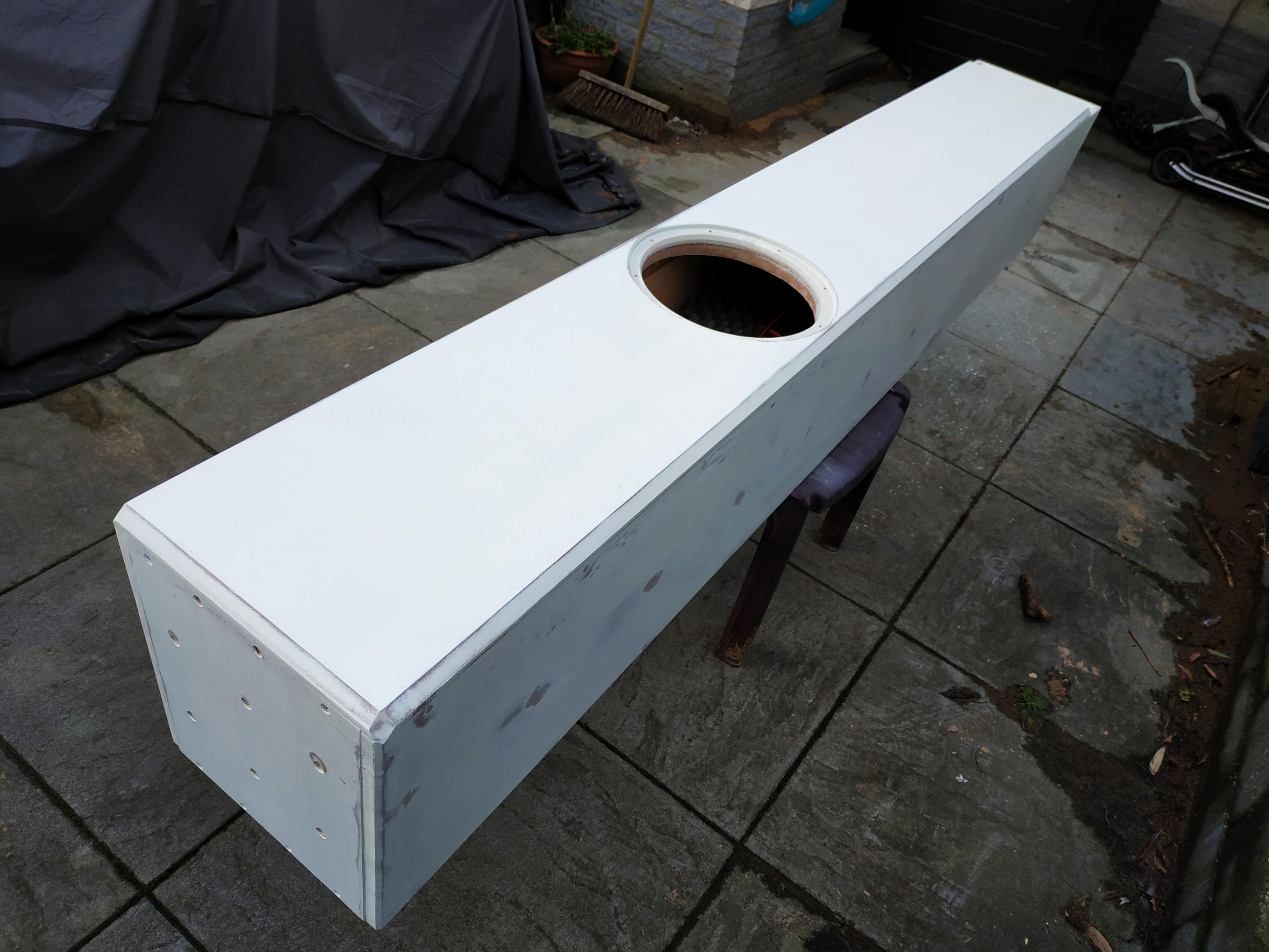

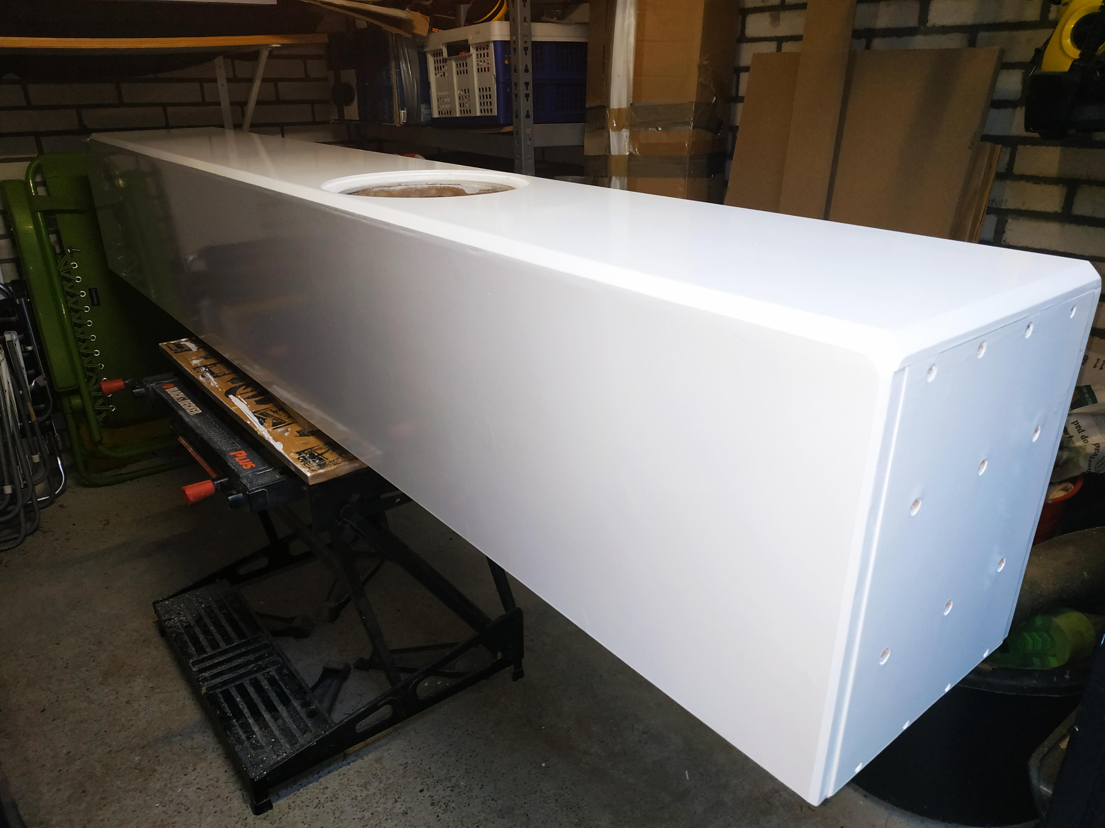

Yesterday I finally found some time for a last sanding job. Sanded with 120, 180 and 240 paper.
Unfortunately I can't paint inside - I have a 15mo running around - so I tried it in my shed. It barely fits in, but got the job done. Now wait couple of days due to low temperature. I miss him already

Bet you miss it, build looks great. Would love to build something similar to yours, but wife wouldn't allow it! Haha.

Wow, that looks really good! 45degree chamfer with the router all those edges or the panel was cut prior to assembly?

Big cuts in the shop done. The chamfer is the biggest I could make with my router.

One final bit of advice - using 10 dB steps in a frequency response plot tends to make it look smoother and flatter than it really is. Adjust the plot range in REW so the steps are 5dB as per attached example..
