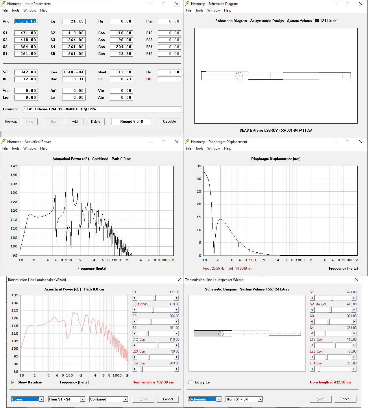

First try in Hornresp with a Seas 10" on 125 Watts:

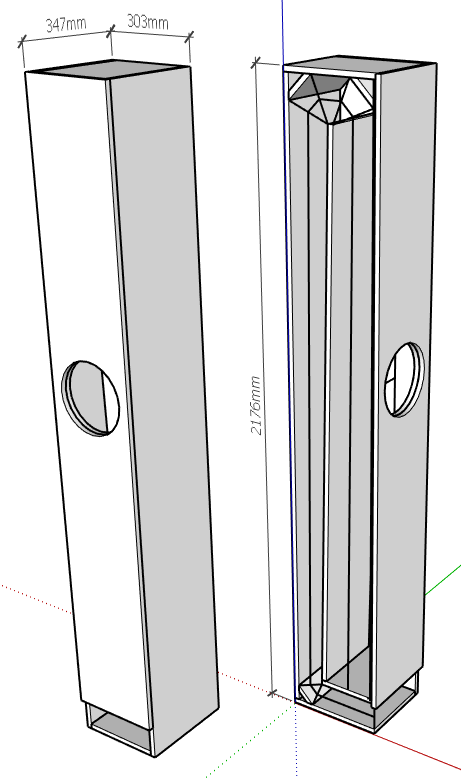

Luckily I had some time today and was able to buy MDF (with some cuts) before the shops closed. Too bad the 22 mm was sold out, but I think 18 mm is fine too. The front side will have an double layer to add some stiffness to mount the driver.
My design was not final, but I think this will work fine.
attachment.php
It is going to be huge :D
2,17 m tall. The TL length is 4,32 m. Looking forward to feel the 15 Hz.

1st impression is that the line is too long and the cross-section not large enuff.
One starts with a set of candidate drivers, and then model the line. Since you have not used in damping in the model, the response is somewhat harde rto interpret, but the way the response roll-off tends to back up my initial impression.
dave
Hey Dave, thanks for helping me.
I played a while with HR. Lots of variation in length, cross-section and taper too. This is simply the best result I got. I also figured out that a wider pipe increases the displacement, without any advantages in range or SPL.
I tried both drivers in this TL (and in fact some other drivers too). Not much of a difference in result.
In fact I did add damping and tried many configurations. Best result in HR is to just fill the bottom.
Needs a ‘path’ length equivalent to the offset driver location essentially. 100 cm will be an entirely different harmonic landscape from 60 hz on up:D
Hey Booger, I played width the offset too. It is around 1/4 of the TL. It just gave me best results.
I am not worried about the landscape above 60 Hz. It feels like a fine Xover point with my main speakers. And if not: than that will be my next project :D

‘Path’ as in direct radiator’ vs vent center to center. extends the acoustic length traveled between the two to reveal the actual sound at 1meter if split as an isosceles triangle so to speak.
‘Acoustical power’
Tools
‘Ouput’
Combined
‘Path’ ~110cm, not 0.0 cm youll see :)
