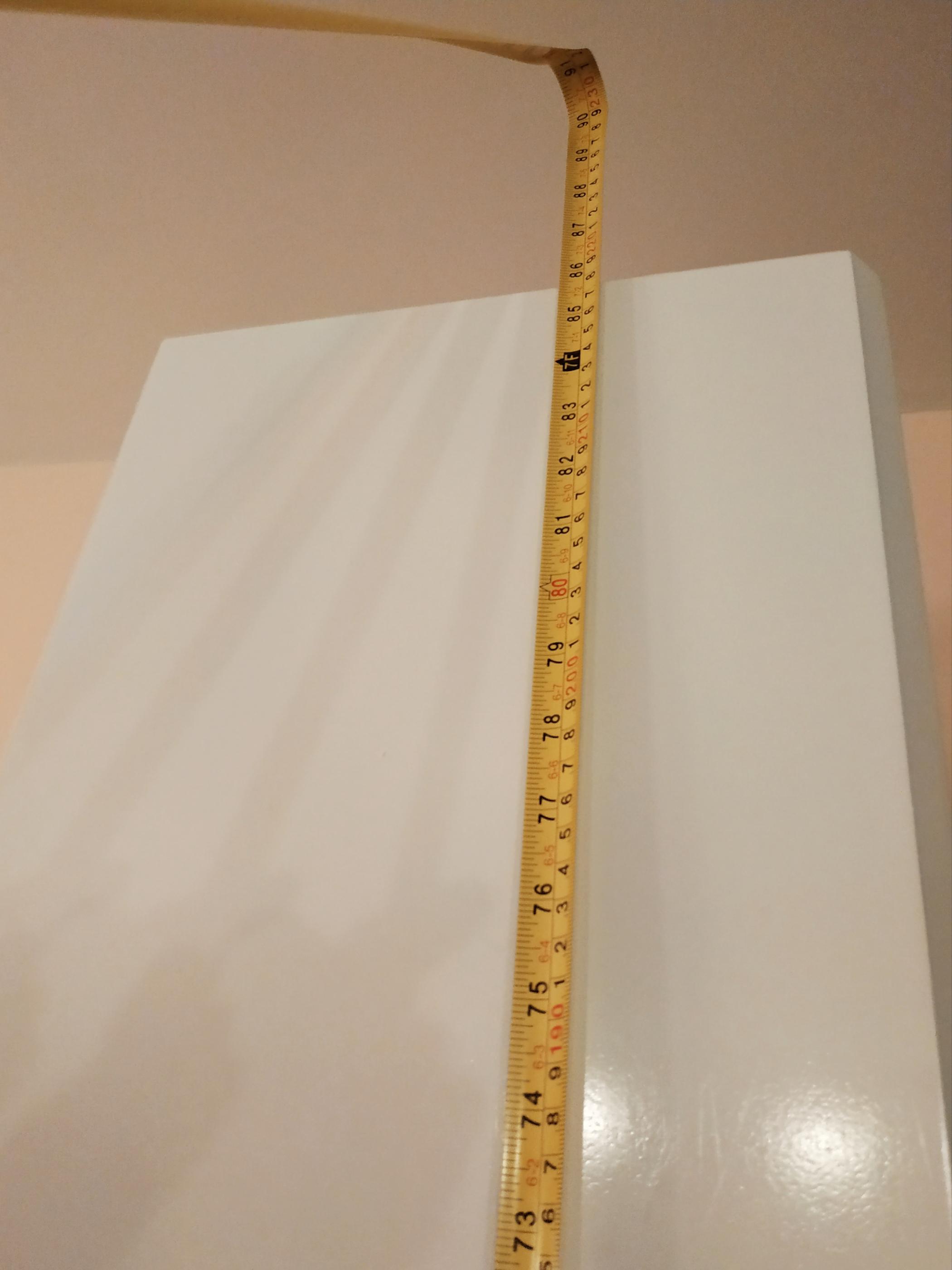

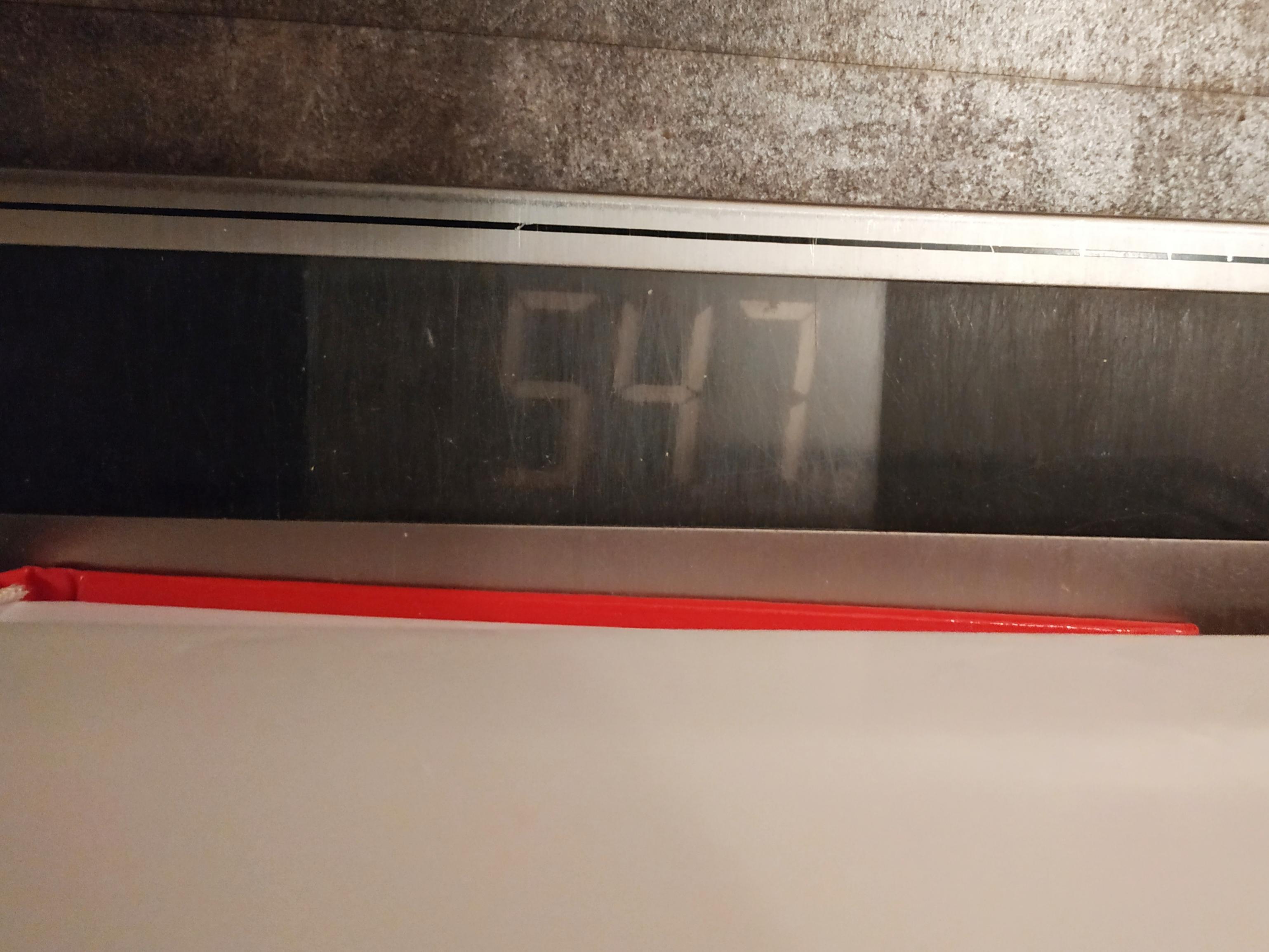

54,7 kg and 218 cm tall.
Paint is finally dry.
Put some adjustable feet under it to set it straight up.

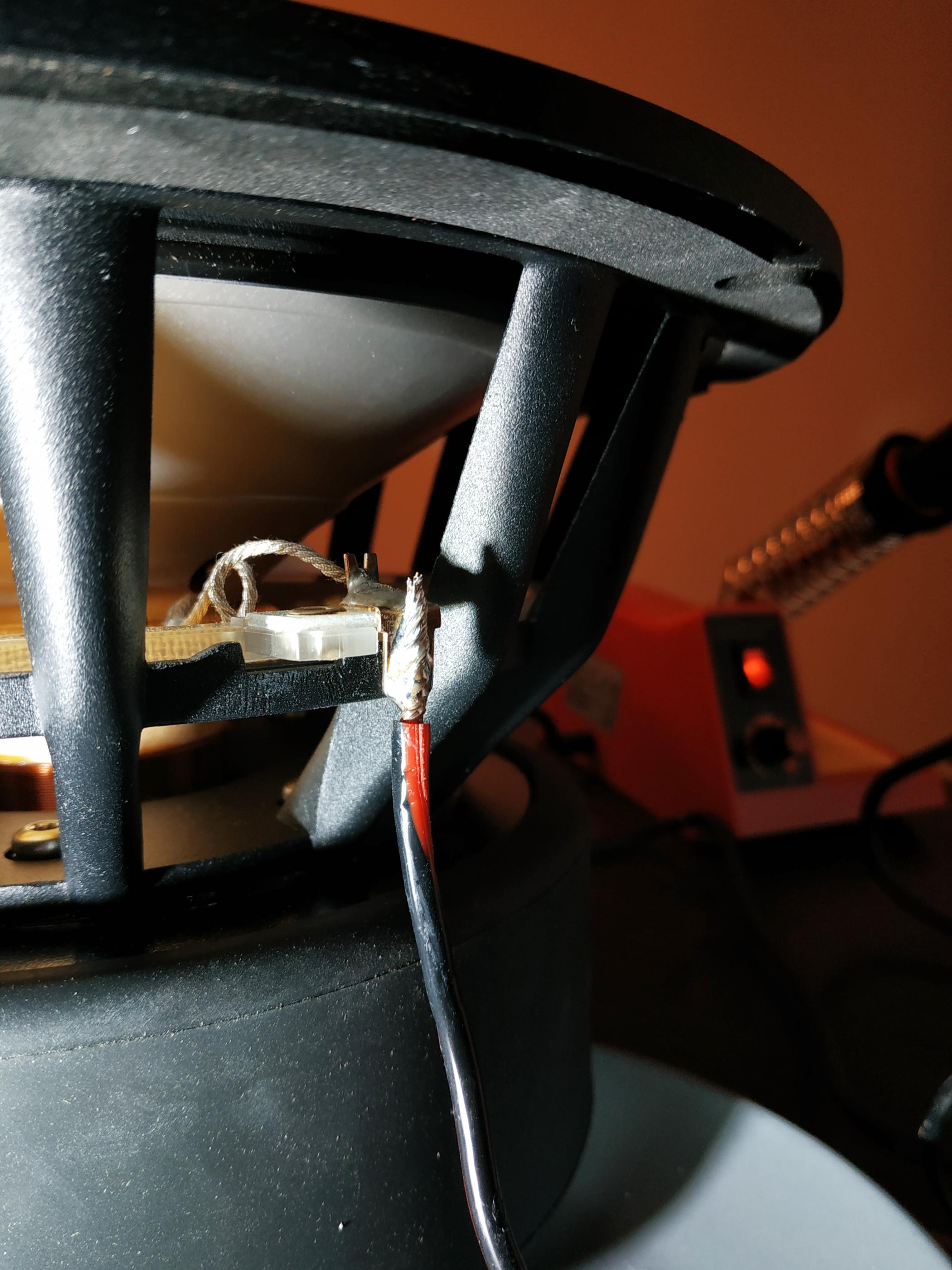

Soldered the connectors and the driver. And done.
