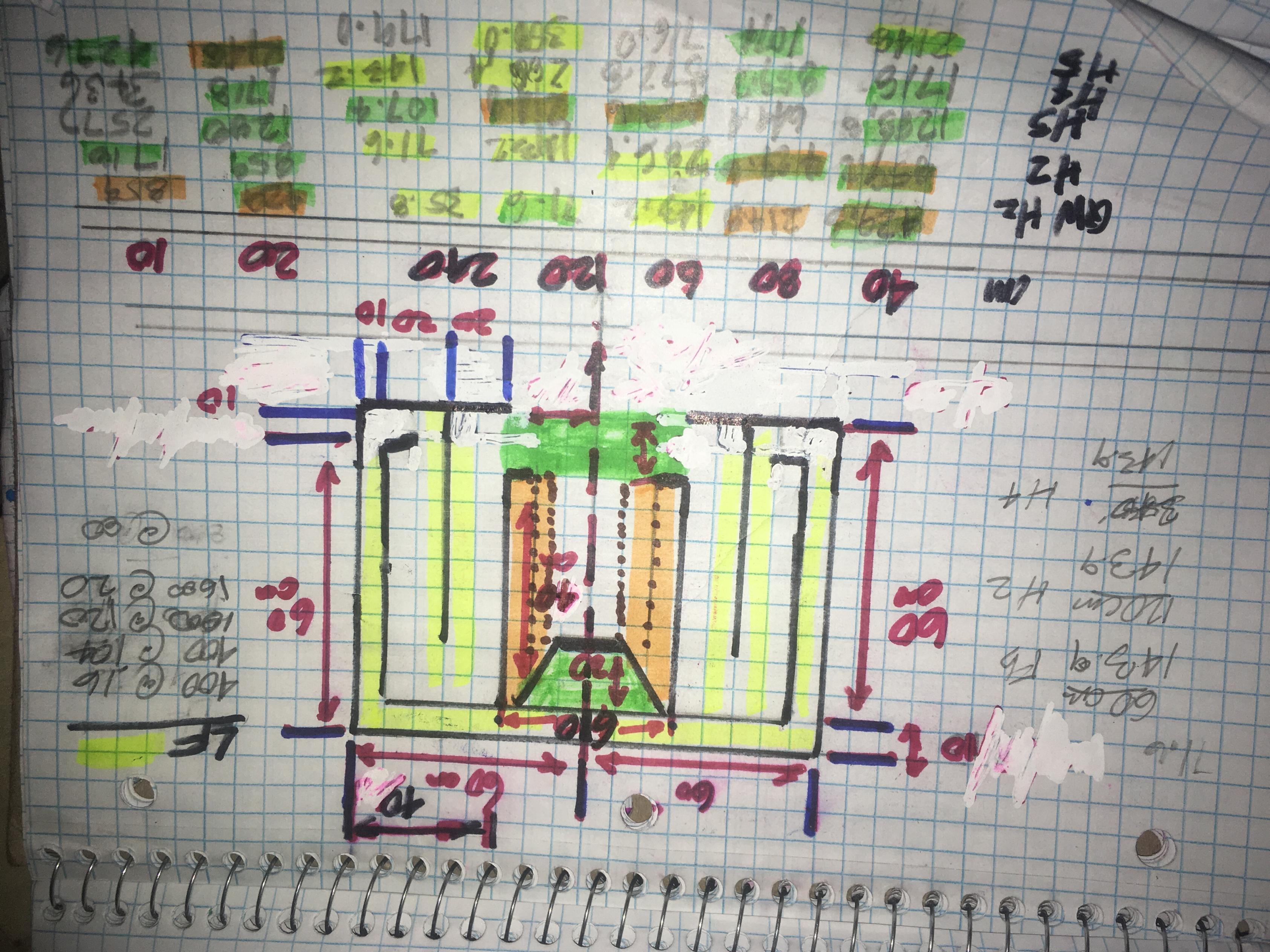

Try supporting the the harmonics we might need to work for us or against us by allowing a 71.6(40cm +80cm) hz standing wave to exist, and escape if needed. or bury them within the null in a fold that is plumbed to a pressure max elsewhere by a small pipe or tubing. we already drill holes to ambient and ducts within our Qw length shapes. the next step (some sort of) is maybe to assign them to multitask for us, and promote the responce we need, even a ‘bad’ one. Restrictor plates and orifices, skinny pipes/tunes relief pressure but do not disrupt the long wave? 240cm is a compounded horn with an 80cm rear output.. perfectly aligned in phase, minus the trip to the other.... what if thats a helmholtz and the phase results as the entire length, but only in qw on one side? helmholtz can be halfwave and/or another phase? 240cm and 120cm in a compound horn, from eother side seperate and reflected all the way from the open end of the ‘TL’ side.. Bass extension another way? a straight TL (driver entry at V max(exit), with a rear vented chamber at the same tuning, but from a higher order in length? Helmholtz will do this, but so will a halfwave
Heres an example of a design already in use(pic): Highlighted to show all of the dimensions that ‘could’ also be frequencies of each other(and the fundamebtal). Each one is an impedance null or peak or shown in phase angle as ‘x’ degrees of rotation or ‘flipped’. If we Look, its already there to see? end correction and Qlosses, a small hurdle, inductance and many details no doubt, but what's a couple cm in several hundred? Nothing, we deal with that every design and sim already as wood?

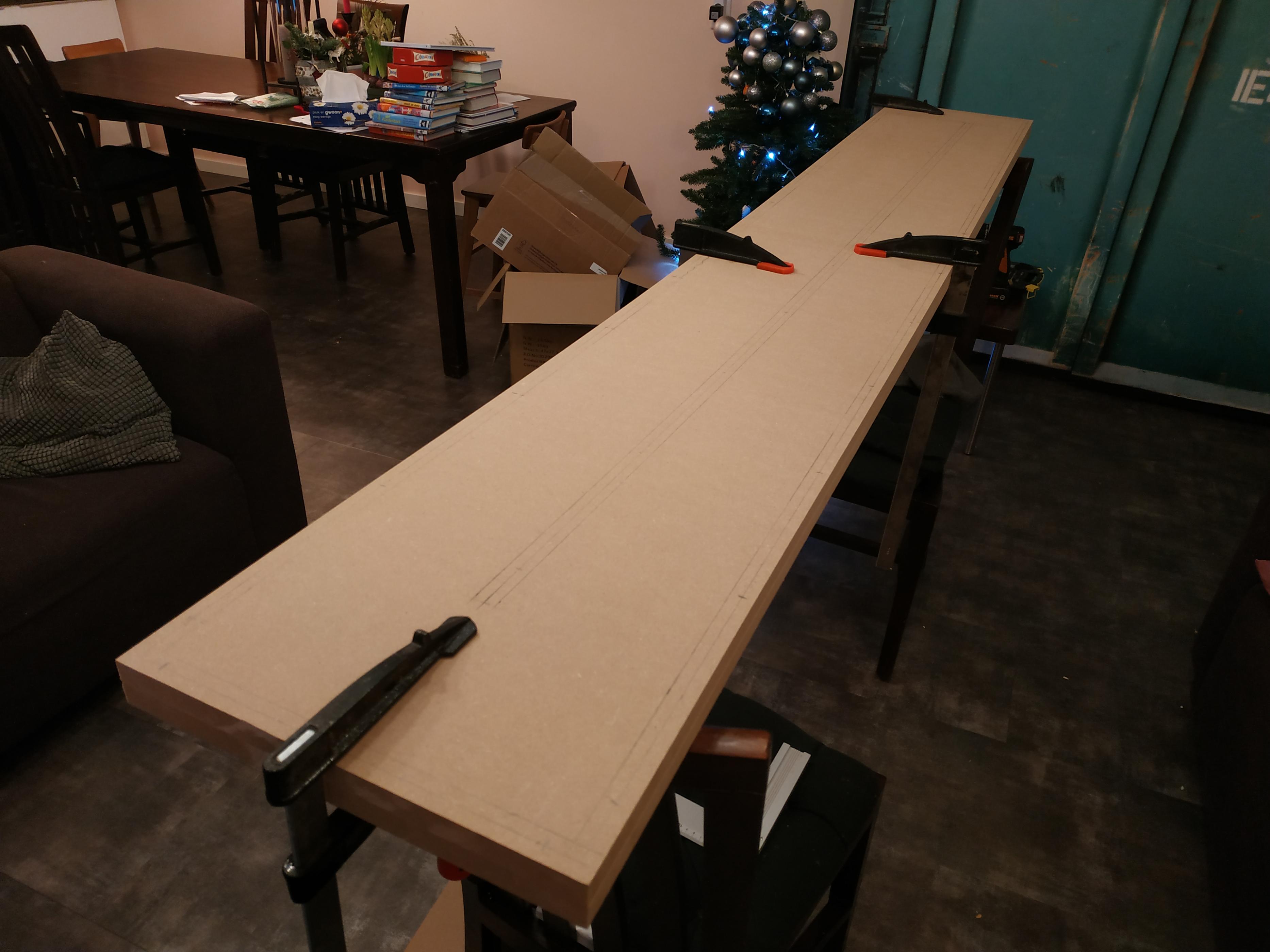

Build #1
Hey guys, build has started!
As I don't have a workshop and outside is 'dutch weather' I did some work in the living room.
First I clamp the pieces for predrilling and screwing. If all fits well I unscrew, add wood glue and screw again. I use only little screws (big ones can screw up MDF, you know), max 20cm between, just as clamps for the glue to dry. I have some big clamps, but not enough for this big project.

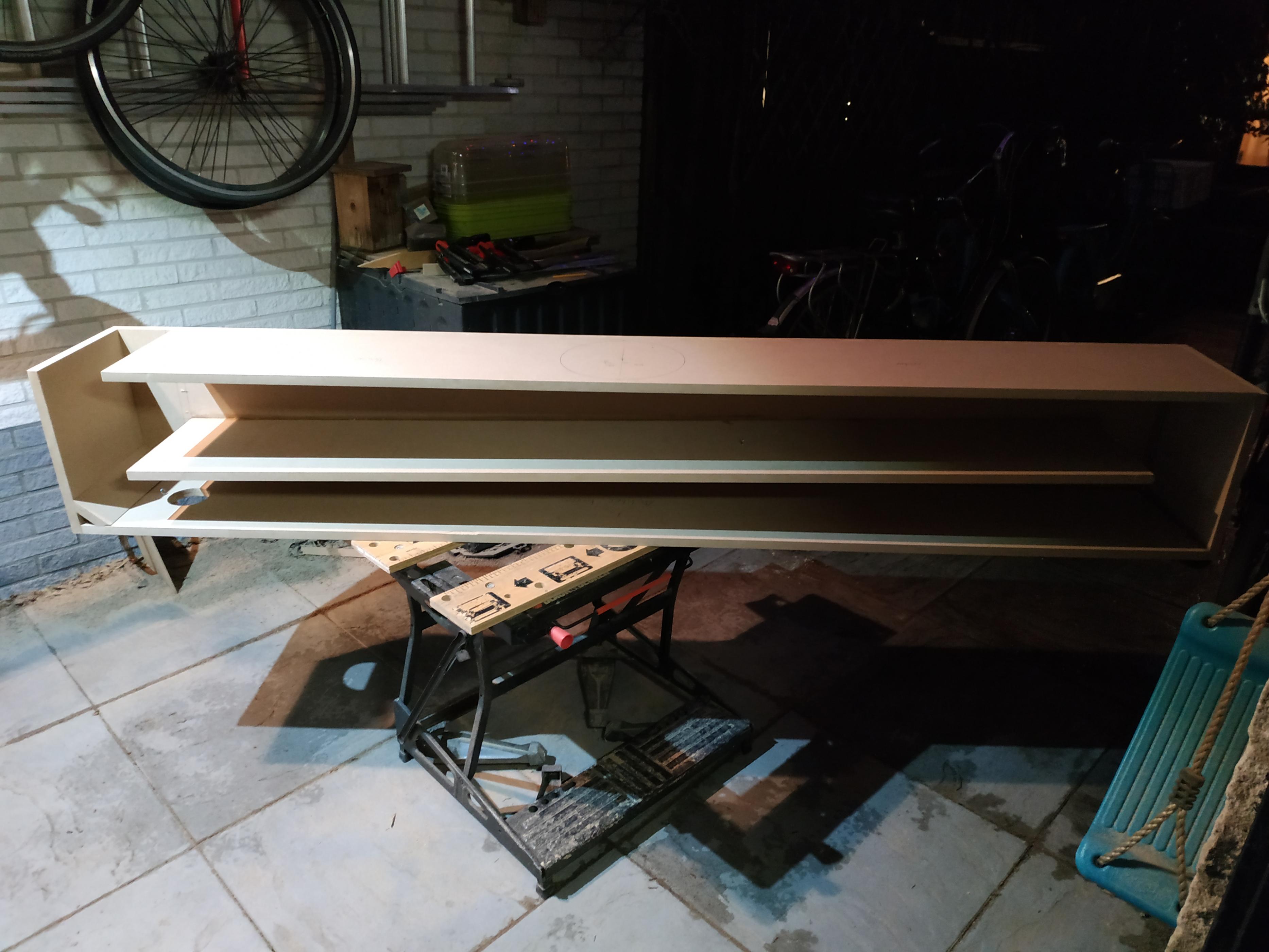

Right now, half of the parts is glued.

Im digging more rabbit holes and for sure need to look at apertures and splayed drivers soon! right now im 10 harmonics deepo
I use this (link) for fast reference to stubs, folds and offsets. still trying to ‘perfect’ a extended roar/paraflex in phase at the ‘middle’. as soon as there's a ‘tapped entry or an offset From a closed/exit end things get wacked and theres no ‘perfect’ to be found. A 120 cm offset driver followed by 200cm TL or any combo of 120/fold/120 and rear vented 80cm is great. seems im chasing pythagoreum in layout(?), meanwhile sprinkling segmental CSA bumps at folds to LP filter along the way and stretch out the response shape where appropriate.
60 degrees in compound or 90 degrees in standard qw pipes @ exit/direct radiator is pretty easy in a straight CSA based on Vas and Qts, but anything else in the pipe, or segments of it, gets mentally un forgiving fast

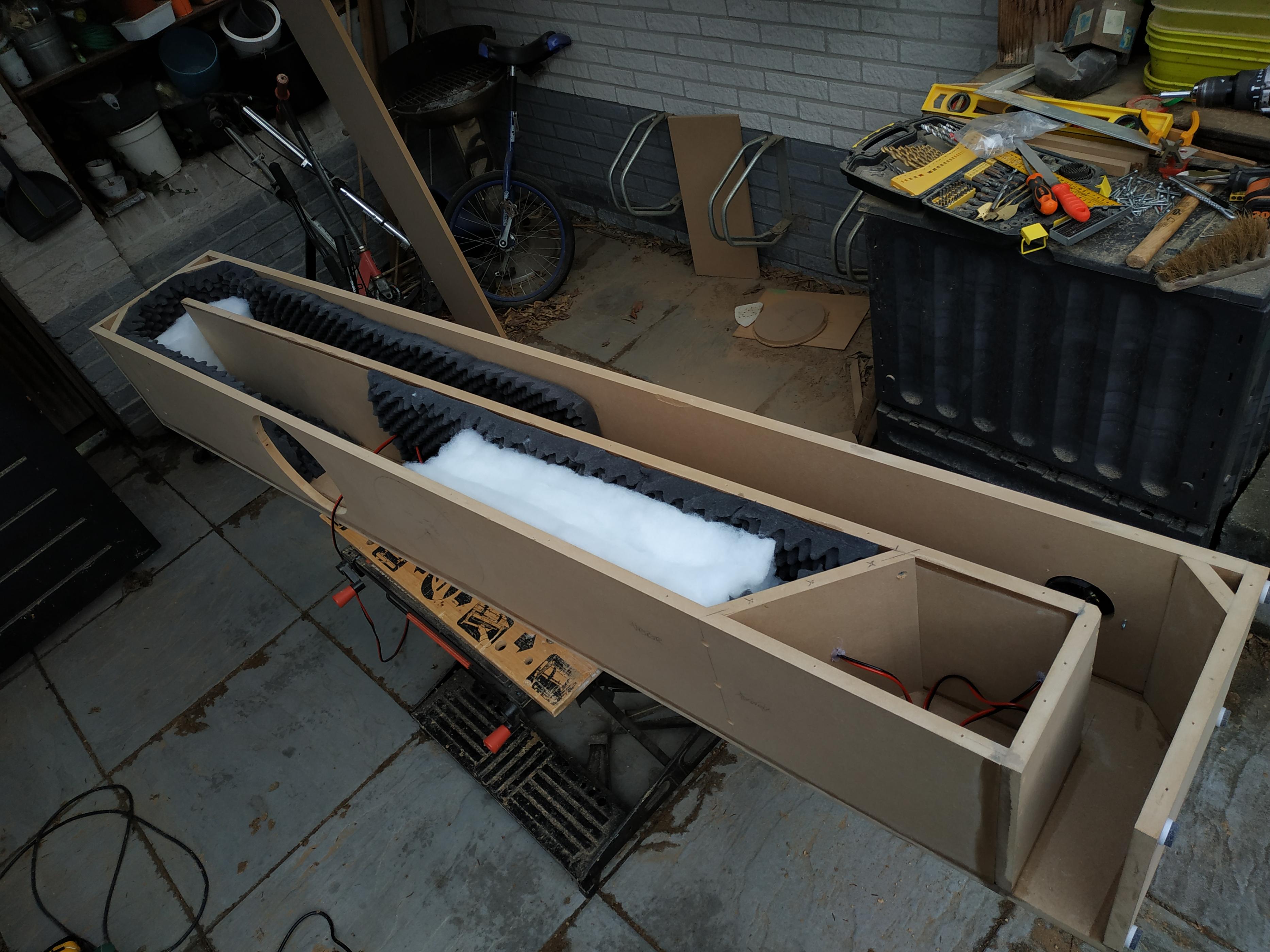

Build #2

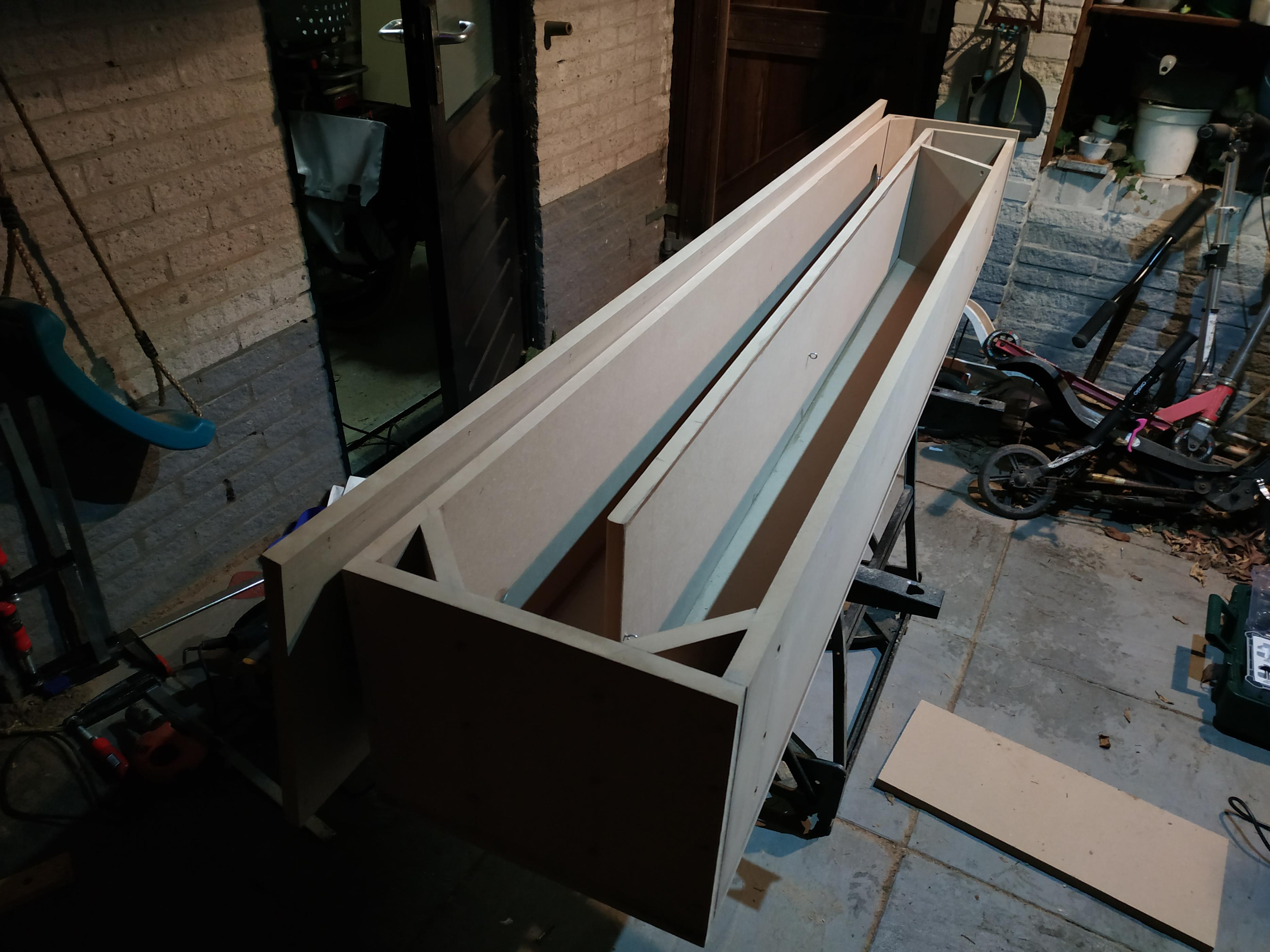

Update!
Few pics of last days:

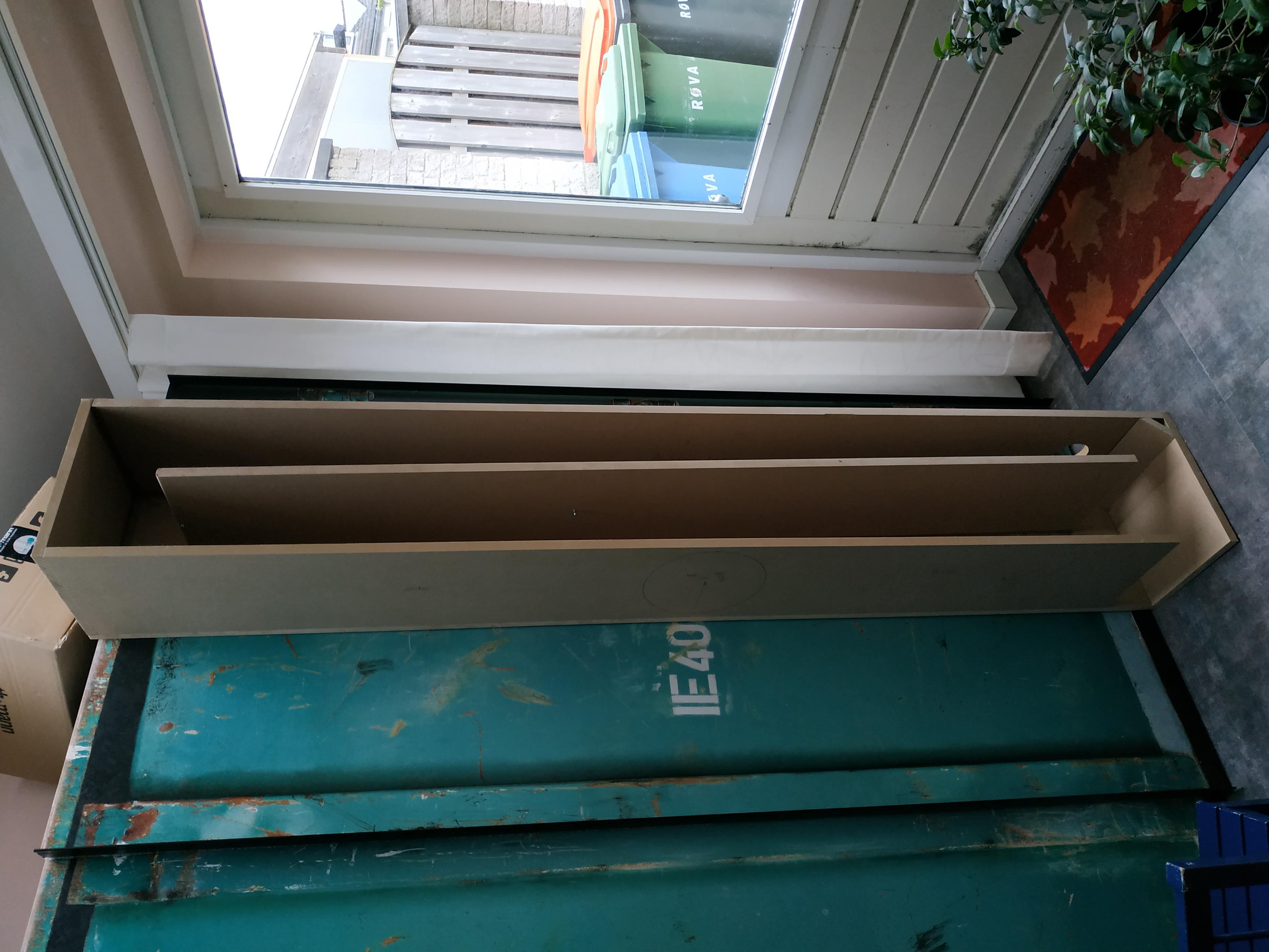

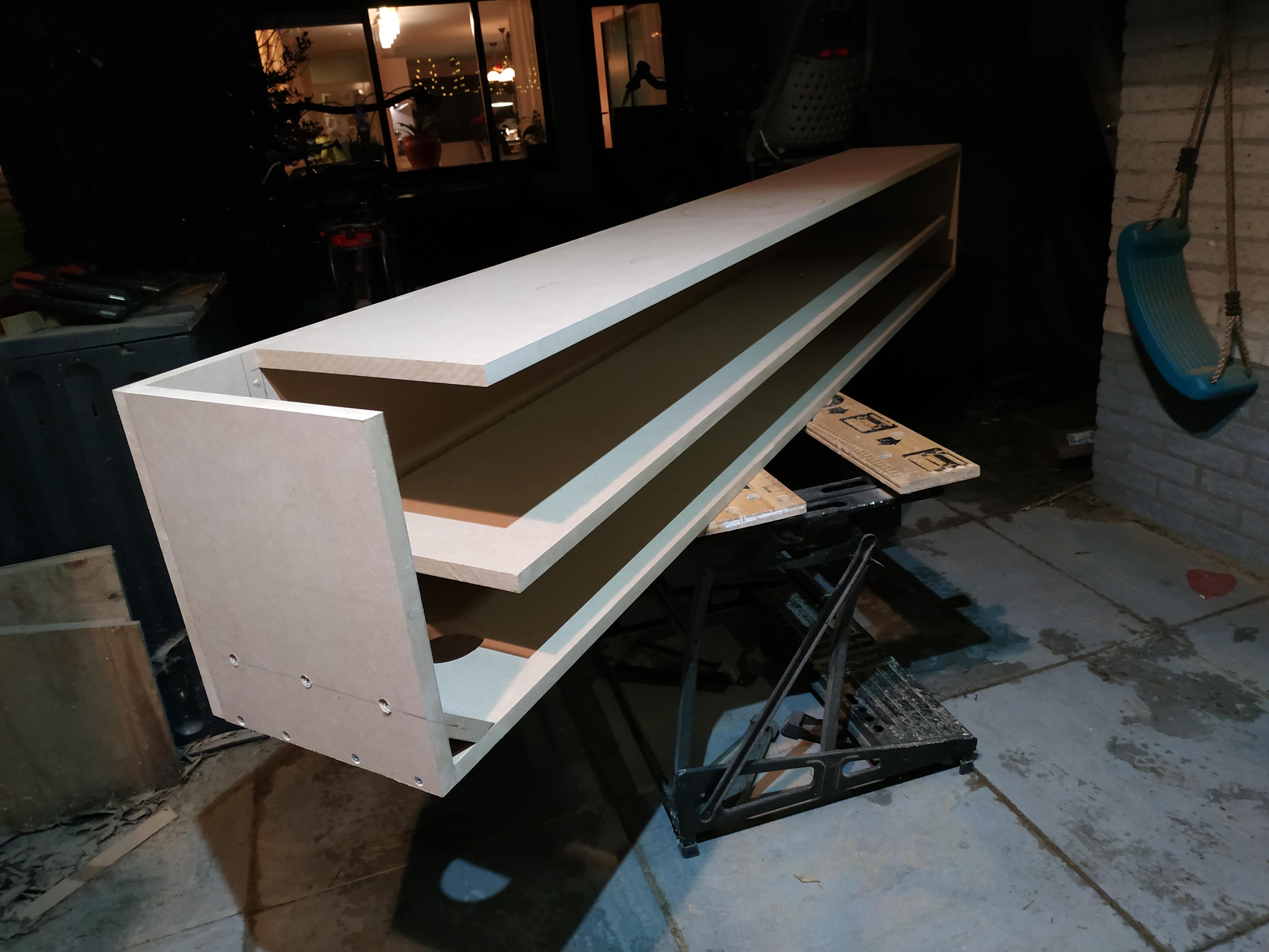

For comparison how tall this sub is. Taller than my door.
Finished all the panels.
Today the interesting stuff:

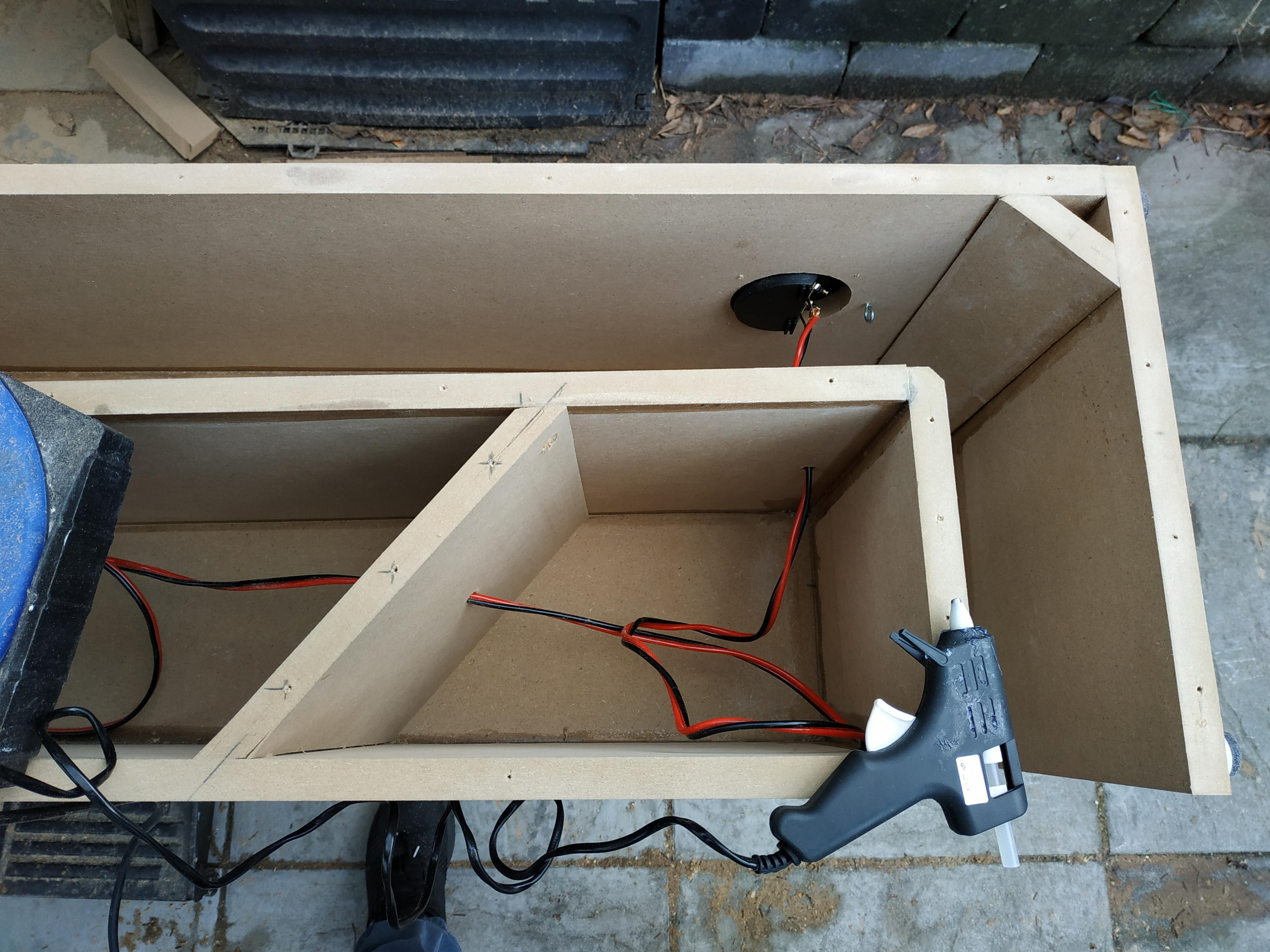

I put in the wiring. At the bottom of the line I made a little compartment. Won't use it now, but maybe later I can add a crossover in it. The wire is fixed with hotsnot.
At the driver I attached the wire to the inner panel. For in case it drops to the bottom....
Then the stuffing. I filled the bottom and a little at the bend.
Final shot of the inside. Will miss the view, somehow

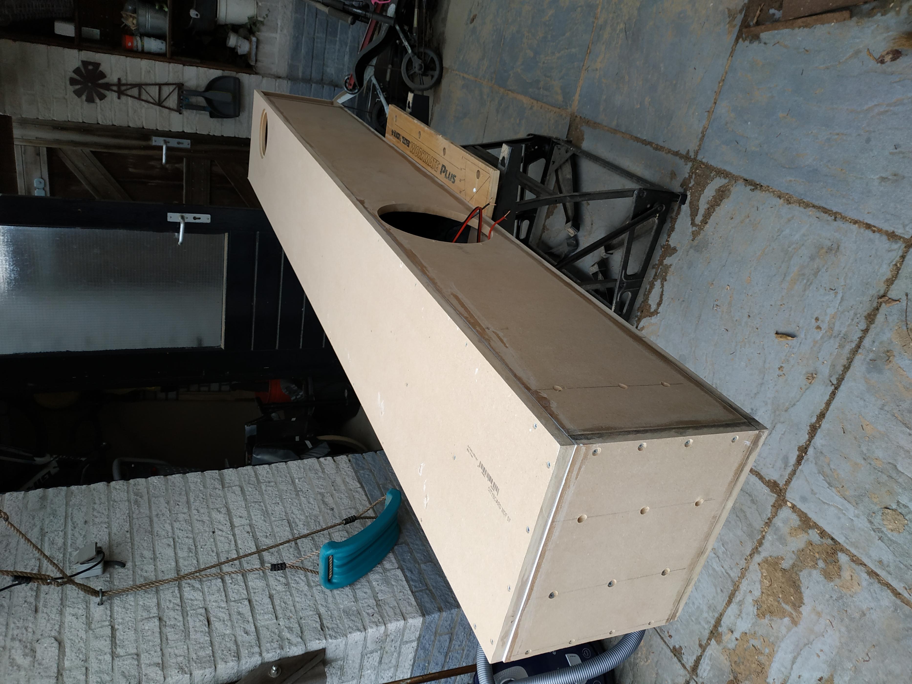

OK, case is closed and glued. Time to add the driver, while the manager is watching
No time for a proper test, but wow I am impressed! Even at a little power the windows shake in the whole house; says my wife.
But the smoothness impresses me the most. It feels like it's too easy to drop the bass. Love it.
