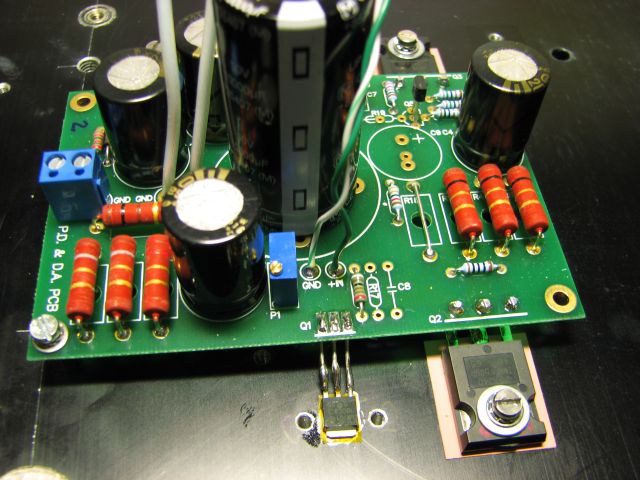

It´s time for me to start building my ZV9 too. I have pcb´s, heatsinks, Jfets, power transformers and I ordered all the passive components yesterday. One question though: Can I use IRFP260 instead of -240? I have a bag of -260s...
I guess the higher capacitance won´t be a problem for the cascode Fet and the cap multiplier, but maybe for the signal-tracking CCS?
Fuling said:It´s time for me to start building my ZV9 too. I have pcb´s, heatsinks, Jfets, power transformers and I ordered all the passive components yesterday. One question though: Can I use IRFP260 instead of -240? I have a bag of -260s...
It makes no difference. I have tried with 2*irfp250, couldn't tell the difference from those to a single irfp044.
Magura 🙂
meanman1964 said:Are you using Kapton underneed the fets?
I am using Kapton and thermal grease underneath the JFET, and Silpads under the mosfets.
