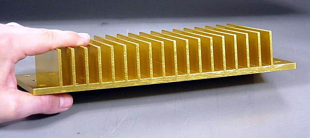

Zen9 Heat sink
You guys think this heat sink is big enough for a Zen 9? Looks a little small.
I want to stack 2 for one channel and put the CCS on one and Jfet and Fet on the other.
What do you think?
Thanks,
Vince

Umm. True that.
I was considering stacking because I have these 5"+ caps that I'd like to use. However, with 20"+ on depth, I could lay the caps flat too. Should be room for caps and transfos too.
That brings up another question: what's the voltage of the PS caps? I have about 20- 10k uf 35v caps...Nope. Needs 63v. I'll have to add them to the shopping list.
Thanks,

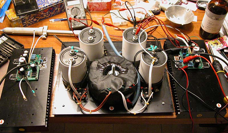

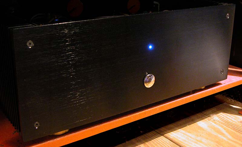

My ZV9 at last.......
When a suitable chassis came up, the ZV9 amp was fired up!

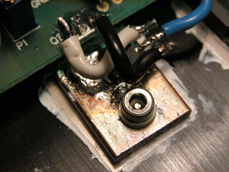

LU1014D power JFET, which will be solder at the Copper plate
ZV9 PCB by PD & DA
Most resistors are BC's, with MUSE KZ caps and Blackgate F
I have to wire the JFET due to fragile pins of LU1014D
RIFA PEH169 22000uF/63V for power and coupling
Measuring voltages
Listening test
Still trying on different bypass cap
Thank you PAPA!
