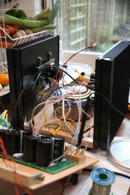

Yay! Finished mine today! Both channels working with a twisted pear kookaburra as the volume control.
I'll post some pictures of the box all put together nicely...
Steve
Some pictures as promised.
Initial listening impressions - it matches very well with my Austin FE166s. Everything we have listened to sounds like we are hearing it for the first time...Stravinsky, Ozric Tentacles, Mahler, Art Tatum.
I'm also quite pleased with the look, although I wish I'd thought of a neater way to do the wiring...

Love the look of it. A real Tough Guy amp! I think the knob needs to be an old fluted bakelite type though! maybe something like this:

Congratulations Steve
Nice compact placement of boards in a cube!

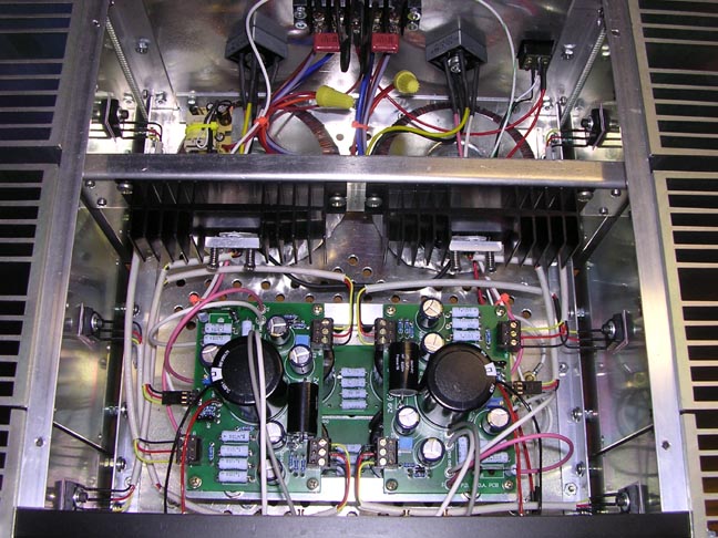

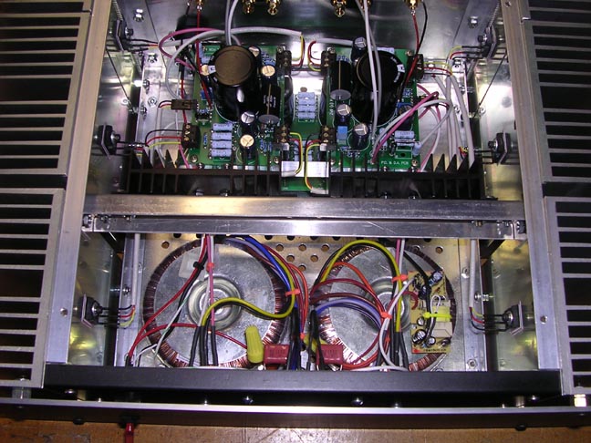

My Zen V9
My Zen V9:
Main and PS capacitor boards courtesy of P. Daniels and D. Antoniak.
JFET courtesy of G. Rollins, thanks guys.
Side mounted heatsinks are made from surplus units each measuring 6.5" H x 5" W x 2.75" Fin.
Two and a half units make up a side.
Q2 and Q3 are each mounted to a unit, Q4 is mounted to half a unit.
JFET Q1 is mounted to the internal heatsink mounted across the chassis.
PSU/channel
Trans 250VA 18v+18v Avel Lindberg
Capacitor bank (4) 10,000uf 63V Panasonic TSHA
