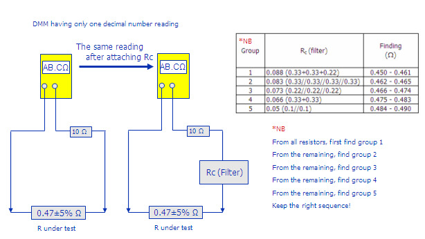

bontakun said:
I am shocked at what 5% variance means for some of these resistors. Like the 0.47R measured as 1.1R or higher. Just surprised about that.
Don't be surprised. It is due to additional resistance through DMM.
I usually use the method as shown in the attached sketch, where
we could choose the resistors within about 1% tolerance.
I hope this info will help.
Kkkkk hhhhhhhh . . . I was wrong. Very sorry.
I should have wrote down as +/-5% tolerance. :devilr:

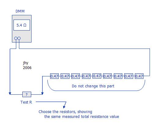

I have thought another way to find similar values in five groups
I hope the attachment will well explain what I have thought about.
Of cource, if we have expensive precision ohm meter,
it would be the best solution . . . 🙂

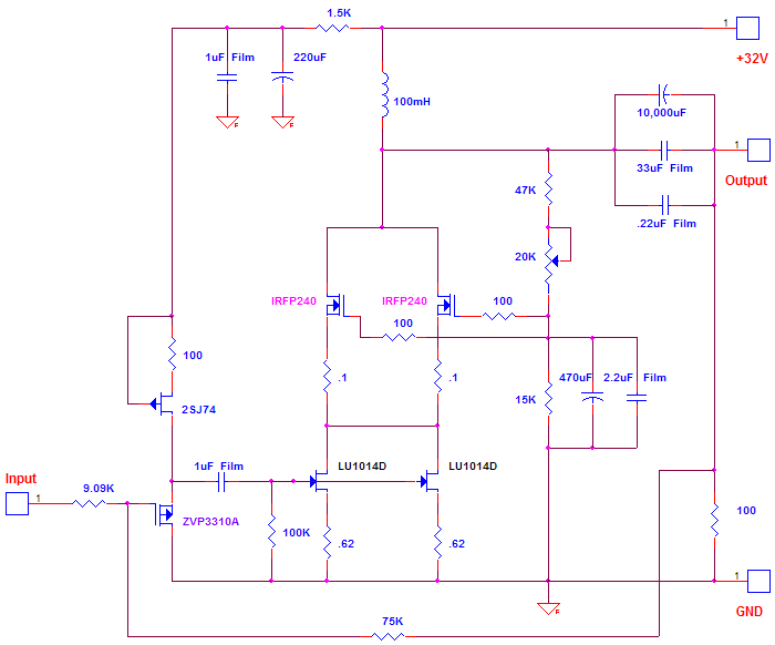

Not sure if this is the proper place for this but I didn't want to start a new thread about it, and I am kind of a Zen 9 builder, though not finished yet.
Cred to veteran for his zen pcb but I wanted a board with all transistors on one side so I could mount all 240s with one bracket (+ some other things that I needed to change), so I whipped this up last night. It's probably not even near a perfect layout, so I humbly ask for input.
www.student.itn.liu.se/~andja285/Zen v.9.pdf
(Server is down from time to time, sorry about that. To big to attach)
Thanks...
A useful experiment for you to try on that circuit would be
to compare the performance of the Drains of the JFETs
tied together (as in your schematic) and not. If they are not
tied together then you can dispense with the Source resistors.
