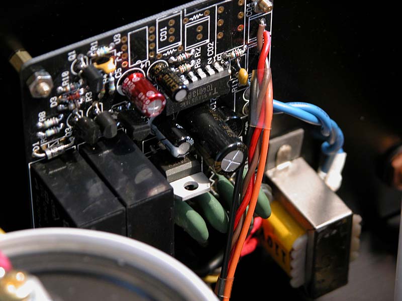

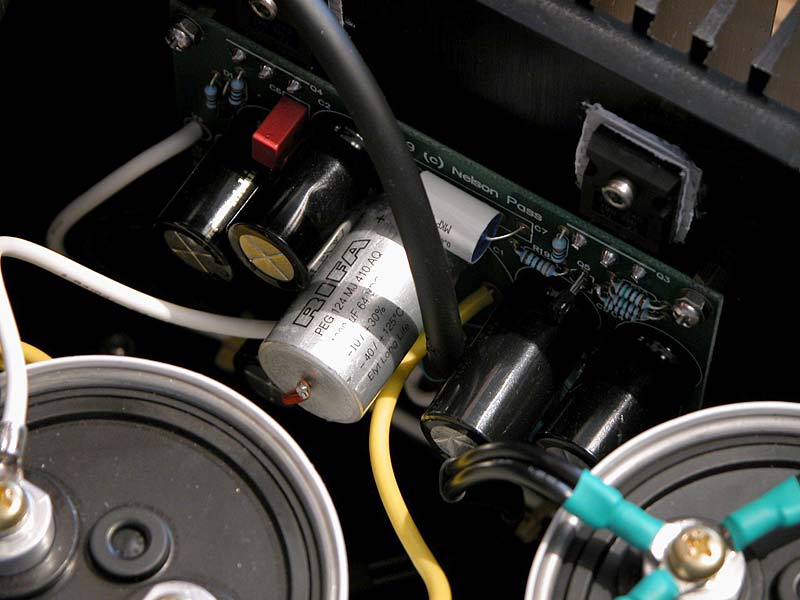

Some new pics :
Soft start module
The output cap are RIFA PEH169 22000uF + RIFA PEG124 1000uF + MKP 0.47uF as base.
Today I did some bypass testing, found that one Mcap MKP supreme 4.7uF + one Bennic XPP 39uF to get the superb result.
Will keep on testing....
cheers
Coffin
Soft start module
cheers
Coffin

Good Morning,
Coffin is using a Rifa 22000uf/63v as a C1 output cap in the amp pictured above. Nelson specs a 15000uf/63v cap and a number of builders are using a 10000uf/63 Jensen 4 pole. Is there any downside to using such a large value cap in this position? Any upside? Thanks. James
Downside: It costs more, more capacitance takes up more space
Upside: Better filtration, better dynamics
Bear in mind that most electrolytics have really wide tolerances. It's nothing to see +-20%. If you think in terms of 15000uF and add 20%, you're almost half-way to 22000uF. Unless you go really nuts, there won't be a problem. If you do go nuts, stick a resistor or inductor in front of the cap bank to slow the pulse it draws from the diodes. Problem solved.

Okay...caps, take two:
Downside the same.
Upside being lower rolloff point for bass.
Howzzat?
Grey
Downside the same.
Howzzat?
Grey
Most of what Grey say's is true until you get to the goin nuts part. 😀 But, bigger tends to improve low freq performance. Gives less phase shift. Lower Damping Factor. Lower Xl, lower ESR, quite likely higher ESL. Even if only an infinatesmally small amount of improvement is to be gained, someone will go for it.
And of coarse, listening to it wins out every time.
One suggestion I've read regarding caps effecting your signal path. When they are out of the passband by a wide margin, their bad effects are less noticeable or effect the signal less. But then, I've also read, never use a bigger cap than necessary too. 😕

Peter Daniel said:Today I connected the tweeter (Aurum Cantus ES G1) directly to the amp through 6.8uF Siememns MKV cap only (the midrange was connected through BG N 1000/50 cap), no other electrolytics at amp's output have been used.
If you run your tweeters through those large electrolytics, you really don't know what Zv9 is capable of 😉
The focus, delicacy, definition and resolution of highs are truly impressive.
Thats a very cool idea, I'll be testing that.
I am not finished yet, I decided to solder a new pair of boards, with some better part. Black Gate caps and so on. I am quite sure about what to use for the outputcap. I have some of the usual Panasonics, but I might try some Elna's that I have. Another idea would be to parrallel Pana FC's to get to 10000uF. Any other suggestions?
steenoe said:I am not finished yet, I decided to solder a new pair of boards, with some better part. Black Gate caps and so on. I am quite sure about what to use for the outputcap. I have some of the usual Panasonics, but I might try some Elna's that I have. Another idea would be to parrallel Pana FC's to get to 10000uF. Any other suggestions?
Yes, smaller caps than 10mf works better and if you include a 330 uf -or so- on that group plus a small film like MPK you will hear the diference.
Cheers 😉
Thanks Tony. I will try smaller ones in parallel. I just found some Nichicon Muse 2200uF caps in the drawer, they will fit much better on the board than the FC's, which will have to be raised. I think I will try with those first. Paralleling 4 of them per channel can be just squeezed in, on the board.
