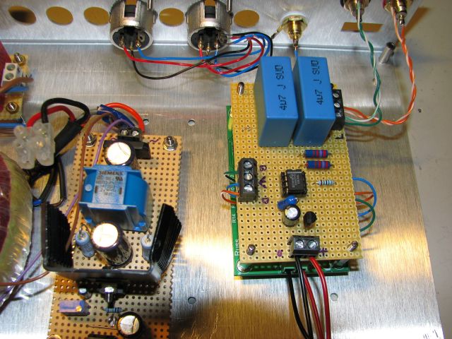

Yep, I have connected the BosoZ right now (A plain BosoZ) and like it a bit better. What I liked even better was swapping out the CD-player with something else😉 Yesterday I P2P wired a simple TDA1543 DAC (Inspired by Peter's design, ofcourse). I hooked the DAC to a 200$ Phillips DVD player with SPDIF out, and it actually sounds surprisingly good🙂 This is close to a Frugal-file system!
Here is a pic of the DAC. The passive IV is just 2 Riken carbonfilm resistors. I used one of Russ and Brians receiver boards. Next step will be trying adding a D1 IV stage. Never mind the messy build, I just popped it into an old network box.
Overall my ZenV9 system is very nice sounding for the money, indeed.
