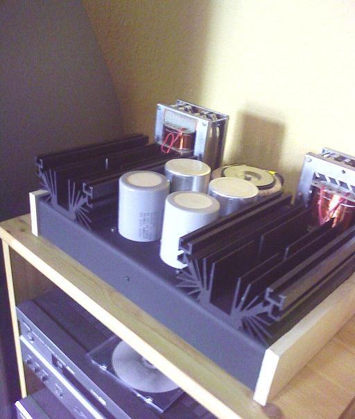

Hi Fuling!
A pair of 250mH 4A chokes on dual C-cores would be nice...
Something like this....?😉
Tyimo
Thanks!🙂
They was in my junk box. 😀 I mean the SM120 hypersil iron set. The chokes are 185mH with very big (1mm) airgap and 1.32mm wire. Basicaly the whole amp made from "recycled" parts.
(The amp is not a ZV9....)
Greets:
Tyimo

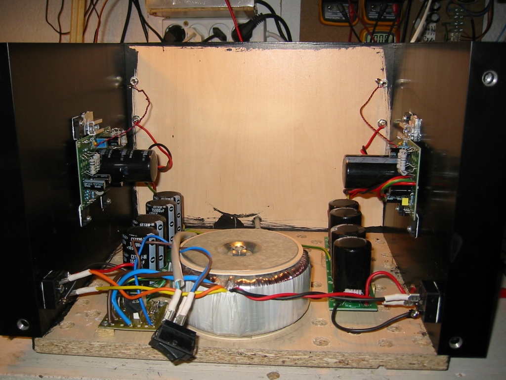

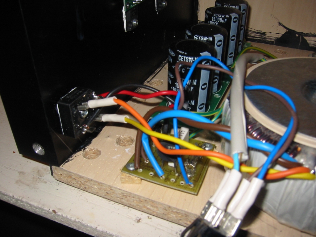

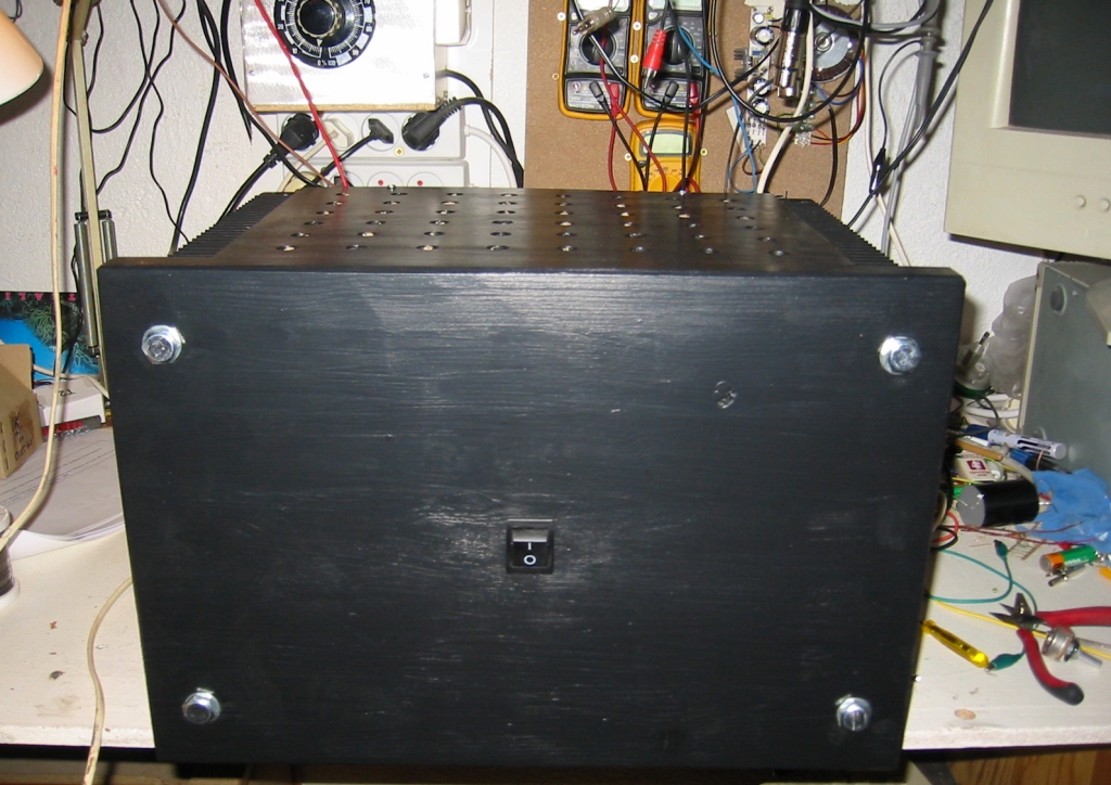

Finally finished my Zen 9. Have had it lying in the workshop almost finished for a couple of years.
Anyway I got the transformer and heat sinks a few weeks back, and here it is.

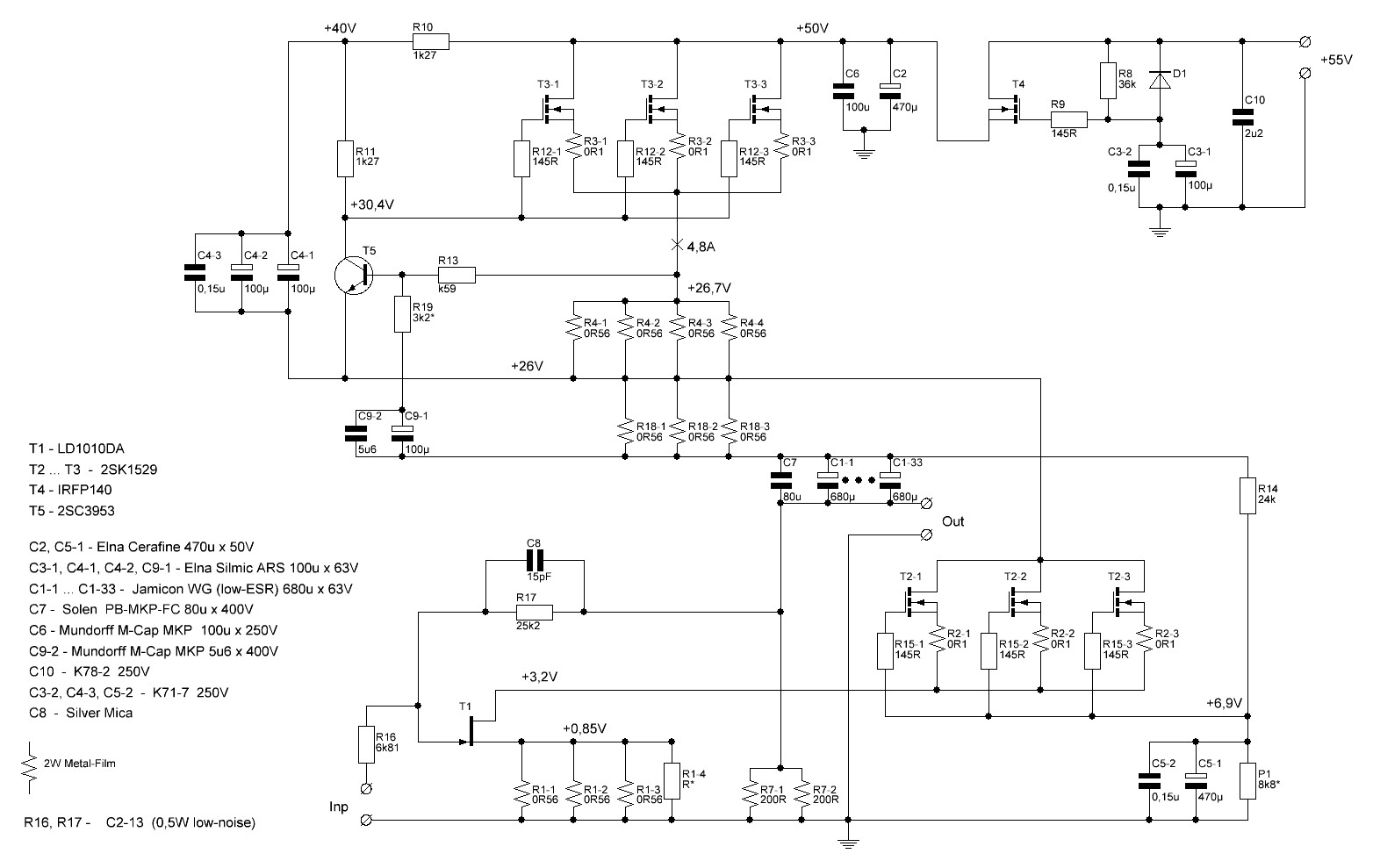

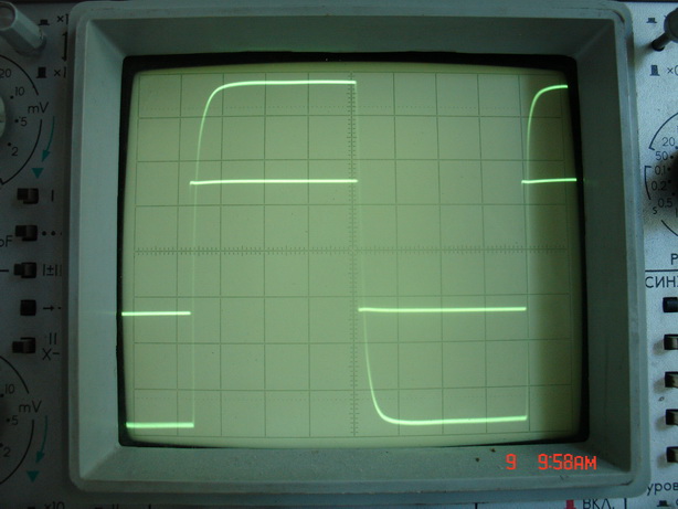

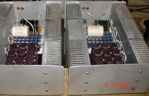

Here is my current version of upgraded Zen9. My new PMC EB1i power demanding loudspeakers are very happy with these monoblocks, excellent sound without any reservations even at the low end. Classic music, metal, jazz, organ, everything is amazing. The square wave picture is for 3,2Ohms resistive load, 15V peak-to-peak, 10kHz, C8=15pF. With C8=5pF the picture is still OK.
