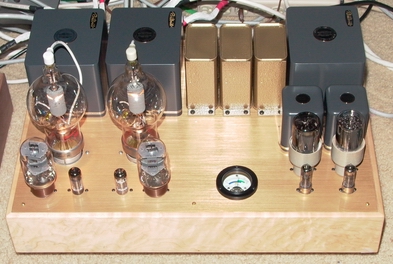

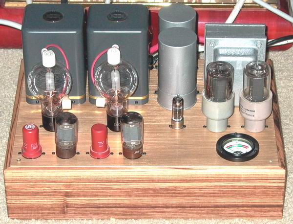

Here is my latest amp.
It's a stereo 35W SE with Eimac 250TL tubes. The output, power transformer, and chokes are Tamura. The circuit is identical to the 833A amp, but the power supply use vacuum tube rectifier for both driver and output stage, double chokes and oil caps.
Thanks James,
I hesitated quite a few time when I started building this 35W SE amplifier using the Eimac 250TL tube which I have never seen anybody used them in audio amplifier. The parts I gathered for this amp was originall designed for an 845SE amplifier. The glow of the 250TL has started it all.
This amp sounded much better than my 833A amp and also a pair of 845SE that I build (using identical Tamura output). In the pass, it is just as strong as the 845, the 833A lacked the bass, but It might be due to the output transformer that I used and the higher bias current. On the mids the 250TL is warm, the 845 is darker and the 833 is lighter. The highs on the 250TL is more open than the 845, the 833 has a slight touch of brightness.
I would not say the 250TL tube is better than the 833 since both amp are constructed with different parts quality, they do share same circuit though. The 250TL used tube rectifier for driver/output stage while the 833 used solid state rectifier.

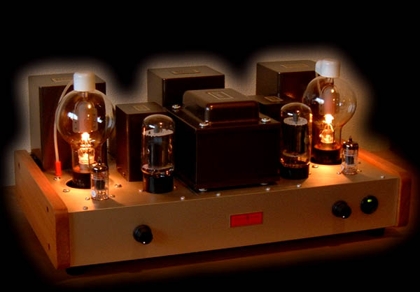

I also build a 808 amp using Tamura F2007 transformer, but later changed to 300B. I preferred the sound of 808, some day I will modify it back.
I also thinking about building a 100TL amp for a pair of Tamura F7003, since I really like the sound of the 250TL, but I need to buy these tubes, getting pretty difficult to buy Eimac tube these days.
Regarding the 833A, when I said said that they are a little bright, I meant that when compare to my 845 and 250TL, the 833A highs was never fatiguing, I guess I should have said more extended high.
Here is my 808:
