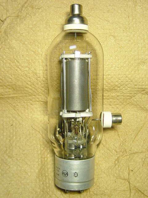

810 Triode Tube
Hi all ! , Reinout !
How are you ?
Reinout ! I have two pairs of 810 triode tube (RCA , Cetron) but I never seen 810 Tube Single ended audio amplifier.I think it's a good triode tube.Why Diyer are not to like it make SE Amp ?
Thang you!
tubeman.
How are you ?
Thang you!
tubeman.

parafeed and ultra-parafeed
Hi Tubeman,
the 810....nope....never seen a audio-amp with that one. Lot's of 805's, 211's and 845's. And not to forget the 813 (in triode). Why not ? I believe James D gave a good reply on that. AND the 810 is still used in a lot of ham-transmitters. The current Chinese production is not comparable with the "old" American ones....so prices of nos 810 is quite high. Still not in the 845-price territory (scaring !), but certainly a point of consideration.
What are you going to do: pressing on with the 833-idea or pick another transmitting tube ?
Make a wise choice. The parts will not be free !
Reinout

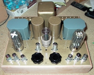

Hi James D,
EXACTLY my thoughts when i was doing the theory for my 833 amp. Happily i had Vacuum Tube Valley issue 16 where Lynn Olson had a great explanation of all types of configurations: from "standard" single-ended via UltraPath (registered !) to Parallel Feed (your thoughts) to Ultra Parafeed.
I'll enclose a small excerpt of the article. It's a periodic table of topologies and is simply GREAT. Thank you Lynn Olson !!
During my audio-history i've learned that repeating the same tube can be very tricky. You enhance both the good AND the bad qualities. The same is with schematics. Doing a three-stage amplifier with three times the same schematic can be boring to make and/or to listen to. So looking at the table of topologies and doing some calculations i came up with:
- 6SN7 push pull (input)
- 300B se (driver)
- 833 ultra parafeed (output)
And the same is done with the transformers. I picked different lamination-materials in almost each stage. Simply to get the best material at the right place:
- mumetal input transformer (very fast fast and detailed but prone to saturation: input !);
- permalloy-49 interstage between 6SN7 and 300B (great combination of speed/datails and saturation);
- M6X as interstage between 300B and 833 (this material can have serious punding and will not saturate);
- M6X output. I wished i had a HUGE permalloy core, for it needed to be wound for 1 kV+. No flimsy wires here ! The size permalloy i wanted was not available. So i "stuck" with M6X; and that does not "hurt".
And that M6X opt was way smaller than in a normal SE configuration for now the laminations had no air gap / there was no chance on DC / etc etc. The whole opt became less critical. Of course there is a down side: introduction of a parallel feed coil (which you wanted to do anyway) and a cathode-transformer bypass capacitor. That sucker is a tricky item: it took time to get a correct one ....and later a good sounding one. See it on the bright side: you can much easier chance the sound-character with that single cap than chanching the whole schematic/transformer.
Mix'n match !
Try to pick up a copy of the No16 Vacuum Tube Valley; it's worth it.
And i'm very very interested in your thoughts / schematic of your 833 amp.
With regards,
Reinout

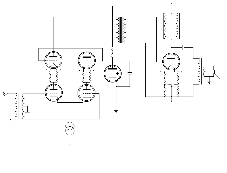

Hi Reinout,
Many thanks for your thoughts and the L.O. info. Lynn writes some very interesting stuff. I'll work through your email in detail later but I thought I would quickly post my latest thoughts on the circuit and its evolution.
I like to use push pull circuits, even differential circuits in my designs. Not exclusively but most of the time so the driver is push-pull. I also like to try and use only two stages in a power amplifier - mainly to minimise the build up of higher distortion products.
I like to use a lot of transformers as I find the breaking of ground planes between stages beneficial and I prefer the sound of IT coupling to any other.
Having decided with the 833 that I was going to end up with an SE output stage (mainly due to power supply cost considerations and I wanted to see how a big valve would cope in SE) I thought the driver stage would be the main challenge... In a way I was right as I couldn't get a high gain, high current driver with sufficently low distortion for my liking. I wanted to use a pair of PL802 in triode mode as drivers - 316a put me onto them and they have very nice performance - see Pete Milletts tests. They worked very well as a push pull pair up to about 100V output at 30mA but I wanted a bigger step down and more like 100mA drive minimum. I tried different valve combinations but none would give me the required performance in one stage. Thinking back to my ss design days, when I needed to boost single stage performance I went to cascode config. so I started looking at a differential cascode for the drivers. That lead me into the recent thread here where SY, Frank et al had debated the merits and performance of the LTPC. I was hooked! The only thing was to keep the output impedance down for the stage so I ended up with a pair of PL802s in triode mode for the lower valves and a pair of 2A3s for the upper valves. Now I have good gain and a +/- 150V , low distortion and low output impedance driver stage so I can use a 6:1 step down transformer and drive the 833 from a 60ohm source impedance. I have only simulated the design so far but it looks very promising. Of course the distortion spectra from the cascode diff pair is not as simple as a normal diff pair would be but it's not too bad and it is very low level at normal signal level.
Well that and the parafeed thoughts are where the design is today and here is the circuit drawing so far. I would be very interested in any comments. ciao
James
James

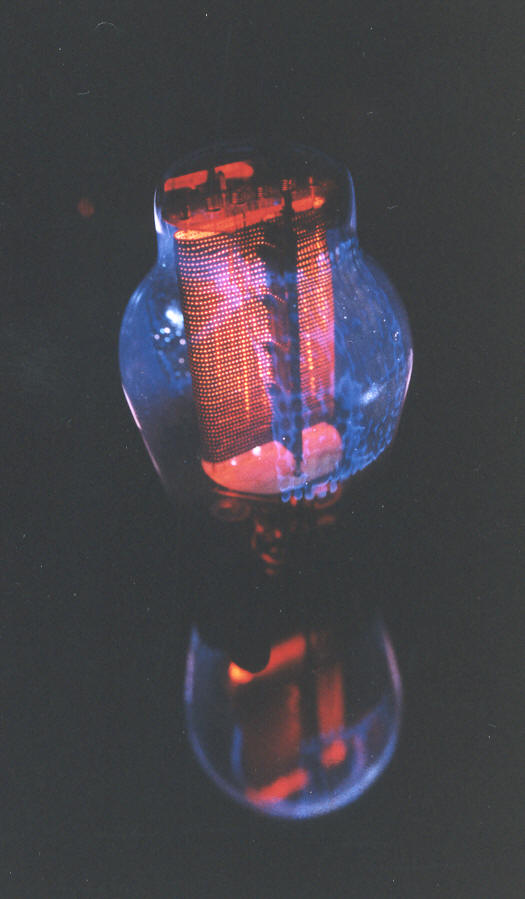

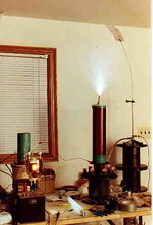

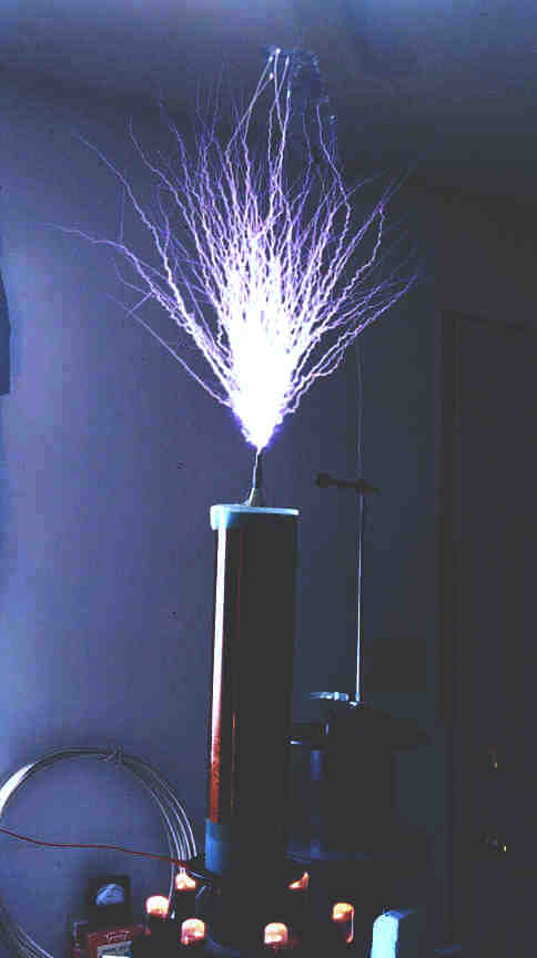

if audio fails.... (1)
Hi all,
so if your 833-based amp fails you can always built your own tesla coil with it.
No....this is not at my house; my 833's are up and running with music. I found these pictures surfing across the web. Still interesting: again the "spot" on the anode is clearly visible.
What kind of amp would this be ? Class Z ?
Reinout

pl802 cascode
Hi James D,
now that's interesting. Indeed you need a low impendance driver in order to "feed" the powerhungry grid of the 833. With my 300b plus 4:1 stepdown interstage i ended up with 44 ohm.
Differential cascode is new to me. It looks well up to the task (= giving enough mA's at low impendance and voltage swing). But this is uncharted terrain for me. As are the PL802's. Again: never heard them. Can you blame me ? There are so many tubes out there..... The 2A3 is simply great. But quite variable with different brands. And there is even a monoplate-version. But i believe then we're talking serious money. I've heard that the Sovtek 2A3 was good; it looks almost like a 300B.
About push-pull: very handy, it takes a lot of trouble / underpowering / transformer-issue's away. I did not went that far to built a 833 in push-pull, but wanted to have the very handy DC-free operating way of PP to take the load of the output transformer. So that's why i came up with parafeed. Which became ultra-parafeed in the end. 833 PP....how many Watts ? In class B the tube data tells me 1650 Watts !
You like transformer-coupling.....we can talk ! I really like it and have had very good results with this type of connecting amplifier-stages to each other.
This summer we (girlfriend + me) are planning to visit Rome. Is your amp up-and-running then ? Maybe it is unwise to switch the amps on in summer (just kidding). I'm almost afraid about the heat-output this summer. During the wintermonths it was no big issue. But they're only a couple months "old" and never seen a warm summer day.
If you ever happen to visit the Netherlands: your welcome !
Reinout

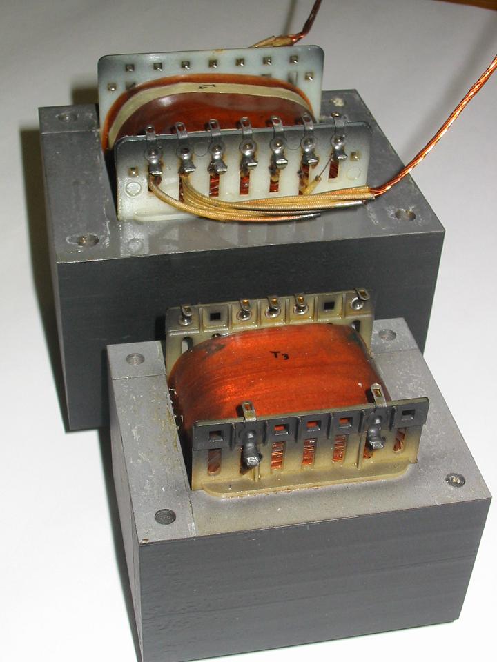

Included a picture of the E96 interstage and E126 output transformer (opt). They are impressive in sound as well in size. E96....normally that's already a hefty output transformer.
I asked the transformer-winder to make the lead-out wires of the opt NOT connecting to soldering taps but as a bundle of wires coming straight out of the winding. That way i was able to solder the opt straight to the loudspeaker binding posts.
Hi James D,
Reinout
Hi Unison 845 and Reinout,
I have looked at the plate of the output tube when using parafeed - and it is interesting at the edge of the passband. A bit more interesting than usual. Have a look at Bill Ramsey's analysis of the parafeed stage. He gives a calculated phase plot that explain a lot of what one sees... Mathematical Derivation of the Parafeed Output Stage
Within the passband the parafeed stage looks no worse than the usual IT coupled SE amp.
PL802 are a valve I had used in my early TV days but had ignored until recently 316a mentioned how nice they are as triodes. A mu=70 and S=40mA/V makes for an interesting beast! Pete Millett did some interesting work testing high transconductance pentodes as audio amplifiers.
High Gm pentodes
I guess the art of the cascode is choosing the right combination of valves for lower and upper devices - it easy to let the output impedance shoot up with all the problems that causes for integration downstream...
I tend to use the 6B4G NOS tubes or Sovtek 2A3. I haven't tried any of the expensive 2A3s yet and prefer the Sovtek to the chinese varients I have used so far.
I keep looking at the 833 in push pull. It is very tempting as I really like DHT PP amps... But it would be such a beast! I'm also working on a 211 Cathode follower push pull design that should have similar power output characteristics to the 833. I want to see if the CF PP gives a real advantage over normal PP (this will be my 845 PPamps) and SE at the same power level with real world speakers (i.e not my full range open baffles...)
Rome is a fantastic city with lots of amazing things to see - and very romantic 🙂. I doubt I will have my 833 finished this summer as I am moving back to the UK. I resigned from my job over Christmas and I am working out my notice period now. It's funny but I seem busier than ever since resigning...
Give me pm when your coming over and if I'm still here it would be nice to meet. I lived in the Netherlands for six years - had a great time. I occasionally get back so I'll come knocking!!!
I love the Tesla coil pics - but they scare me! One of my jobs as a junior engineer with Decca was to help test their ceramic insulators. I had to stand in a huge Faraday cage with the insulator under test connected to a 500KW transmitter and then spray water over the insulator to cause rf arcing!!! Then the insulator was examined for damage. Great when it worked like that but every now and then the arc would come back down the water stream towards you... It would normally earth around you as one had rubber kit on and used a plastic water gun but it is dammed scary to have a mini lighting strike going on around you!!!
Your transformer pics are great! E96 for an interstage is over the top! Twice the size of my office amp OPT...
