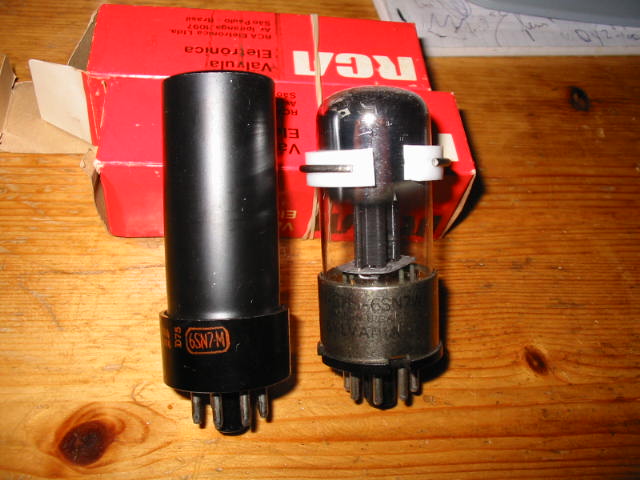

(the included picture shows the RCA 6SN7M and the Sylvania 6SN7W. The latter has a teflon tube ring in order to tame microphonics)

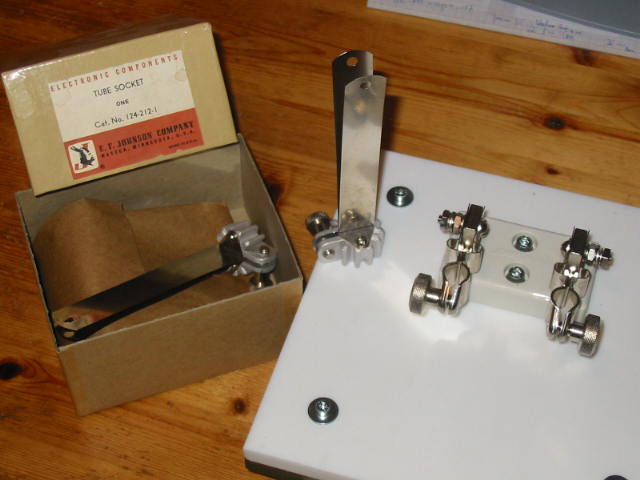

Hi Nick,
these are what you are looking for: Johnson 124-212-1 (or the RCA equivalant for which i do not have the number).
I stumbled across them...and bought the lot !
They were not cheap...but worth their money. If i find more of these items i surely will buy them: they are really sought after.

i do like 6SN7's and 6C45's
Hi Unison845,
although we share our 833-ideas we do not agree on 6SN7 use. I really like the 6SN7. It's a versatile tube with lots of uses. Not to much asking in way of power/voltages/ etc, and sounding nice as well. Of course there are extremely bad types (forget the Russian and Chinese ones. Not to forget the RCA coin base disaster) but on the whole you've got very meny types and brands to chose from in searching for the optimum mix/combination in you tube-device.
I certainly do not call the 6SN7 (or any tube) the "best". That simply does not exist. But the 6SN7 has some really handy characteristics and uses.

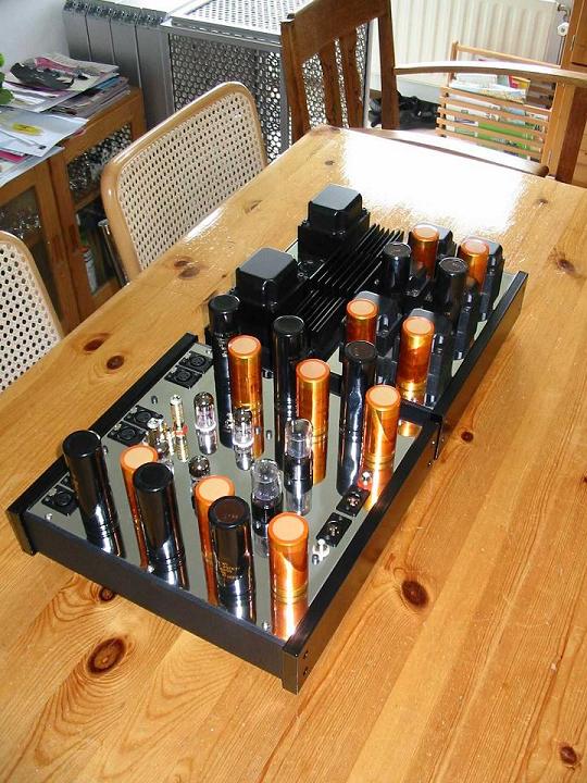

So here's a picture of my phonostage. Maybe your ultimate nightmare......but let me assure you: it's a good sounding nightmare !
Some data:
- external power supply
- 6C45 as first stage
- passive RIAA
- 6C45 as second stage
- interstage (not very common in a phonostage)
- 6SN7 as output tube ( ,, )
- output transformer ( ,, )
Yes: the 6C45/riaa-combination was enough gain, but with the interstage/6SN7/opt combination added i was able to run long cables AND searching for a optimum sound-combination cartridge and phonostage.
Still friends ?
Now back to the 833-issue. Currently i'm experimenting with tube rings on my tubes. You can see them in a earlier post on the 6SN7. But i'm going to extend that to the 833. I'll post the results in this thread. Did you have done some microphonic-experimenting ?
With regards,
Reinout
(seriously impressed with your pre-amp !)

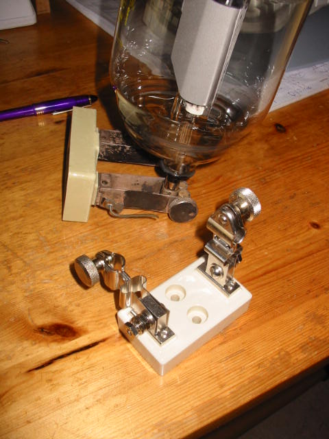

Back to the tube sockets. I am happy to have found a pair. But asking for 4 for your PP-design is pushing. But i will be on the look-out for you (and all other 833-builders).
There are 2 varieties of sockets:
- the Johnson. Altough a rather simple clamping-system the mounting can be swiffeled 90 degrees ! And that is very handy indeed. The ceramic base can be fixed to a wall or base (horizontal or vertical) and the tube can be how YOU want it ! Which is in almost all designs standing proudly vertical. I'm going to post a picture some post from now which is absolutely NOT good. And that's even a commercial item.
- The RCA and ITT. Their clamping system is more sophisticated, but the whole tube socket is fixed....so less flexible in your design.
Enclosed is a picture of a ITT (=fixed) socket and a Johnson with one of the filament clamps 90-degrees swiffeled as an example.

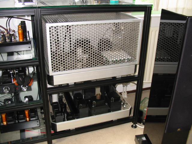

safety cage
For security reasons when "new" children are entering or when the experienced "free-education" by their parents.....i put the safety cage in place.
Of course you lose a lot of optic impact. But it still sounds good and there are no fried children in you house.

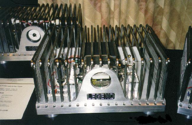

Hi all,
when reading the 833 tube data:
"type 833A requires special mounting and may be operated in vertical position with filemant end up or down, or in horixontal position with all terminals in the same vertical plane".
Very clea, i thought. So i was very surprised to see the Legend 200Se (so a 200 Watt SE 833-based amp). Although nice in set up:
- external power supply with 866's;
- nice lay out;
the 833 is lying horizontal BUT WRONG !!!!! (see picture). The tube data specifically tells you that all the terminals have to be in the same vertical plane. Which is logically: the filaments will expand during "on" and are in the Legend-case prone to actually touch the gridwire. and that will have a funny effect.
When i contacted the Legend-manufacturor about this there was total silence.......

Hello Reinout,
Forget Legend Audio! Their 200W 833AE amp is a joke. It was meant for display only to get free puplicity for their line of product. Their last display at San Francisco Stereophile show was an amplifier with the tube submerge in water! Of course DIY knows that was another joke, their amp never made any sound. If you ask to purchase their amp, they never is available.
Only tube builder know how to align the filament when the tube is mounted in horizontal position.

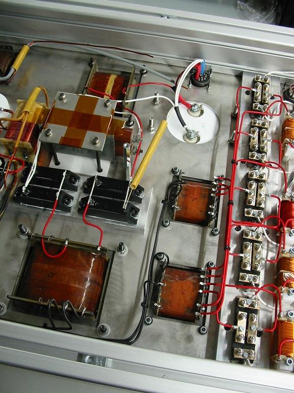

Hello Reinout,
Back to the 833A again, did you ever thought of building a Parafeed 833A using PP output transformer? I have a nice pair of Tamura 2012 5K PP 100 watts and I would like to hear some feedback of Parafeed amp builder using PP xformer. The SE transformer that I have do not perform very well if the bias current is high in the bass, my guess is that the core is starting to saturate and the Inductance is not efficient.
parafeed opt
Hello Unison845,
just spotted the pictures of the Legend. i never seen them "live". And with your comments: nobody heared them playing at all. What a fraud !! Trying to lure possible customers to you with non-functioning items. But now i do understand why i never got an answer from them !
About the opt:
- a SE opt has a air-gap in order to resist the saturation which is bound to happen with the continiously presence of DC. Simplified: a SE opt is chopped in 2 pieces so that the saturation level never will take place. That's why a SE opt has to be so extrmely well designed. For it will be "chopped" on purpose and still has to function ! No small feat.
- a PP opt has no DC (te be more correct: cancelled out), so there is no need for an air-gap. In these opt's the laminations are optimally used. Purely theoretical a PP opt is more efficient given its weight. The "problem" of PP is the introduction of a splitter, etc. But NOT the opt !
- a parafeed, or in my case ultra-parafeed also does not see DC in it's opt. Not by cancelling out as PP does, but by using a plate choke. The result is the same.
So i would certainly take the Tamura PP opt.
That the SE opt you've used does not "sound" nice is not because of core saturation. In a (ultra-)parafeed there is near zero DC-flux across the opt...so the basis of saturation is missing. And even if there was some DC....the airgap would prevent saturation.
What can be possible is indeed the Henry-item you already mentioned. The SE airgap does introduce a lot of Henrys..... And the SE opt is by definition a chopped up device trying to be as good as it can: but is is split/chopped/not-optimal.
So when going for (ultra-)parafeed stick to PP opt's and/or go all the way and chose really sensitive laminations like permalloy for there is almost nothing to saturate. You'll get the super-detail form the high nickel content core.
For there was not very much available when i did my 833-amps, i chose classic M6X. Nice and stable. Off course there is better (read: more sensitive), but it is sufficient for now. Maybe when finding very large permalloy laminations or something like that i'll switch to more exotic metals. Now it is a E126 opt. I have the opt been layered with kapton-foil. A very nice electrical insulating foil which is "safe" up to 8 kV ! More than spare.....
And because the theory does say....."near-zero" DC-flux i had a micro air-gap been placed just to be on the safe side. Now i've built and measured the amp.....i would not make that micro air-gap again and go for a PP-opt with fully interleaved laminations.
If you don't use the Tamura's.....i'm interested in them. does that says enough ?!

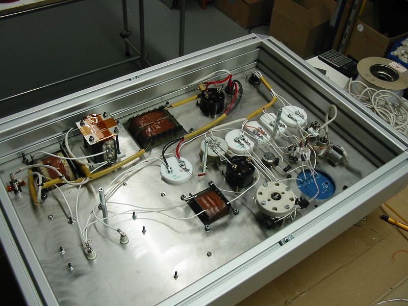

Included a picture of the innards of the amp. The opt is in the left upper corner. The E150 plate choke is in the top/middle. The small E96 transformer in the middle of the amp is the 300B-833 interstage.
With regards,
Reinout
Hi Reinout,
is the paper in oil cap between choke/transformer the parafeed coupling cap?
What value? and did you try others? 😀
what's the inductance for the choke?
That coupling cap is what I find the - point of parafeed, it's easier to find a high power pp transformer, and a high current choke too, compared with a high power, high current, high inductance SE transfromer.
BUT you need to use a capacitor to remove the dc for the output transformer. And in this case a very high voltage one, so there isn't much choice/availability as compared to 300b parafeed's.
I still have a couple of big russian pio's, 4uF, 1600v rated.
They would work well in this position, but I have no idea if they sound well.
Filip.
