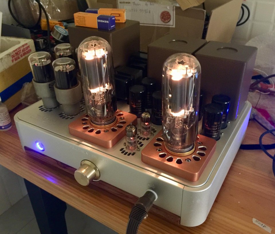

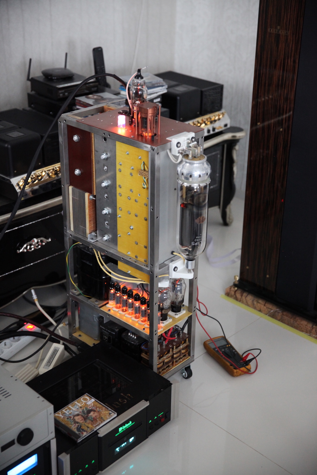

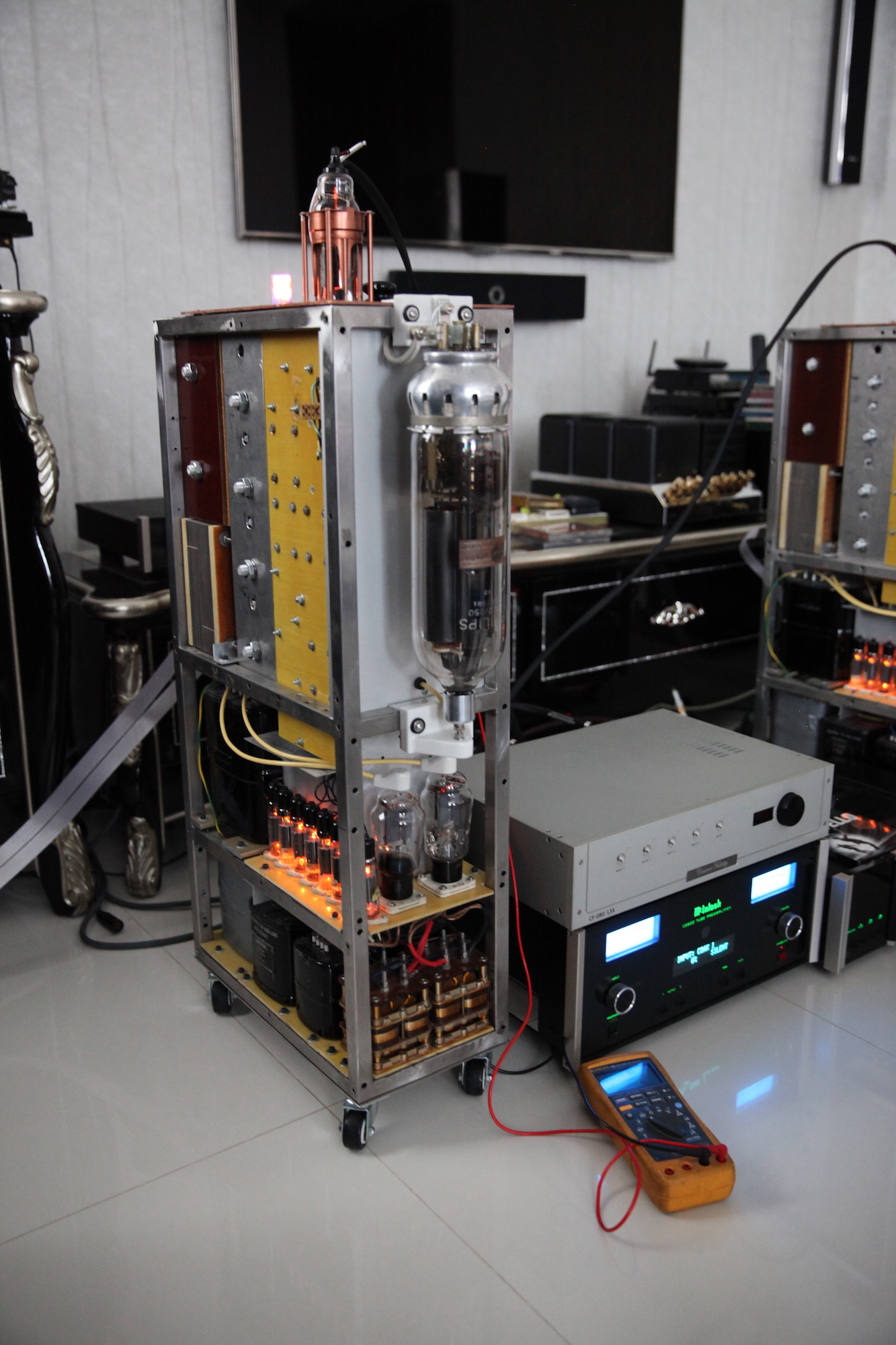

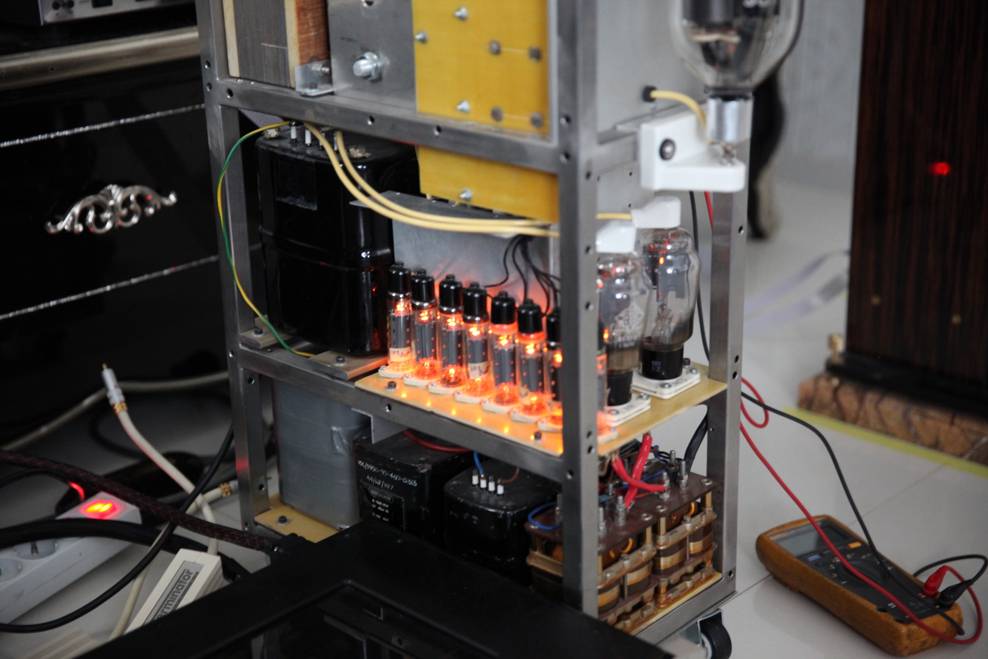

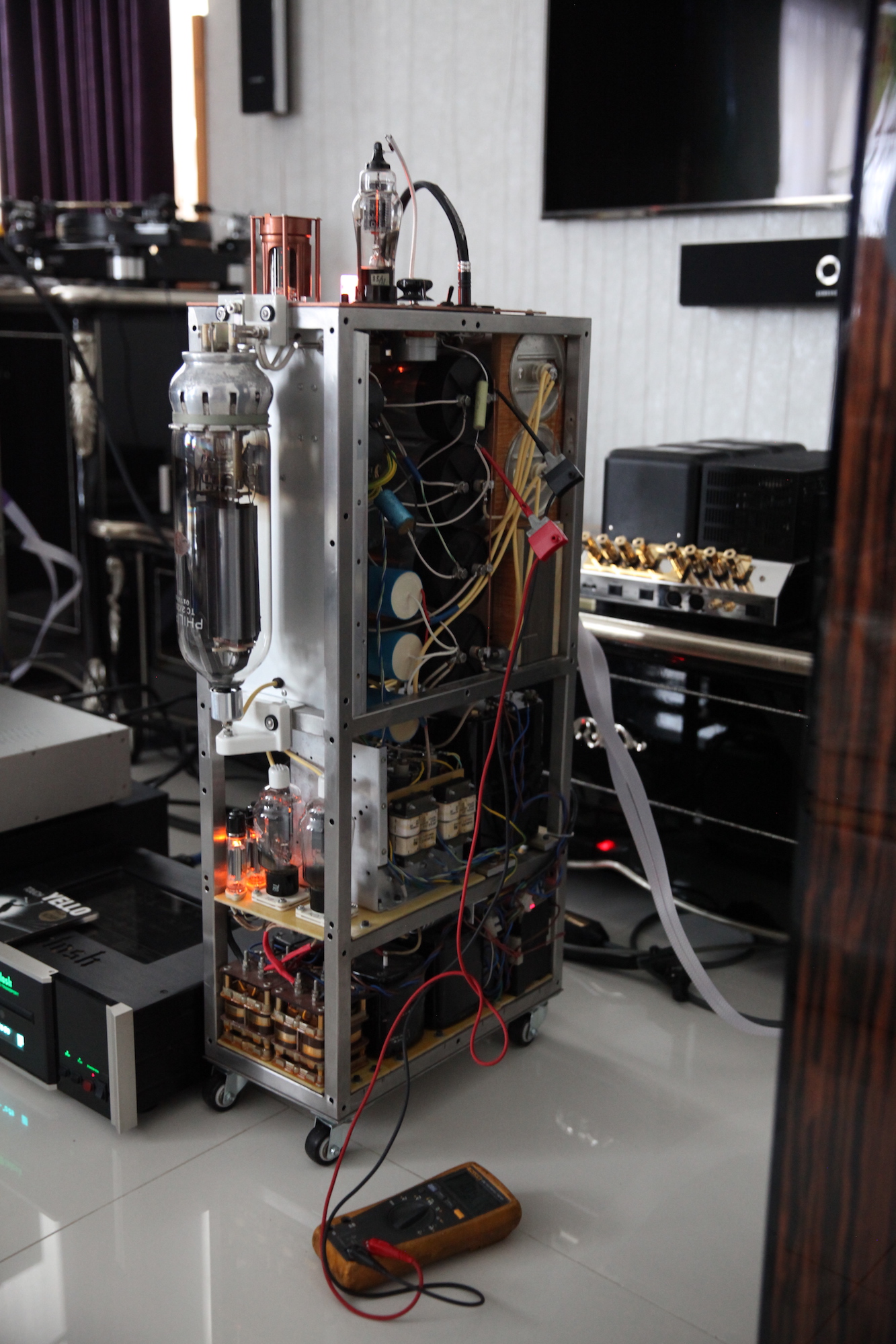

Present project based on vintage power tubes.
833a can be used instead with correlation of sockets, but I like old Philips better 🙂

Those pictures are excelsior! For those of you who might like the build an 833A SET: The 833A Single Ended Triode Amplfier - YouTube They are not very difficult to build and if you already have a 2A3 or 45 SET or even a 300B which you like you can transformer couple it to the grid of the 833A.
Yes indeed, my first iteration of 833a (GU-48) was driven by a KT66 (as a triode) single ended amplifier and transformer coupled.
Currently I'm rebuilding the amps and will be driving the 833a grid with a solid state stage (similar to power drive) with a 112a front end transformer coupled.
It'll get finished one day.

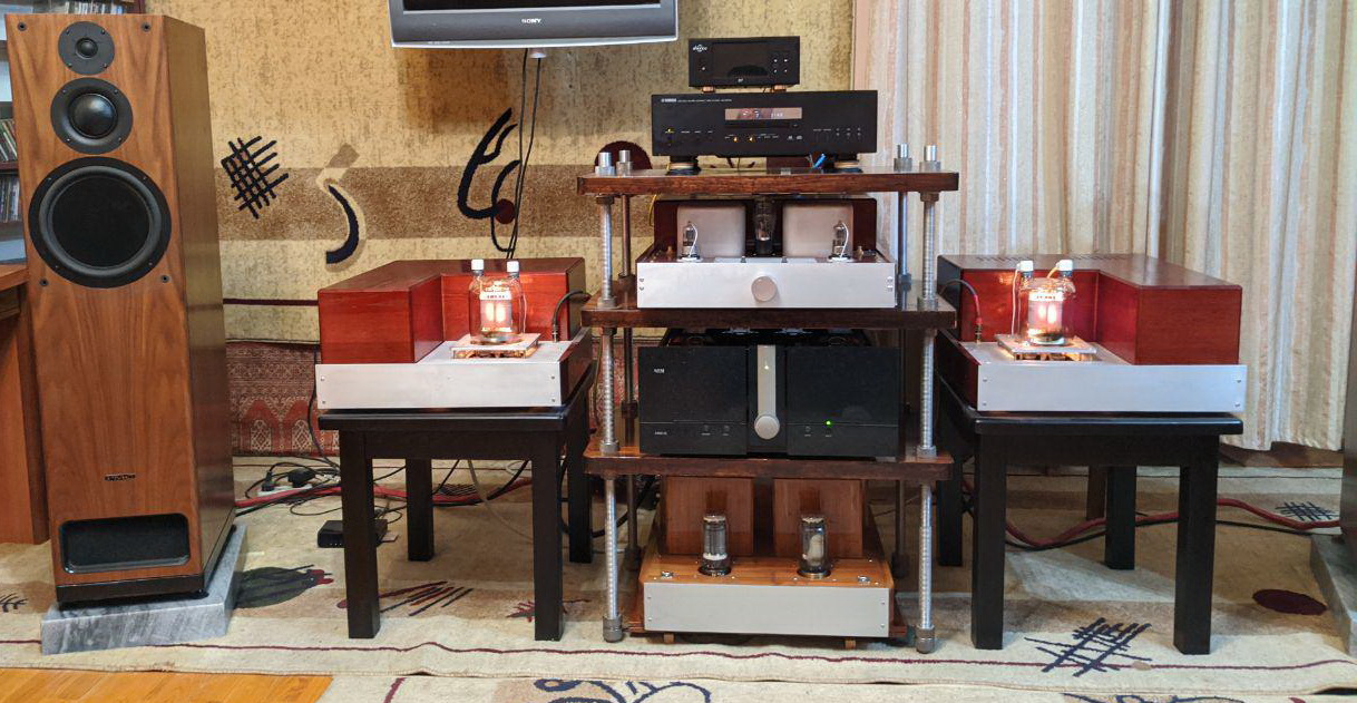

As far as I can tell, I think I have solved any problems I encountered getting my 833A stereo to work. I really like the sound of it and I over-designed everything I used which has worked for three years. That is not to say I did not have to experiment with such things as parallel feed vs normal transformers for the 45 to drive the 833A grid and redesigning the power supply so the chokes would be on the negative side for safety and going with polypropylene filter capacitors instead of messing with electrolytic capacitors in series for the 1000 Volts I like on the tubes.
Does that mean the 833A is the one true faith against which everyone who takes a difference in an infidel? Of course not. But building the 833A is not as difficult as many people think.
