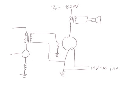

Thank you and in your schematic i found you used 10v/10A
as the power supply ,is it enough to deliver the juice for 833A.
and my plan will use we417A as a driver then via interstage NC-20F then feed thru 300B then interstage 4:1 thru 833A just like you...Question come in my mine is that do i need to use the cathode resistor and cathode capacitor for 833A.

I drive my 833s from the output transformer (speaker terminals) of my 2W PX4 SE mono blocks. I have also driven it from a 1W 6EM7 amp. Both work well.
The 833s are run at 0V grid bias A2, ie no cathode resistor or cap.
I tried a cathode resistor biased at 90V but it sounded the same.
You need very little to setup an 833, apart fron the PS that is.

I think for 88db speakers you are going to want lower ratio interstage transformers?
I'm using 3k/8R SE output trans and my system goes very loud. These work out to approx 20:1 ratio.
I would suggest somewhere between 4:1-10:1 ratios depending on your needs.
But try it with what you have first. You may be surprised

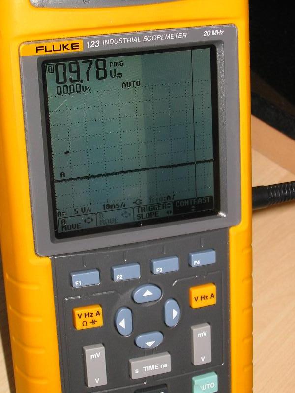

Just cranked up the anode voltage to 1100 V (220 mA) and it works GREAT. The music simply flows.....and the more reddish anode coloration is a nice extra......
I hooked my Fluke Scopemeter at the filaments (DC !) with the tester set at AC + DC. Result: 9,78 VDC and look at that ripple......where ?!
Maybe one of the reasons why the amp is so silent. And i mean in the music: when there is a silence required....there is SILENCE. No hum whatsoever.

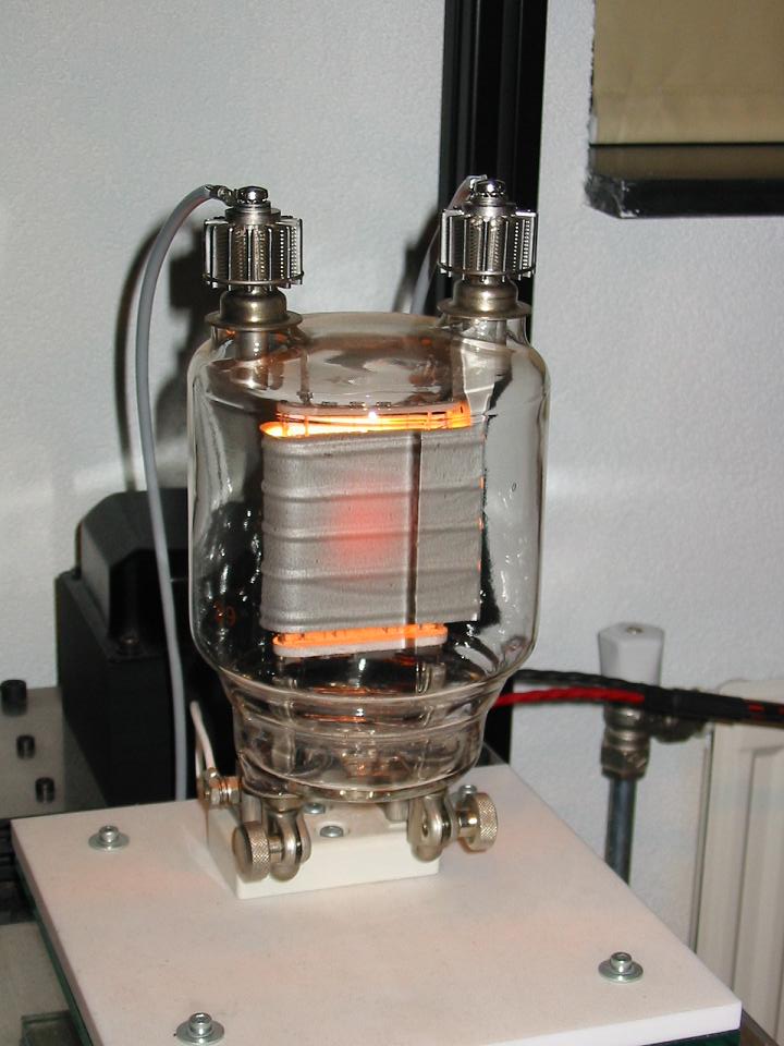

Also scored some great topcaps; very retro. Stainless steel convection warmth dissipation caps. I found them in a dumpstore; never seen them before.
And now for my next change.....i'm going to use the Philips TB 3/1000. An European forerunner of the 833. I'll keep you posted.

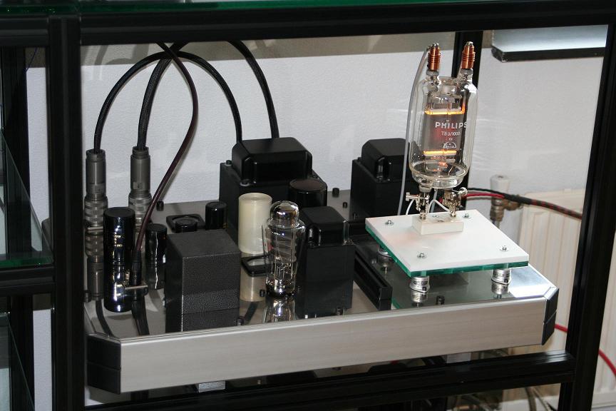

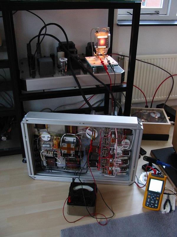

Hello Ranger,
the schematic was already earlier in this thread.
Today i changed only the powertriode. It is no more an 833A but an TB 3/1000. With that triode i started another thread.
The schematic remains the same.
You're planning for something like this ?
Regards, Reinout
(included a picture of the current stus: EML-300B as a driver; TB 3/1000 as output device)

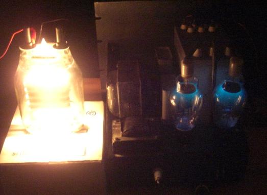

korneluk said:My two favorite kinds - blue mercury glow and thoriated orange glow. Just a little teaser shot before the holidays...
Enjoy,
-- josé k.
