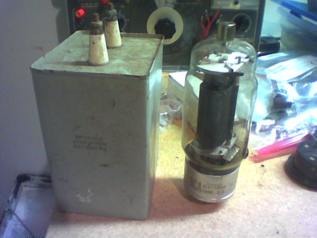

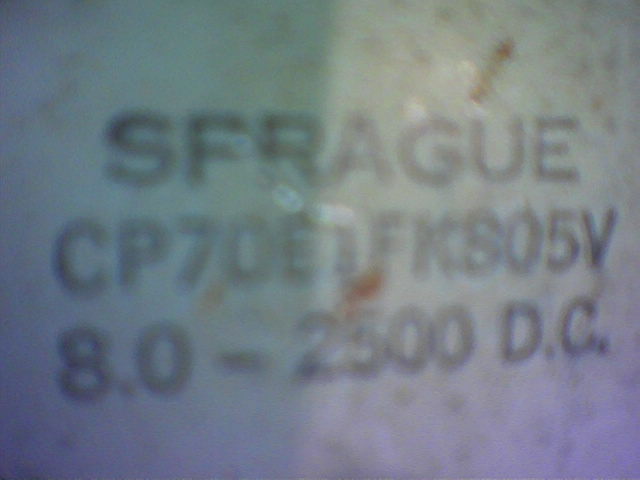

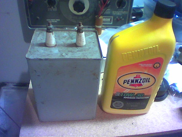

The Motorola base station power supply had a few oil filled 2500 volt caps on it which was not enough to handle the current drawn when driving the amp with a low frequency tone.
Look at the first picture of the "breadboard" on my web site. To the left of the current meter, behind the 833A is a large oil filled capacitor, 16uF 7500 volt. It came from an old cardiac defibrillator unit. It is still not quite large enough to handle the current drawn under low frequency operation. Caps of this size can be found in the surplus market, although some may contain toxic substances. You can still but them new but they are several hundred dollars each!
This is again one of those cases where "specialized" components are required. If considering an amp of this magnitude, consult an older ham radio operator who built high power vacuum tube transmitters "back in the good old days" This is flea power to them. The old ARRL handbooks (up to the early 1980's) had detailed plans to build these monsters. I built a 1 KW transmitter in the 1970's.
