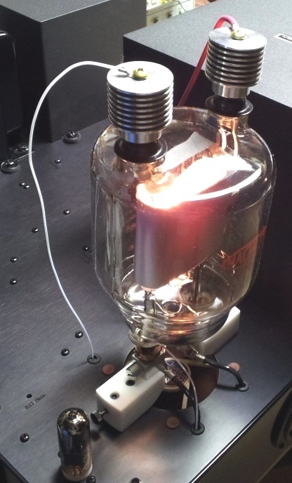

NickC: your right about the open structure of the tube socket. It is rather exposed. Nonetheless the anode-connection with 1000 V (in my case) is more a problem. A standard topcap will fit perfectly for the wire, but a part of the connection (metal !) is still exposed. Although the heat of the tube will certainly make you think twice of touching it........can you take the risk with children ? That's why i've build an open frame with ventilation holes in it. If there are visitors with children i simply install the frame. The tube cn still loose it's heat but the holes are to small for even tiny fingers to touch the 833 at all. It works but i do not like it; so now i'm experimenting with a teflon pipe that slides over the top cap. If i'm happy with it i'll post a picture. Now you have to do with the frame-solution (picture in next post).
Back to the tube sockets. I am happy to have found a pair. But asking for 4 for your PP-design is pushing. But i will be on the look-out for you (and all other 833-builders).
There are 2 varieties of sockets:
- the Johnson. Altough a rather simple clamping-system the mounting can be swiffeled 90 degrees ! And that is very handy indeed. The ceramic base can be fixed to a wall or base (horizontal or vertical) and the tube can be how YOU want it ! Which is in almost all designs standing proudly vertical. I'm going to post a picture some post from now which is absolutely NOT good. And that's even a commercial item.
- The RCA and ITT. Their clamping system is more sophisticated, but the whole tube socket is fixed....so less flexible in your design.
Enclosed is a picture of a ITT (=fixed) socket and a Johnson with one of the filament clamps 90-degrees swiffeled as an example.

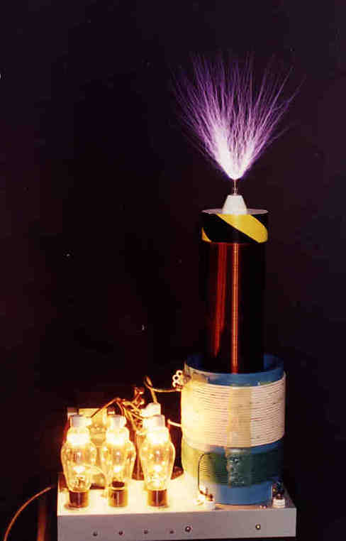

Hi all,
so if your 833-based amp fails you can always built your own tesla coil with it.

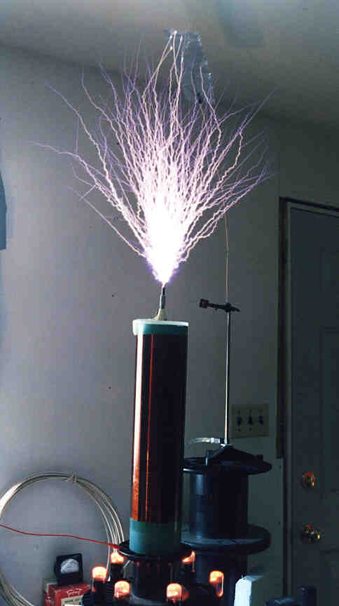

No....this is not at my house; my 833's are up and running with music. I found these pictures surfing across the web. Still interesting: again the "spot" on the anode is clearly visible.
What kind of amp would this be ? Class Z ?
Reinout

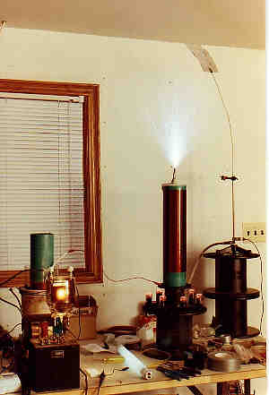

Reinout,
You managed to find photos of my 833A 'magnifying transmitter' type Tesla coil from a lab bench experiment in the late 1990's. The HV resonator coil does not sit inside a conventional primary coil but is bottom end fed by a clip lead wire visible in the photo. I sprinkled some WE313C neon triodes with the black paint removed around the plastic wire spool base to show the presence of the HF HV field. The discharge is 22" long. This power oscillator operates the triode in Class-C. A large MOT (Microwave Oven Transformer) with SS doubler diode working with the 833A as the 'other diode', puts about 4 kVDC on the 833A anode. I made a previous coil system using three 810's in parallel and this single 833A circuit completely kicked it's butt in discharge spark length utilyzing a somewhat smaller HV resonator as well!
Also shown is a coil I made with four parallelled 811A's. Similar HV resonator. The 811A is NOT a beefy enough tube for such application. Save them for the old Altec theater amplifiers that used them. In the amp app they won't melt out their grids. IMO, the 833C is the best triode for homebrew Tesla coils. Parallel as many as you need!

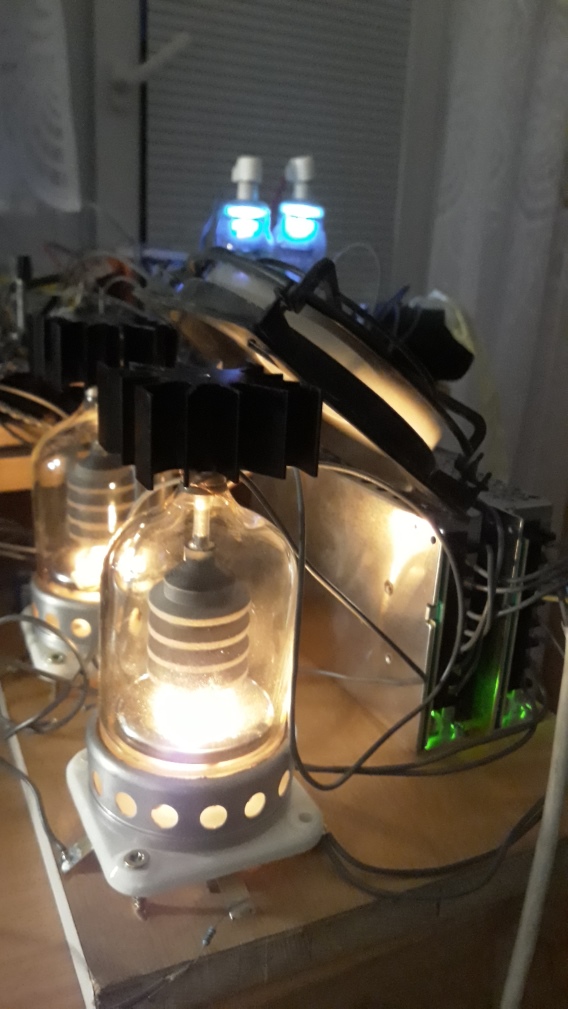

I gave up on finding the Johnson sockets and just made my own from scrap teflon and aluminum lugs from Home Depot, like these:
Blackburn #1/0 Stranded Max Type ADR 2-Conductor 1-Hole Dual-Rated Lug-ADR11-B1-5 - The Home Depot
They have a couple different sizes, I used the one that fit the 833 legs best. Works like a charm.
I thought I might have an issue with expansion and contraction but it seems the teflon is pliable enough and allows enough wiggle that it isn't an issue. More than two years now with no problems.

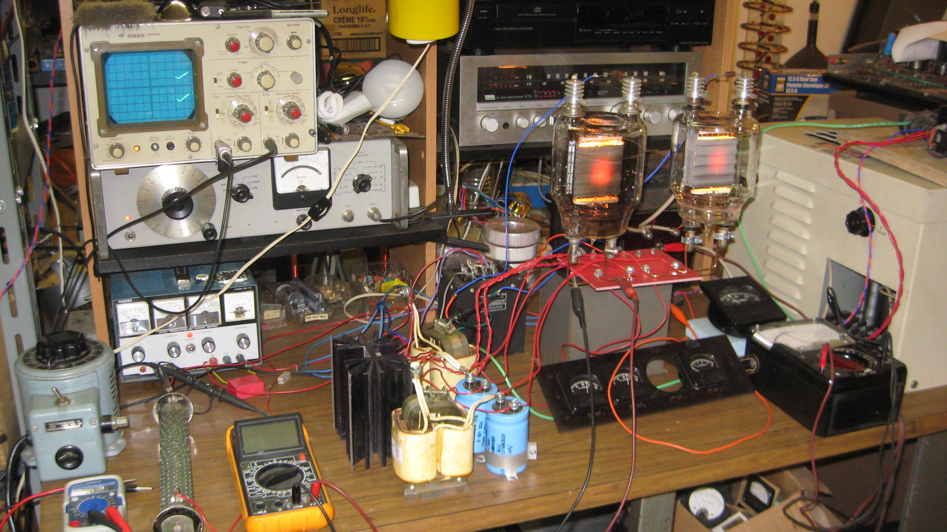

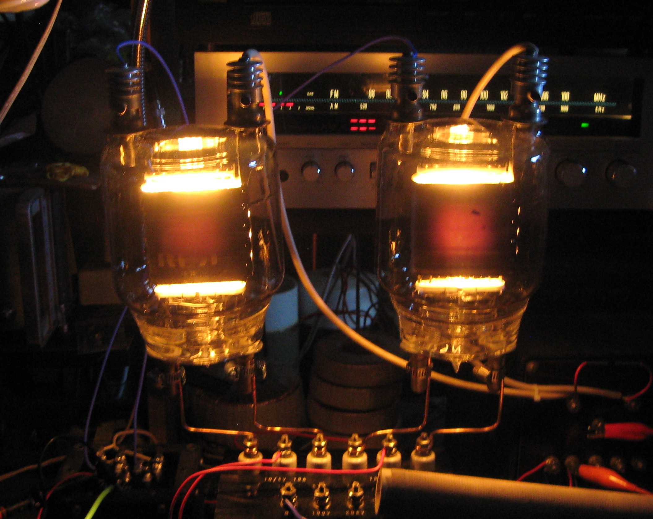

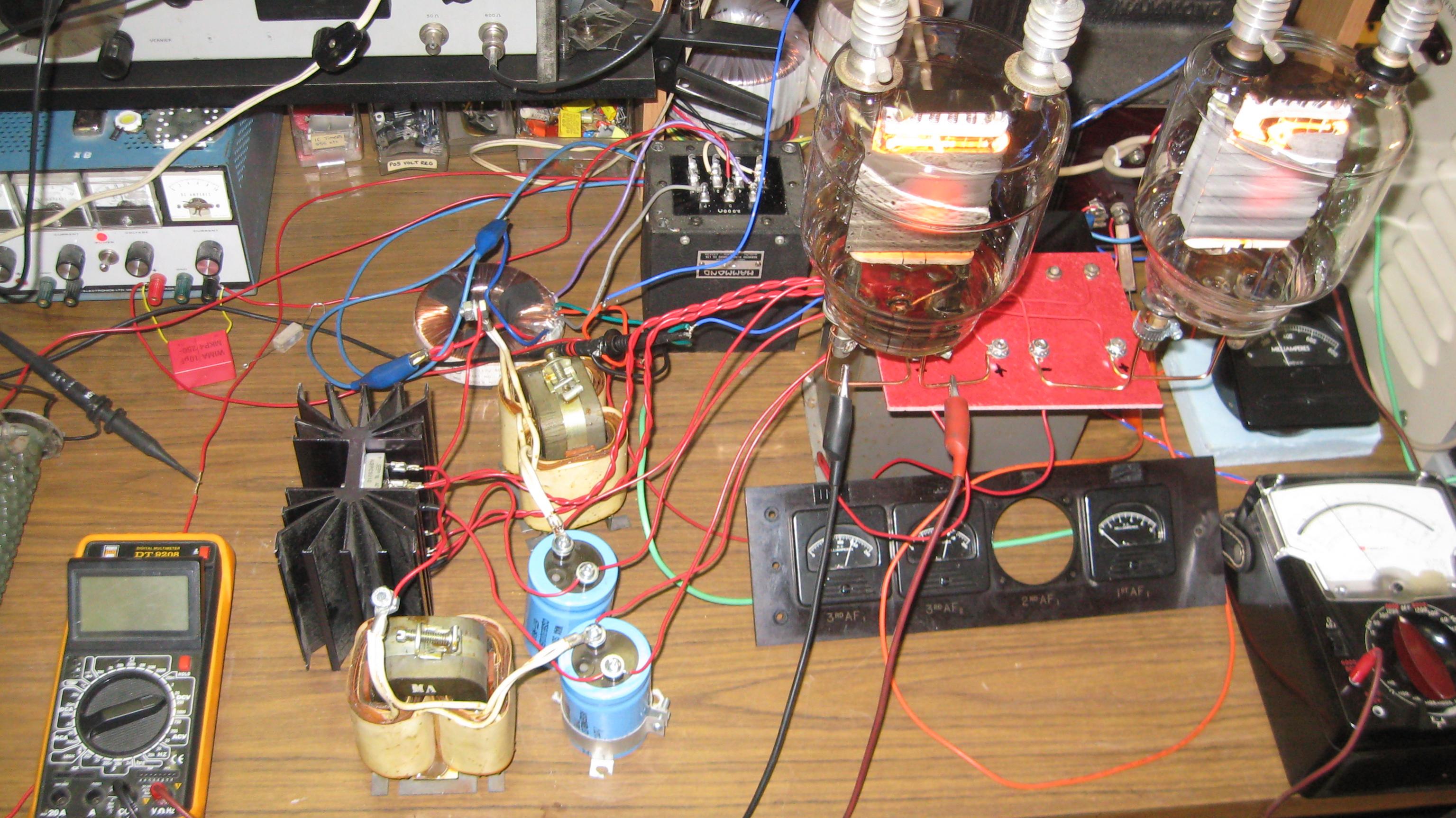

833A in P-P
I had the idea of using a pair of 450TH's in P-P as a subwoofer mono amp. I have decided that this is not really practical, especially given the cost of this tube and the high voltage it needs to output the kind of power I was after. The repurposed Hammond plate xfmer I was hoping to use as output iron was not insulated sufficiently for the application. I don't want to subject it to more than about 2 kVDC.
I have decided that if this is to end up being built at all, it will be with 833A's instead.
I have built up enough of a test circuit on the lab bench to determine a few things. First, smooth DC at 10 VDC is absolutely necessary for the filaments to avoid hum.
Here is my test setup with 1800 VDC on the plates and 140 mA anode current each tube. I was getting about 550 watts RMS out into an 8 ohm resistive test load before I ran out of grid drive. I was using a low power SS receiver with speaker terminals driving a backwards P-P output xfmer as the P-P grid drive. I have been using about 25 or 30 VDC negative grid bias. Less and the plates will melt at this anode voltage. Since the last experiment I have replaced the receiver with a powerful 100 watt/channel Technics but need to experiment with the drive circuit yet.
From 20 Hz to about 13KHz this actually sounds pretty good. To get the response flattened out and improve the sound I am running some NFB derived by a torroidal power xfmer driven from the audio output to impress NFB on the 833A grids. A bit of NFB really improved the sound and character of the amp. Remember, I'm using an ancient 25 Hz plate xfmer from a prewar RCA AT-3 HF transmitter as an output xfmer here. This shouldn't sound as good as it does. I tested about half a dozen plate xfmers for this duty and they all sounded horrible, except this particular hard to find treasure. Since first posting about this I have acquired the other AT-3 plate transformer that was still existent on the planet, so now I have a pair and could build a stereo pair of monoblocks. Fortunately I have a large junk box containing many precious HV tube components from a pair of RCA BTA-10K AM broadcast xmitters that I acquired and parted out years ago. Don't need to spend money in order to do development work. Good thing since these parts are now so pricey and money is one thing I ain't got any of.
This is an extremely back burner project after survival, so could be a while before I next get to play with it.

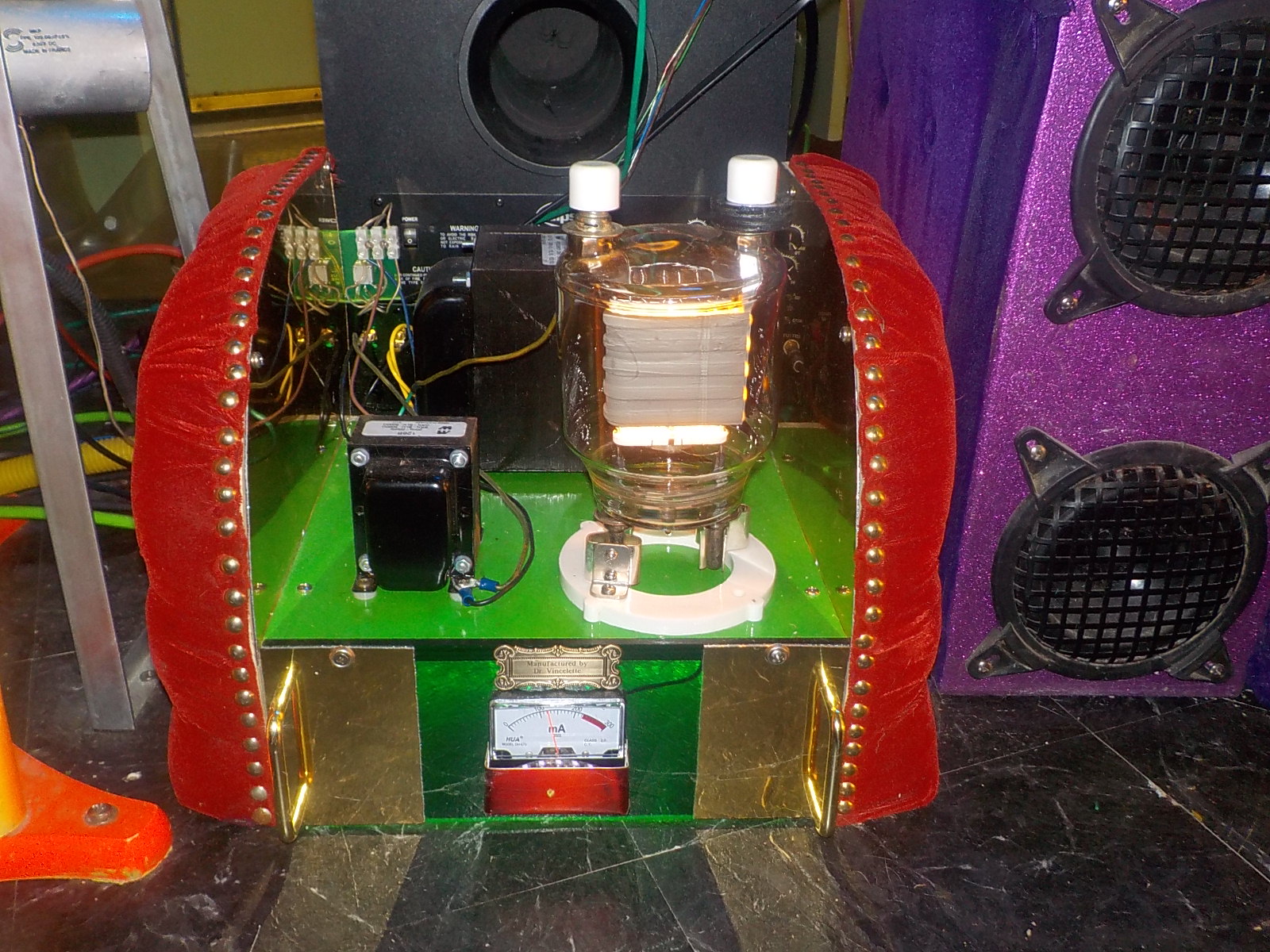

I use the 833-A at 1KV and zero grid bias. The cathode is a 20 Amp rated 10 Volt transformer, a 50 Watt rated bridge, 82,000 micro-Farads, 0.1 Ohm, and a pre-charged 4.5 Farad capacitor. I drive it with a 50 Henry choke, at least 2 micro-Farads, and an LL1930 step-down transformer 5K to the low impedance windings in series and a 45 driver tube. This gives me a full-bodied sound which I will use with Magnepan 0.7 speakers.
no 833, but graphite plate atleast 😀 the almighty QY3-125

basically, i kicked out the 2a3´s, and replaced them by these gherkin pots.
sound is wonderful.:checked:
what i found -- you can use xmitter tubes under 1kv a1, but only as low current.
amp schema (without fb driver loop):

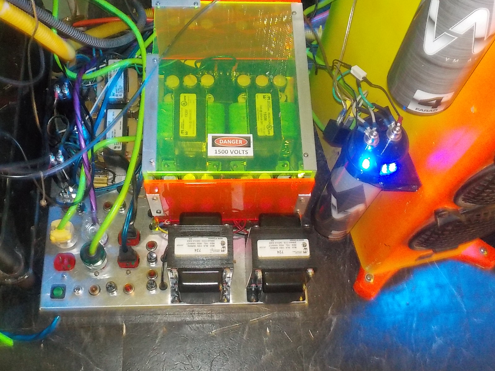

I made the power supply out of a Hammond 724 transformer and solid state fast reacting 5000 Volt rated diodes with the center tap to the transformer grounded, then I strung groups of three electrolytic capacitors rated at 600 Volts each, two gangs of 56 micro-farads per capacitor for a total of sis capacitors, followed by a Hammond 193M 10 Henry choke which I mounted inside a Plexiglas cage because it can't isolate more than 800 Volts, and followed this with two gangs of three 100 micro-farad capacitors.
