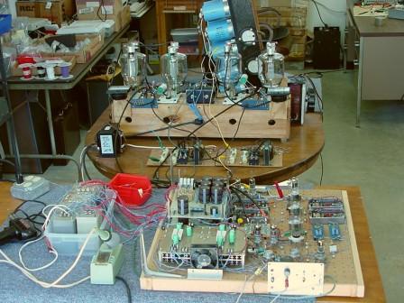

I will post pictures of the breadboard version only for now. The final configuration is a stereo pair housed in half-height rack chassis, one chassis per channel. A glass enclosure will keep fingers away from high voltages, and act as a plenum for forced air cooling, required due to eight 833s in the room dissipating 2000W. A dedicated A/C supply duct and a return duct will be routed, so that heat will not directly impact the listening room, a necessity here in Florida. However, home renovation, followed by two hurricanes, and now a move has conspired to halt final configuration progress.

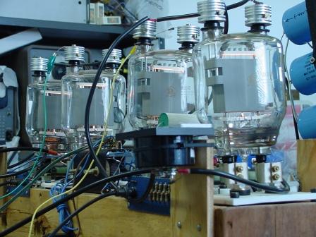

Here is one channel's worth of tubes cooking.

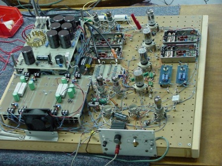

This picture shows the breadboard of one channel. The input circuits are up front; the 833s are farther back. Behind the 833s, barely visible and leaning at an angle for servicing is the +/- 4000 volt supply. The 100 lb. transformer for the HV is from a Collins T-368 transmitter. It's bigger than a car battery. I was lucky to snare a pair of these beasts.

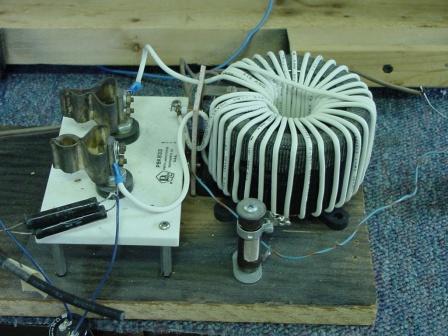

I used the cores from salvaged 300VA variacs as my filament transformers. I kept the primary intact and wound 15KV-rated silicone insulated wire around the core to achieve 10VAC at 10A for each tube. The cathodes swing at high voltages so the high voltage wire was necessary. This picture shows one such transformer connected to a test socket. The final eight filament transformers are sandwiched in a elastomeric clamping arrangment to keep the secondary windings from buzzing around.

9-pins? I experimented with various first stage configurations, trying 6922 cross-couplers, 7119 diff amps and lastly 6SN7 tubes throughout. The last choice is probably the best. The whole thing is differential from input to stators. The other 9-pin tubes are 12BY7As used for housekeeping - current sources and a pentode servo amp with controlled amounts of both common-mode and differential-mode feedback for DC stability.

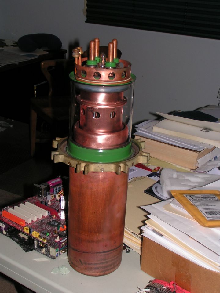

Whose tubes are those? They look like graphite plates. All of the tubes I have use metal plates.

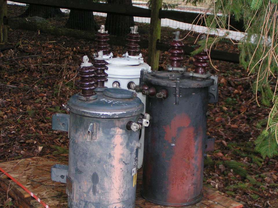

"I thought about hauling one home, until I realized that I couldn't lift it."
Thats the sticking point with pole pigs. I cant deal well with anything over about 25kVA due to weight. Ive been collecting 50amp 1156D variacs to use with pigs to avoid the costs of "plate transformers". Pigs are nice in that they can be found for a few dollars/kVA, unlike anything that involves the word "tube".
The tube on the table in the office is a GU-23A 60kW triode, its really not ideal for my purpose, especially given the iron I have on hand. If I use it, it will probably be as a linear amplifier. Im considering buying a pair of GU-39 8kW tetrodes and screen modulating them instead. As always, funding is an issue.
Brian, where did you get the heatsink topcap things for the 833As?

That tube looks like a 50 kW job. You only have 30 kVA worth of pole xfmers. Good plan. Extra tube life!
