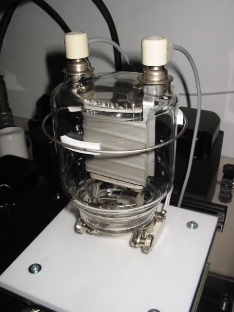

Room for modifications

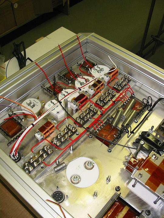

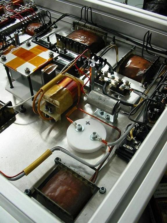

Hi Maciej,
of course you need 2 channels to get a proper sound. But what i mean to say is that my girlfriend does accept already a lot of my strange audio-hobby. She "only" asks to make the result/finished part living room-acceptable. So NO lose wires (which you don't want anyway with kV+ voltages.....). That is in my opinion a more than normal question.
In order to do so: first make the project working. Then make a nice casing WITH room for a lot of changes.
Changes in the meaning of resistors/capacitors as drop-in-replacements are never a problem. There is always room for them. Changes in a complete different set-up or really different schematic which leads to a totally different lay-out of the components:.......you left your breadboard stage too early. Am i already finished with the amps: of course not. It's part of the hobby to "search the holy grail of tube-audio" (if that already exists). But after some time i have chosen for a certain configuration + lay-out. Now that's my amplifier and i'm going to optimise that as long as it takes.
An example of optimalisation: all my powersupply transformers are winded with correction taps. They let you vary the primary windings +5% / +10%. So even with a number of different secondary taps (and i don't use many secondaries for almost every possible powerline does have it's own dedicated transformer) you can chage that within limits in order to find the optimum sweetpoint.
At the attached picture you can see a part of the powersupply. Lots of room (to be honest: i already changed a couple of transformers) and the profiles i use for the casing have a nice feature: you can bolt anything to it without tapping holes ! See also my next mail to Bas Horneman.
With regards,
Reinout

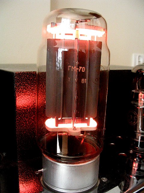

(nice picture of the GM70 !)

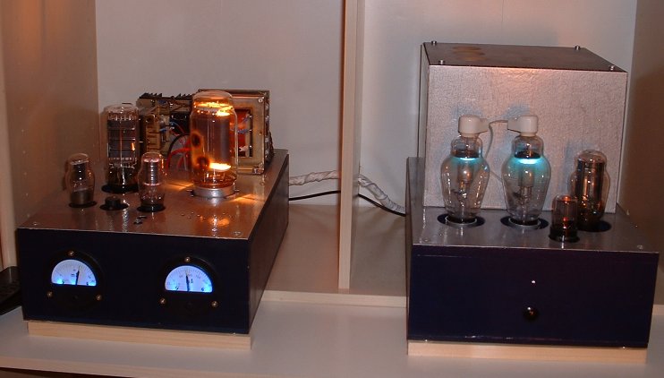

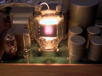

my amp
Hi Reinout,
here's a picture of one channel of my gm70 amps.
Ofcourse they can't really compare to the polished look of chrome/steel like yours or Maciej's, but not that bad.
casings are mdf, tubesockets are placed on pieces of pcb, under the wooden topplate, and on top of the mdf plate there is a thin plate of aluminium to cover all screwholes.
the transformers on the ampchassis are still waiting for a coverbox like on the powersupply. But that'll have to wait.
I'm busy on a "small" pre-amp right now.
Filip.

Hi Maciej,
the powersupply contains a 1000V supply (with mercury vapor 866's, nice lightshow in the evening), a 400v supply with 83 or equivalent (5z3 I think), and a 6x5gt for a bias supply.
and of course a bunch of filament supplys.
the inputstage for the amp is a 76 with a ccs as load, cap coupled to a 300b. the 300b is choke loaded, fixed bias. The bias suply goes through the purple glowing od3... there is a check for this voltage, if there is no bias voltage, the ht won't start and the amp shuts down completely.
the gm70 stage is auto bias with a big resistor. and 300b to gm70 is direct coupled. To allow this I stacked the whole gm70 stage on top of the lower powersupply.
The advantage of this way is that it is completely stable, if the 300b is not in it's socket, the gm70 is still completely biased.
Disadvantage is that I had to put in a mosfet regulator for the 300b voltage as to get it very solid. otherwise I would have more hum than in normal coupling, and gm70 voltage referenced to ground.
Sound? for direct reference I only have my solid state marantz receiver (sr7000), which is already very good.
But I prefer the sound of the gm70.
It gives a nicer sound to the bass, and it feels more spatial than the marantz. (when I connected the receiver back to the speakers my wife said "what did you do to the bass? it's gone. Put it back." )
I haven't heard that many tube amps to compare with, so I guess my tuning will be too "solid state" for a lot of people.
My intend in the amps, is to keep it simple, without feedback, and make it so as to have as little distortion as possible, as much bandwidth as poss. and as silent as possible.
The gm70 and 300b are excellent tubes in that respect, very easy to get good sounding results.
I feel that only after that you can start putting in "boutique" parts, like special caps/resistors.
I added a switch to dial in some feedback (about 7db I think), but I never use it. I prefer without the feedback.
Filip.

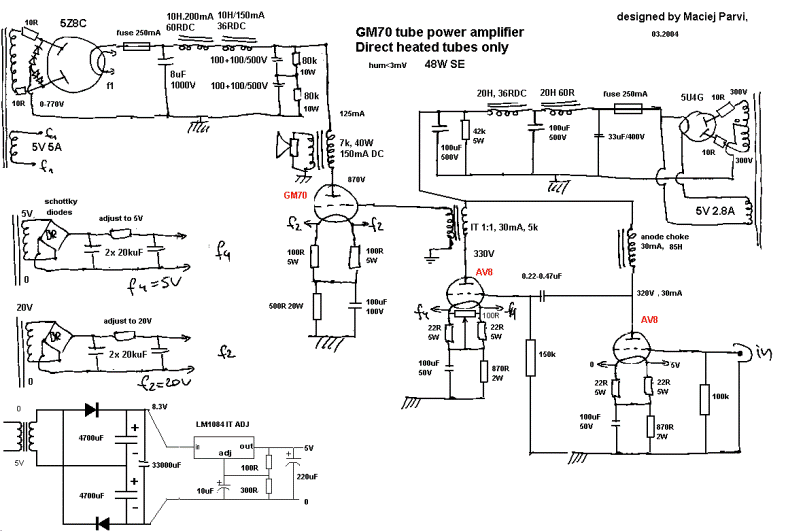

"I haven't heard that many tube amps to compare with, so I guess my tuning will be too "solid state" for a lot of people"
thanks Filip,
I think my amp is also a bit SS like. It is very detailed, very clean, sometimes a bit hard, but I prefare it to TYPICAL tube sound, fat, warm, slow. I experiment with different parts, sometimes very expensive, like BG WKZ caps , amorhphous core transformers etc.
The better parts I use, the more SS sound of the amp I get
If you have the 1000V on the GM70 anode and you have 300B driver direct coupled to GM70, you should have something like 600V on a GM70 anode/cathode only (about 350V at 300B anode and about 50V for GM70 gbias/grid).
regards
Maciej

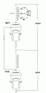

Hi Maciej,
The 1000v is stacked on top of the 350v supply.
I attached a representation to show what I mean.
This way the 300b and gm70 are direct coupled, but I can't try out fixed bias on the gm70, and instead of a coupling cap, there is a cap across the cathode bias resistor. <<sigh>> there is always a compromise somewhere.<</sigh>>
Ofcourse with an interstage I could also go A2 and use fixed bias...

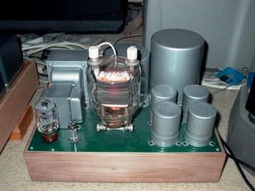

My 833A amps
All above post are very interesting regarding the 833A and GM70 amps. I would like to share my experience with the my 833A amp.
The amp configuration is 12BH7/KT66-IT/833A. I am running it at aprox. 1000V and 175ma. Power output is 65 Watts, with little change in the power supply the amp will deliver 135W/1Khz and also lots of heat. I decided to run it at 65W.
The amps are driving the JBL K2 S9500 over a year now and are quite reliable.

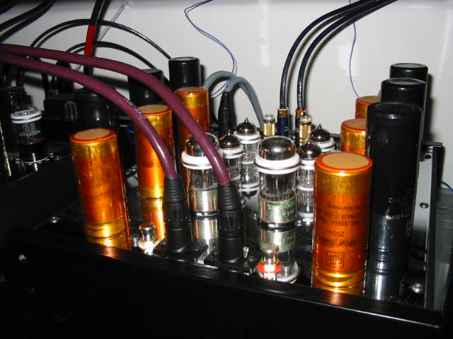

tube rings 1
Hello Unison845 and James,
first: good looking amp, Unison845. Very tight building; my girlfriend would certainly opt for the size of your 833-project !
Second: what you describe is words about the sound, i can only underline. Details, dynamic, light and airy. Not a bass-monster (but enough) and a huge soundstage.
I have a couple of types/brands of 833's and the difference is between the A and C is very small. The 833A has a bit better high; the 833C does give a better bass. But the differences are minute ! I could not chose between these 2 in sound-quality. It's a matter of taste !
Third: pure on data we are using the 833 on the same specs: 20V positive on the grid, 5K as OPT.
Fourth: in order to improve the bass i've tried to change schematics and parts with very small results. So the "house-style"/ "sonic fingerprint" of the 833 seems to be light/airy/dynamic/etc ? Not that i don't like that sound (it's very addictive), but isn't the audio-hobby not looking for the Holy Grail of heavenly sound ?
So is stumbled on accesoires. Tried power line conditioners (no effect which is not surprisingly with my PS-setup), different 833's (see earlier in this thread), different 6SN7/300B-combinations (input and driver tubes in my amp)(that brought serious changes !) and i recently came across tube dampers.
In my phonostage (picture included) they did a wonderfull job. NO, I DID NOT COMPLETELY CHANGED THE PHONOSTAGE (i hate sales-talk !), but it really brought more focus. And therefore more precise bass-perfomance. A worthwile accesoire. So more investigation in tube dampers and i tried Pearl Coolers, Herbie's, silicon rings, etc. All nice but not as good as the Duende Criature rings. Very nice made (teflon ring with titanium spring). These are simply good. And made in "my" country, The Netherlands....so at this very moment i'm running a set of prototypes on the 833. Mr Medema, owner/builder of Duende Criatura, was more than happy to accept my question of 833-rings. He did not receive that question before......funny.
The results: i already contacted the builder to secure my order of 2 rings. Prototypes are nice, but i want a 360 degree full circle ring of teflon and no small teflon pieces. Of course i'll keep you informed of the progress.
I'll post 2 pictures: one with my phonostage with the standard tube rings and one with the prototype 833 ring.

Hi all,
as promised the picture of the 833 tube ring. Remember: this is a prototype, the final ring will be a full circle of teflon clamped by a titantium C spring.
The spring works and the teflon gave no problem (even on this very hot running tube).
Looking forward to the more final rings; they should be finished in a month or so.
With regards,
Reinout
Hi all,

Hello Unison845 and Rienout,

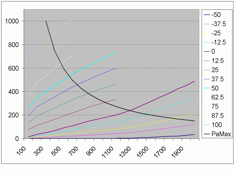

Many thanks for your answers on the Op point you are using. I'm searching for a good point for my amp. I have four 833s and I am slowly gathering all the parts I need. However now I am am a little confused about the op. point as looking at the plate curves for 1000V on the anode and +20V on the grid I make the anode current closer to 300mA rather than 175mA. ( I have included my plate curves graph that is extrapolated from the published ones). Have I made an error somewhere or is the 833 actually operating differently from the published curves? Can I ask how sure you are that the anode current is around 175mA?
The second reason for asking is that if the anode current is higher than expected by the ouput transformer then the bass response would decrease earlier than expected and you both seem to be reporting that...
I'm really not sure what output configuration and op. point to use. I'm thinking about parafeed with two 120H, 160mA chokes in parallel as anode load and a nice 6.6k push-pull output transformer instead of straight SEto cope with the static anode current. I will use a very low distortion push-pull driver stage through an IT so that the 833 dominates the distortion spectrum.
I wanted to bias the 833 in the A2 region as that looks the most linear for low level output unless one runs 2-3KV on the anode and goes for A1 - problem then is the need for a high impedance output transformer (15-20k) at relatively high anode current...
So far I thought Va=850V, Ia= 375mA and Vg=+25V looks very nice and linear and presents a pretty constant impedance to the driver stage the first half of it's swing but it is not a trivial point for the output transformer!!!
Any thoughts would be much appreciated.
thanks
James

Included a picture of my driver. It's a Valve Art 300B-98C.
