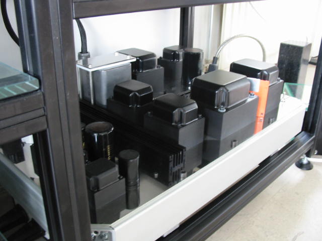

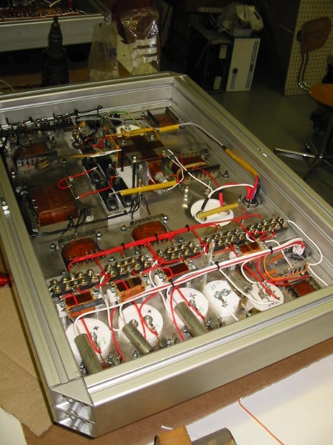

Hi Peter,
all the items on the right are "coreless coils". I'm using them after the rectification before the current dumps into the first capacitor. These coils act as very small chokes and just smooth out the current which you get with rectifiers.
A capacitor does like to see a stable current flow. So these items are just for getting the max lifetime of the caps.
The coils are in the mH-scale. I found out that the actual gain of a complete choke at that place was very small, so i stuck with the much smaller coreless coils.
Tried and tested on severall other projects: RIAA-stage (and that HAD to be "silent"), preamp, headphone-amp.
Standard my powersupply is following the next "schematic":
transformer - rectifier - snubber (get the possible spike out) - coreless coil (smoothing) - first capacitor - choke - second capacitor.
So after the combination corelss coil/capacitor there is the classic choke/capacitor combination.
I do not use drop-resitors to get a lot of different voltages from one single power line. All possibly needed voltages have their almost exclusive own powerline:
- combined transformer for filaments 6SN7/300B. After the transformers the 5 VDC and 6,3 VDC powerlines have their own rectifiers, snubbers, coils, etc.
- combined transformer for B+ 6SN7/300B. Same story. And i included the bias 300B as well.
- complete seperate transformers and powerlines for the filament and B+ of the 833. Did you expect something else with this tube ?
The reason for grouping these voltages together in seperate transfomers is that different voltages taken from one single transformer always influence each other. Sometimes more/less than other. I simply do not like to take (example) 400 V and 5 Volt out of one single unit. Grouping the filaments (5 and 6,3) or the B+ (400 and 250) together is of course a trade off. If i really wanted to be a purist i had ALL complete seperate powerlines. In my case 3 x 2 transformers extra. But i thought it was large enough already.
I'll enclose a picture of the inside of a 833-powersupply. In front you'll see the seperate powerlines for 6SN7 and 300B with the coreless coils.
Reinout

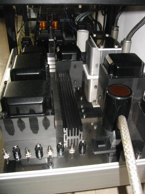

picture inside amp
and to complete the pictures here's one of the innards of the amp itself. Lots of space !
Remember that on the outside all the transformers are.
How are you all going along with all your projects ?
Reinout

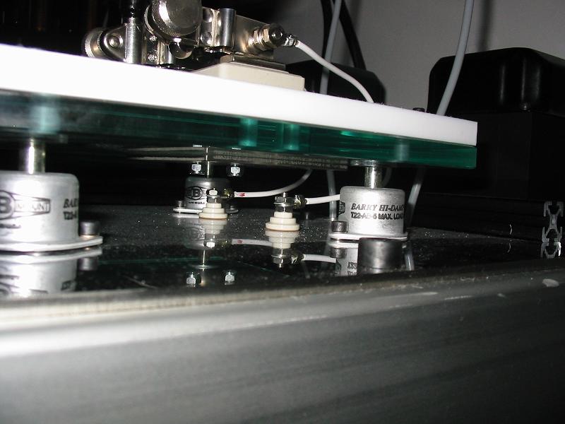

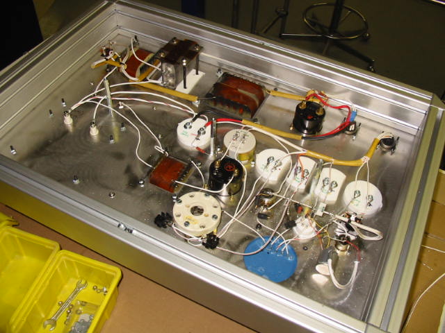

Included a picture of the feed-troughs of the 833-filaments. Becouse the 10V/10A is almost like a car battery i made the connections very sturdy. From the powersupply the connection is made through the topplate with nice ceramic feed-throughs to the tube socket.

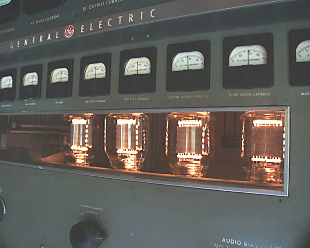

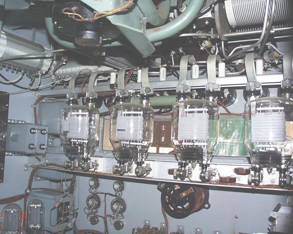

just for historical background i will post 2 pictures of a 833-transmitter (AM radio). The pictures are from a General Electric XT-1.
Of course there are more of these (the common) beasts which were capable of 1000 Watt++:
- Gates BC1-F (early 50's);
- RCA BTA -1R1 (early 60's);
Doesn't your adrenaline starts rushing ?
Reinout

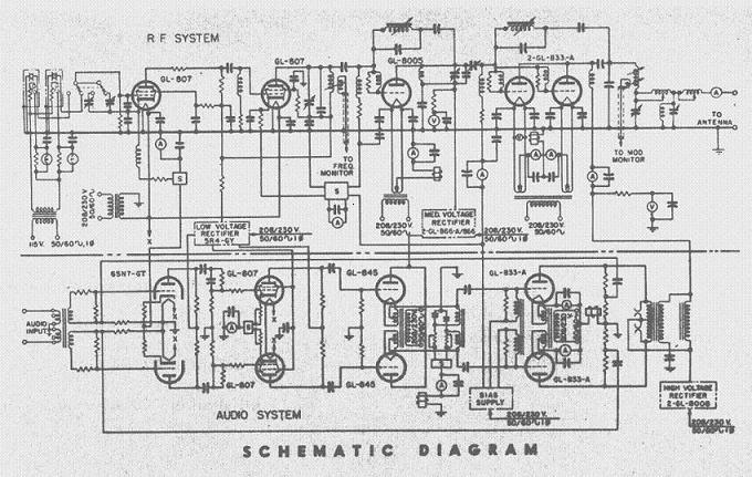

GE XT-1
Hi EC8010,
yup......those are 845's. It's a pair which form the push-pull drivers. I've attached the schematic.
EC8010: very nice tube. Difficult to source (for "normal" prices) but with a lot of potential. I was seriously considering that beauty, but stuck with the 6C45 due to it's availability.
Are you considering building a 833 based amp ?
Reinout
Wow! 845 push-pull cathode followers. Hmmm. That says a lot about how much grid current an 833 is likely to pass. I remember going to a transmitting station and seeing diagrams like that stuck on the side of the transmitters.The difficult bit was relating the diagram to the physical components. What I initially thought was an oversized filing cabinet turned out to be the modulation (output) transformer for an audio amplifier.
I wouldn't say "stuck with" 6C45 rather than EC8010, they're both very nice little valves, and the 6C45 has rather better mutual conductance (but huge production spread).
I think I have to regard 833 as impractical, but that doesn't mean I'm not full of admiration for you in making such a beast!

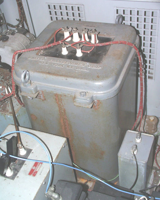

iron for a 833-transmitter
Hi EC8010,
found a picture of your 833-iron. It's a 350lbs UTC-monster from the XT-1 transmitter (UTC LS-692).
Now THAT is a serious transformer, and that is really over-the-top for audio-applications. The largest transformer i saw ever on an audio-amp were on huge Jadis-amps. If i remember correctly is was a Jadis 400 or 800 ?
I'm using a E126-size OPT. More than enough for my application.
With regards,
Reinout

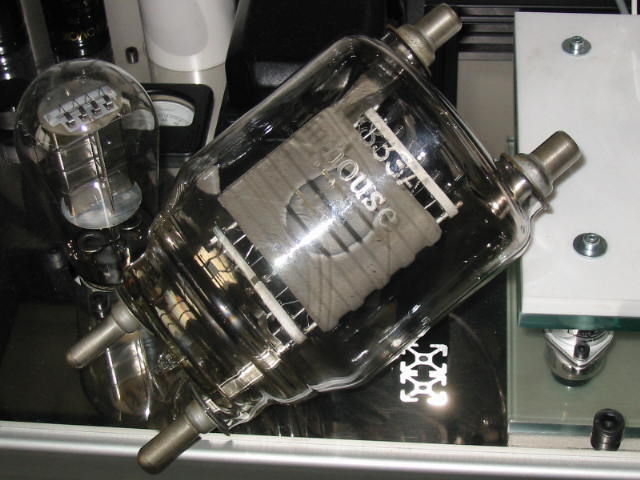

zirconium coated anode
Hi 833-fans,
if you look closely at the Westinghouse tube you can actually see some "molten stuff" on the outside of the hotspot. What is it ?!
When checking the tube manuals i've found out that (quote RCA) "the 833a has a zirconium coated anode".
So the next question: what is that stuff doing there. Happily i've found out on several sites that the zirconium is a very often used getter-material.
Several quotes form different sites:
"....example, zirconium is used on the outside of graphite or molybdenum anodes in 3-500Z and other tubes. It is the dull gray powdery or grainy texture coating you see on the surface of 3-500Z, 811A, and 572B anodes..."
"...Zirconium getters best at about 1000 degrees C, this is why large metal anode transmitting tubes like the 4-400A, 4-1000A, and 3-500Z must be operated with a dull red to red anode color. Zirconium also releases some gasses and absorbs other gasses at various temperatures. The varying temperature across the length of the anode (and as the anode heats and cools) allows the gettering agent to absorb a wide variety of gasses...."
"....The quickest way to ruin a 3-500Z, or other glass power grid tube, is to never show anode color over a prolonged period of time!..."
In practice:
- the 833A has 2 getters: one made out of zirconium and applied to the anode. It works best at higher temperatures. Tubeman (Thailand), your anode was emitting a red spot: that is EXACTLY the way to go in order to have the zirconium working as it should. The other getter is mostly a barium-derivate and applied by means of flashing like almost all tubes. The flashed getter has it's optimum at lower temperatures and does absorb other gasses.
- the 833C has only the flashed getter. The carbon anode itself functions as a getter.
Not to much theory i hope, but now i know for sure: fire up those 833's !:hot:
Attached: the correct colour......for minimum ?

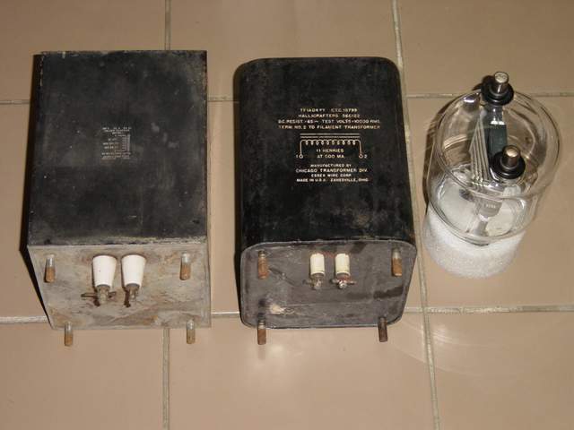

Choke for 833A power supply
Hi All , Reinout !
How are you ?
Reinout ! I just received a pair of DC Choke for the power supply
from my friend . Why it's very big choke and heavy.
The specifications from name plate are 11 Henries at 500mA ,65 ohm DCR and tested at 10,000V Rms.Manufactured by Chicago transformer USA.
It's bigger than 833A tube and I show you at a picture.
Can I use it for 833A power supply ?
thank you!
tubeman (Thailand)
Long live the weight-factor !
Hi Tubeman,
those are serious hunks of iron ! Congratulations, they should help to have a very smooth high voltage for your project.
What i really like:
- nicely low DCR;
- 500 mA.....more than enough with spare;
- nice cases. And even sometimes these older stuff had a mumetal inner-lining which surpressed stray fields. I don't know if these have that.....but they sure look like "USE ME";
Questions:
- i see that there are 2 different chokes ? Or do you have the ultimate luxery that you have 2 of both of them. Just for the looks it would be nice to have identical chokes. And of course for the metalwork on the topplates.
- 10 kV test voltage. Sufficent......but what is the continous rating ? I know a lot of transformers which can withstand peakvoltages of several kV's, but their rating is only in the hundreds of volts. Please check if they are within your working range.
Chicago Transformer USA is a well respected firm which manufactured a lot of trannies for transmitting use. Open any of the older large (military) transmitters and don't be surprised if you spot UTC or Chicago Transformer stuff. On Ebey they sometimes pop up, but with prohibitive pricing. And even with a high figure pricing.....to be honest.....my new-made chokes were not for free.......
About my chokes and transformers. They are newly made, so no "respectable goodies with history". But i had the advantage to use more modern material. Normally between windings in transformers Kraft-paper is used to isolate the windings. With higher quality stuff the transformer is impegnated in oil/laquer. Very high quality stuff has the impregnation done under vacuum in order that the oil really reaches the innards of the coil. After that the oil must be hardened in an oven for hours. By means of this routine the windings are REALLY mechanical tight so they will not buzzzzzzz......
Lesser quality transformers do not impregnate at all, or use a simple laquer-spray on the outside (of no use at all).
The Kraft-paper has the nice advantage that it absorbs some oil. And during the hardening process the paper doubles as isolator and as a mechanical strengthening.
The paper is comperatively thick and can "only" withstand 1 kV. Of course that's an average and completely dependand on the brand/type. If you need the withstand more than 1 kV the solution is simple: more paper which now becomes really thick. But putting more (necessary) paper means less space for the copper windings itself. and you simply NEED a certain amount of turns to reach your desired goal (Henrys in chokes or impendance/ratio's in transformers). With less space that will mean: thinner wire. And that is to be avoided ! with thinner wire you'll get a higher DCR or the wire can not withstand the current you want to pass through them.
Solutions:
- thicker core.....more space....see your own chokes. The obvious solution but the will weigh more / use more place / are expensive.
- better isolation material. I've found Kapton-foil. That can withstand 7.5 kV (brand/type-dependand), can be oven-hardened and is very thin.
I spotted a nice roll of that stuff on Ebay. Now i use a mix of Kraft-paper and Kapton with good results. So my transformers and chokes are comperatively small for their ratings (see picture...i've put a floppy for reference next to the HV-tranny.
But whatever you do: when using the 833 you can not build small.
Happy building,
Reinout
Hi all ! , Reinout !
Thank you for your information.
I have only 2 Choke in the picture but same specification ( 11H / 500mA , 10kV )
and different cover metal . I buy it from my friend 1,000 THB/each
2 choke = 2,000 THB = 50 US$ (Not expensive) . Because in Thailand has second hands market for old equipment, old radio Transmitter .My problem is it's too big and heavy.
Thank you
