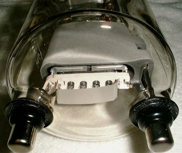

833C Details
Hi Tubeman,
nice glowing !
50 us$ for the chokes......that's incredibly cheap for such quality. Cherrish those goodies and put them to good use. And yes....i told you....it will be big and heavy. But see the bright side of it: once the amps are finished they are almost theft-proof !
I see your running now on Hytron's (thank you....another brand to collect....). I really like those older types; they have a good sound.
But if you're able to score some 833C's do not hesitate. They are very good also. And their plate really looks like it's going to survive the Third World War. Tjeeezz...that's not a graphite-anode...it's an oven.
Already any ideas about the chassis / box / topplates / looks / etc of the amplifier. Keep in mind that the transformers and chokes are seriously heavy and the topplate will be quite large. A simple 2 mm plate will NOT do unless supported.

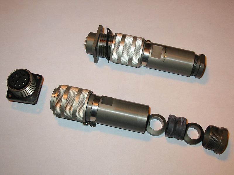

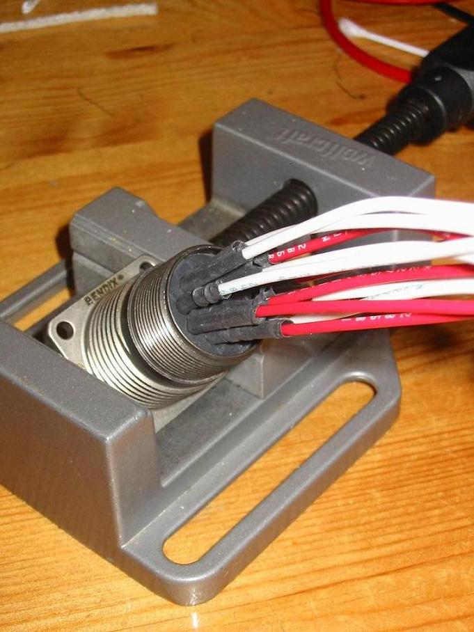

Military connectors
Hi Protos,
what do you mean:"only an 300B-amp". I think that is great, i personally like that tube very much. In my last amp as the output tube and now as a driver. Nowadays there are so many choices/flavours 300B to chose from.
The connectors: that was another great find on Ebay !
I needed high voltage connectors with enough pins for all the different voltages.
On Ebay i've found Bendix military connectors. The MIL-C-5015 (the MS3016 is another nice standard) is a good standard used by the military. There are several suppliers of this standard: Bendix, Amphenol, Array to name a few. Just follow Ebay and you'll be amazed what you can find. The trouble is to find connectors WITH their plugs. Search words: (military)(mil-spec) connectors / amphenol.
I found really nice titanium stuff.
The 6SN7 and the 300b have their own "umbillical chord" for there filaments / bias / high voltage.
The 833 has also it's own "umbillical chord" since that is or very high amperage or very high voltage. I simply did not want to mix that with the 6SN7/300B-stuff.
Anyway: forget the flimsy Hirschmann's. Nice for lower voltages, NOT for 1000 VDC.
For my phonostage i've used Neutrik 4-pin XLR's with good result. But feeding 300B-voltages through them ? I would hesitate to do that.
Hope this answers your question ?
Since i manage to add only 1 picture at the time i first will attach a picture of the actual connectors and in another mail i will continue the connector-umbillical-line story.
With regards,
Reinout

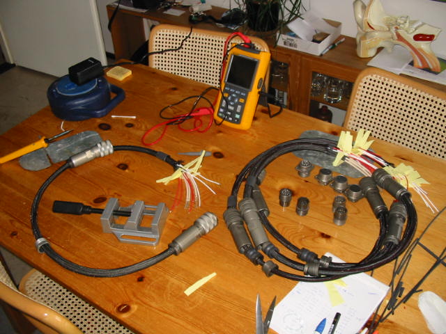

umbillical chord
Hi Protos,
as promised the continuation.
In the picture you can see the umbillical chords in the making. for wire i used teflon-insulated wire.
Again military stuff with exotic names like MIL-W-16878 or MIL-W-22759.
The types i used was a 600V-variety for the filaments 6SN7/300B/833 and a 1000V-variety for the high voltages 6SN7/300B. I know, i know......that was not really needed but i like a safety margin. The material itself is silver plated copper which is very nice soldering with !
And teflon.....it's forgiving if you accidentally touches the insulation wtih your soldering iron. Try that with PVC.....funny smell....molten insulation. You notice that already if you see the specifications of the mil-standards of the wire i used: 200 C. Now THAT is a safety margin.
For the high voltage of the 833 i used really different wire. It's also a teflon insulated wire but a special high voltage one: Sumitomo TV-20. This has a voltage rating of 20.000 volts...... And still AWG14-size (as were the earlier mentioned types) so they fitted the Bendix connectors good.
The result of using the teflon wires and the connectors is a rather stiff, but still flexible umbillical chord.
Does this answer suffice ?
Reinout
Thanks Reinout, it is very informative.I am glad you photo-diarize everything you do - amazing!Your posts are a master class.
I was looking at connectors like that at the rs catalogue but their price is a bit off putting - around 30 euro each.
I also saw that high quality computer type connectors are rated at 700V and are much cheaper.
Do you keep B+ and filaments separate?What about shielding?I can't see any in your umbilicals.Did you have any hum problems?
Hi Protos,
i made all these pictures for several reasons:
- i'll don't make a 833-amp everyday and i've made a picture album to take with me when going to an audio-show, etc.
- my insurance company had some funny questions: "what is that, proof please ?!".
I don't have any humm-problems. All my voltages are DC. Yes, also the filaments of the 6SN7/300B/833. Of course there will be some puritans who will declare me "unwise", but now i was able to get all the wires together inside 2 umbillicals without any shielding, chance on humm, etc. And it works just fine. Besides that: the 6SN7 and 300B are possible to get humm-silent on their filaments, but the 10V of the 833 will be a hard nut to crack to ge silent on AC.
The wires are soldered inside the soldercups of the connectingpins. And i've slided some heat-shrink teflon on the soldering afterwards. Nice, stable, durable, trustworthy and it looks good too !
First connector/umbillical: 6SN7 (filament / B+), 300B (filament / bias / B+).
Second connector: 833-lines
And as said: everything on DC.
You're working with the RS cataloque, i had the Farnell one. Same thing: funny pricing for the connectors. But with the 1000-1500 VDC i had no other option than to go for the milspec stuff. Only i used Ebay as a source. I believe that i had to pay 100 euro for 8 plugs/sockets (ex postage); i sourced them from Germany. Sorry, they are all used. Looking back i understand that was an incredible low price and i had to buy everything that was possible then.....
How is the your parts-gathering going on ? Tubes ? Caps ? Iron ?
With regards,
Reinout

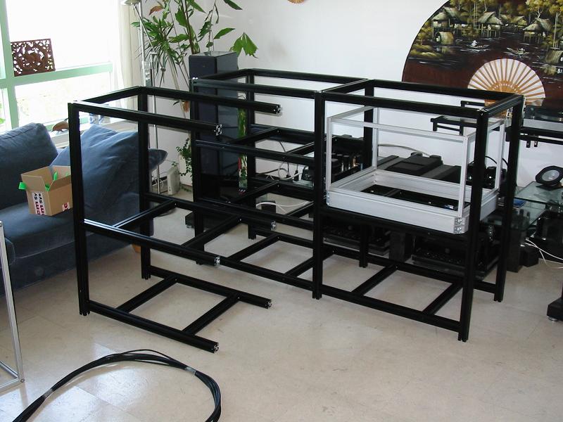

chassis
Hi fellow-audioholics ?!,
i received some mail about how i came up with the chassis of the amps + PS.
Peter: you've collected most of the expensive parts: iron and tubes (nice tube, the EML. I have seen and had them in my hand.....but never was able to listen to them. They looked very promising !) . But how about the "frame".
So here's my supplier: ITEM Systems
On the web under www.item-international.com
Although this is a German-based manufacturor, they have offices / service points in a lot of countries. They were very nice to deal with. Normally they make the frameworks, workbenches, conveyor-belts, etc.
They have a lot of standardised parts (called profiles) and everything fits beautifull together. I've used Profile 8 80x40 2N. Very handy: besides the possibility to bolt the plates onto it, they have more possibilities to fixate items onto it.
I made a rough drawing and they came up with a suggestion/quatation. After some weeks a package arrived with the goodies. All was pre-drilled and tapped. It was just like working with Meccano or Fischer Technik.
ITEM-profiles: a good combination of possibilities + lightweight + encredibly sturdy.

rack in parts I
my 833-amps are quite large: 52 x 75 cm. And they weigh in at 280 kg. So a lot of audio-rack suppliers were simply not capable of offering something usable.
For ITEM i was only a very small custumor. But it was the first time they saw their products used in audio !
Same procedure as the frames: my drawing which led to their suggestion + quotation.
Reinout

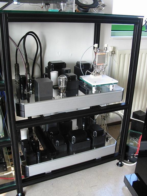

audio-rack in parts II
And the next picture:
Here you can see the almost completely assembled rack. And you can see the amp-frame + protective cage.
Why the cage ? If there are visitors in my house with children (poking fingers......) i have the cages in place.
The frame is again made by ITEM (this time Profile 5) and i've fixed punched stainless steel plates inside the frame. The holes are large enough to let the heat out and small enough to stop children's attempts to touch the tubes.
It will never get a CE-qualification, but it will do.
Reinout

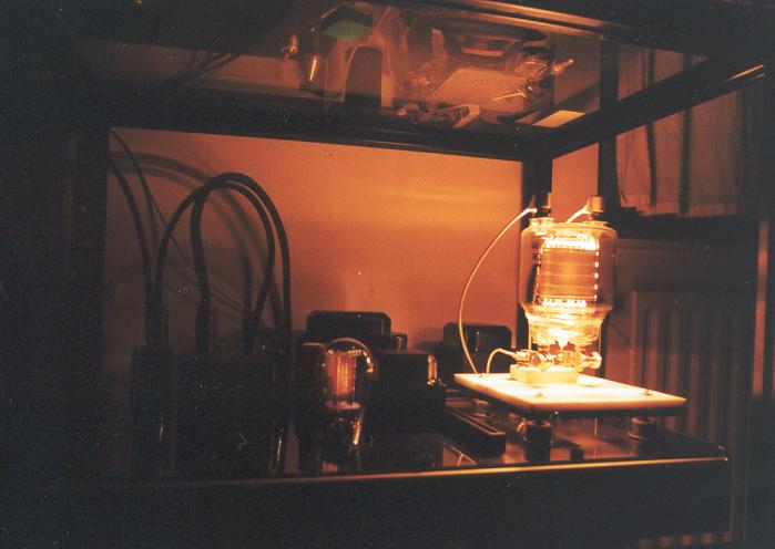

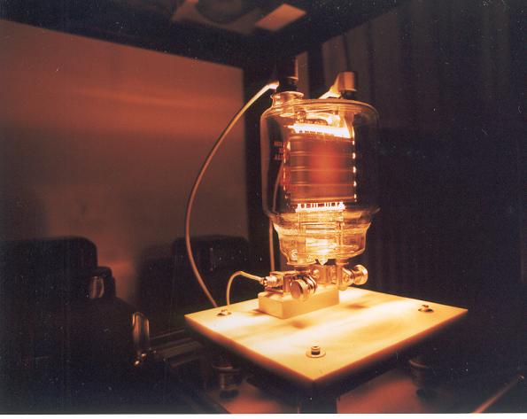

Re: 833 amp does work
ReinoutdV said:
Just finished my 833-amp. After a serious breaking-in and listening time i am pretty pleased with the result (personal opinion of course). Trying to describe the sound is not easy, but "effortless" is a nice start.
Funny: a huge tube, a massive power supply, half a truckload of components.......and the sound is ...."light" "airy". Don't get me wrong, there is seriious grunt.
The amp is in two monoblocks with their own powersupply. And yes: you need a substantial amount of transformers. I'm using 135 kg of transformers and of course that explains why not a lot of people are going for the nice tube.
Pricewise it is a nice tube as well. NOS is still available and new is nowadays produced (even a new carbon based anode).
The amp is in A2 and currently i've set the B+ at 1000 V. In the future i can switch to higher voltages in trying to find the sweetspot.
I'll attach a picture of the amp, remember there is another unit just as large which is the power supply.
Lots of luck with building and please be carefull with the high voltages (the other reason why there are not as many 833-builders around).
Reinout

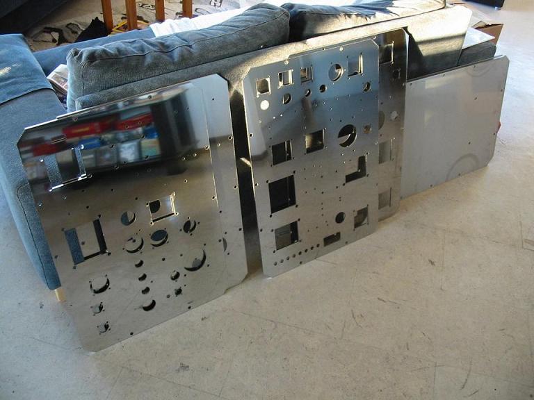

top plates / Dutch DIY-audio day
Hi Bas,
thanks for the compliment. It was indeed a 2 1/2 year-project. 1 year theory. 1 year parts gathering. Last 6 months actual building. But i think worth it; they sound good. And i've received very nice comment on the amps on this forum.
I'll try to join the Dutch DIY Audio Day on 17th April, but i will NOT bring the 833-amps (spine-breaker). Maybe my 6C45-based phonostage or the 6SN7-based headphone-amplifier. If i can come.......other obligations as well.
I posted an internet-adress of ITEM systems where i sourced the casing and frame. To be honest: it was cheaper than the stuff i formerly used. Those were solid aluminium slabs bolted together. But the ITEM Systems parts are lighter, more versatile, cheaper, etc etc. And VERY important: they do all the drilling and tapping of all needed holes. You only have to bold it together.
If you contact them: they are used to work with firms, not with individual persons. But they are very friendly and visiting them in Maassluis (adress Zwarte Zee 40-42, tel: 010-5937260) is advisable. They have good coffee and than you can see the actual parts.
I hope i can join the DIY-day.....i've got lots of their "profile-samples" which i can show you.
Besides the transformers (obvious the most expensive parts) the top- and bottomplates were not cheap either. They are made out of 4 mm stainless steel. For the bottomplate standard (dull) stuff, for the topplate polished. I've contacted several firms who were able to get the material AND cutting it according to my drawings. They were all asking very "funny" prices. In the end i've found a manufacturor of agricultural devices who had a laser-cutting table and was willing and able to do the job during periods of less activity. Again.....patience.....but the result is very nice (for a good price).

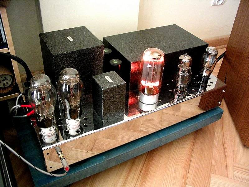

thanks for the answers Reinout!
Here you have the picture of my amp and GM70 copper /premium/ version.
Amp uses Tribute signal iron and lundahl PSU chokes.
It is AVVT AV8 /choke loaded/-AV8-IT 1:1-GM70 setup with separate PSU for driver and power tube section. I measured 48W output power and 3mV hum (0.3mV when the first tube was 6H6P). With my 92dB Tannoy drivers the level of hum is acceptable.
This is one monoblock picture
Maciej
