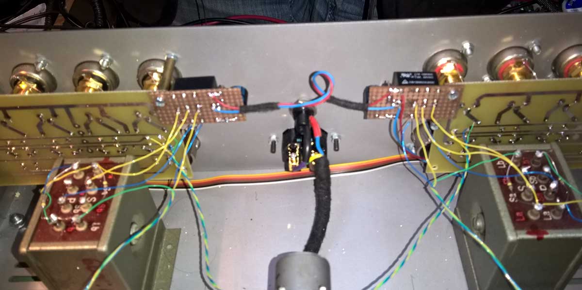

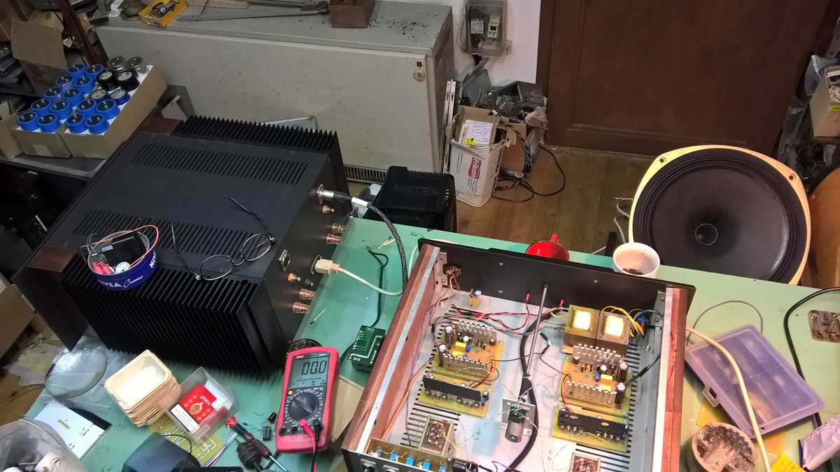

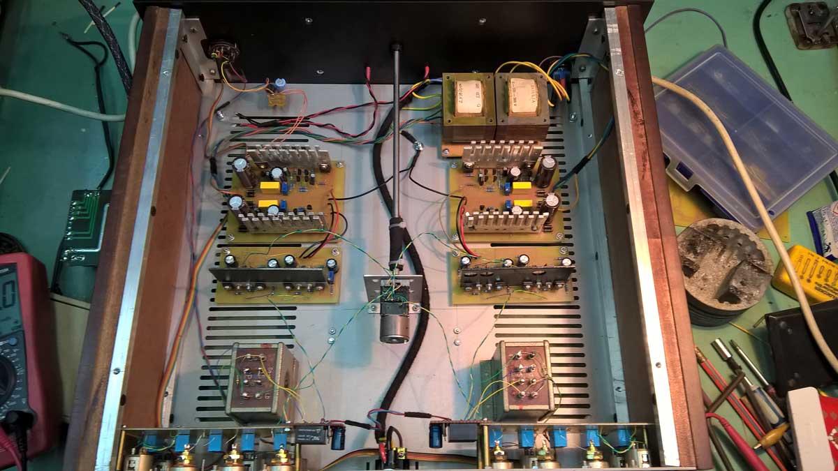

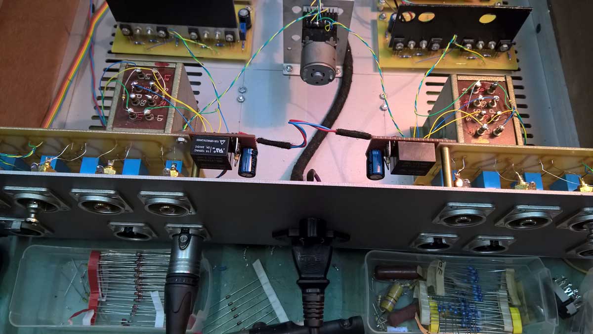

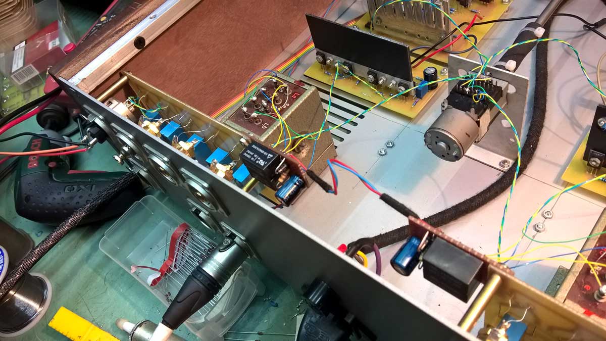

Rick , now I remember that I owe you reply or two here .... will do that later tonight
for now , just few pictures ...... so called preliminary Iron Pumpkin prototype is done (preliminary being pot-buffer-6db autoformer)
what was important :
-to confirm flawless function of Good Gemini shunt reg ,
-to develop and finalize my own Diamond Buffer ........ which is nothing more but nothing less than drekload of parts replacing simple and great complimentary JFet buffer , but with similar THD spectra and substantially lower Rout
-to solve full basket of problems with balanced iteration : 1. to keep same gain in both Bal/Bal and SE/Bal working modes , 2.to maintain flawless THD spectra in both modus operandi , 3.to avoid/cure/prevent clicking and crackling noises when switching between various modus operandi
now , few days of some thinking what's conceptually best , to send to 6L6 for store , and to make that mishmash
after that , full forces at SE and Bal Metglas AVC development

Dear ZM,
You owe me nothing! You are the one owed for ALL of your good advice and even better ideas! Plus I figured you were busy with this project and any question of mine has a lower priority than the IRON PRE.
Balanced sounds like the proverbial balancing act. Balanced autoformer attenuator sounds like asking for trouble to me but if anyone can pull it off ...
Curious to hear how you like the sound of the diamond compared to the simple complementary. Always hoping the diamond just might be even better ...
Your implementation looks really good. You are working towards a very different aesthetic than I. Is that case lined with copper sheet?
Is the GOOD GEMINI shunt reg an evolution of the POOR SERBIAN one or the same basic thing?
Can't wait to hear more.
Nobody keeps the excitement level up like ZM.
Take care,

wow, looks great. I thought we have single pcb´s without input select, but it´s all there already 🙂
maybe two holes on the right (input) side wouldn´t hurt (drilling them won´t either)
tnx,
st.

as I said - first kitten - not finished
there are 2 holes more , just moved outa screen
probably several more hours in optimizing , then few more for sorting documentation (names , values optimizing etc. )

preamp is made for a friend (having no less than 3 pairs of speakers based on Mighty ZM's brainfarts) , as interlink to final Iron Pumpkin (buffer to AVC with gain) so it'll be easy operation - ALPS out , old Iskra repeaters out , new AVCs in ....
that - looking as copper , is nothing else than sides mades of some wakoo wood
sound - he's thrilled , to put it mildly ;
even early SE prototype , shown in dreky casset-deck case sounded better than his BA3 preamp ;
well - I didn't made that one , and - as I said to him - where BA3 FE is really shining is in original role - as full banging gain stage , driving hefty output stage ..... so optimizing it for mild gain is not an easy task and really not fair to expect from it nature of Swiss knife 🙂
so - to cut it short - I believe Diamond buffer is sounding damn good , in this iteration

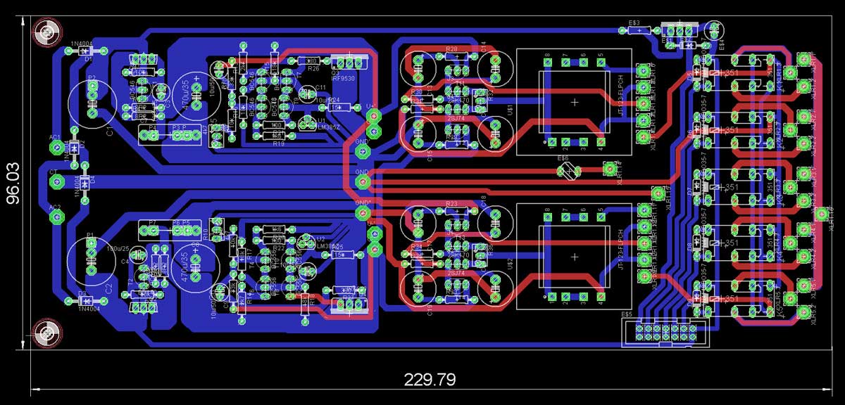

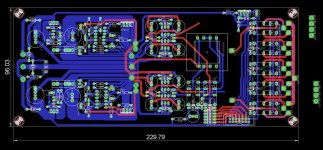

to chill out from SE (stereo pcb) iteration , working on Bal/SE in/Bal out (mono pcb) iteration
- problem with both pcbs is that I ooked proper Eagle routine - instead of importing properly (complete pcbs+sch) subcircuits , so having them on different sheets in project as a whole ........ I simply copy/pasted brd subcircuits, leaving sch parts laying somewhere in electronic mist (non-annotated to pcb files)
so - will need later to produce complete schmtcs backwards , just because being too lazy to abandon several hours of work on big pcb files
anyway - had some fun tonight :

again - these will be (pot-JFet buffer-autoformer ) packages for DiyA Store , 6L6 asked for ;
one is gonna be SE , stereo pcb , with shunt reg common to both channels , but with local cap multis , so no worry
second one is gonna be BAL/SE in , mono pcb , so shunt reg per channel (still with cap multis , why not)
in both cases 5 inputs , relay switched , plain rotary selector for these
Bal/SE - number of SE or Bal inputs configurable by builder - simply put one 1N4148 diode for each SE input you want
I'm working on other solution , which is selector-Diamond Buffer -AVC (so no ordinary pot) , both in SE and Bal (as above) , fed with same Good Gemini shunt
when done , I'll publish all schematics , but will preserve fabrication of both AVC and pcbs for my self
then you'll be able to get them from me , either just AVCs (SE and Bal) , or as complete packages
