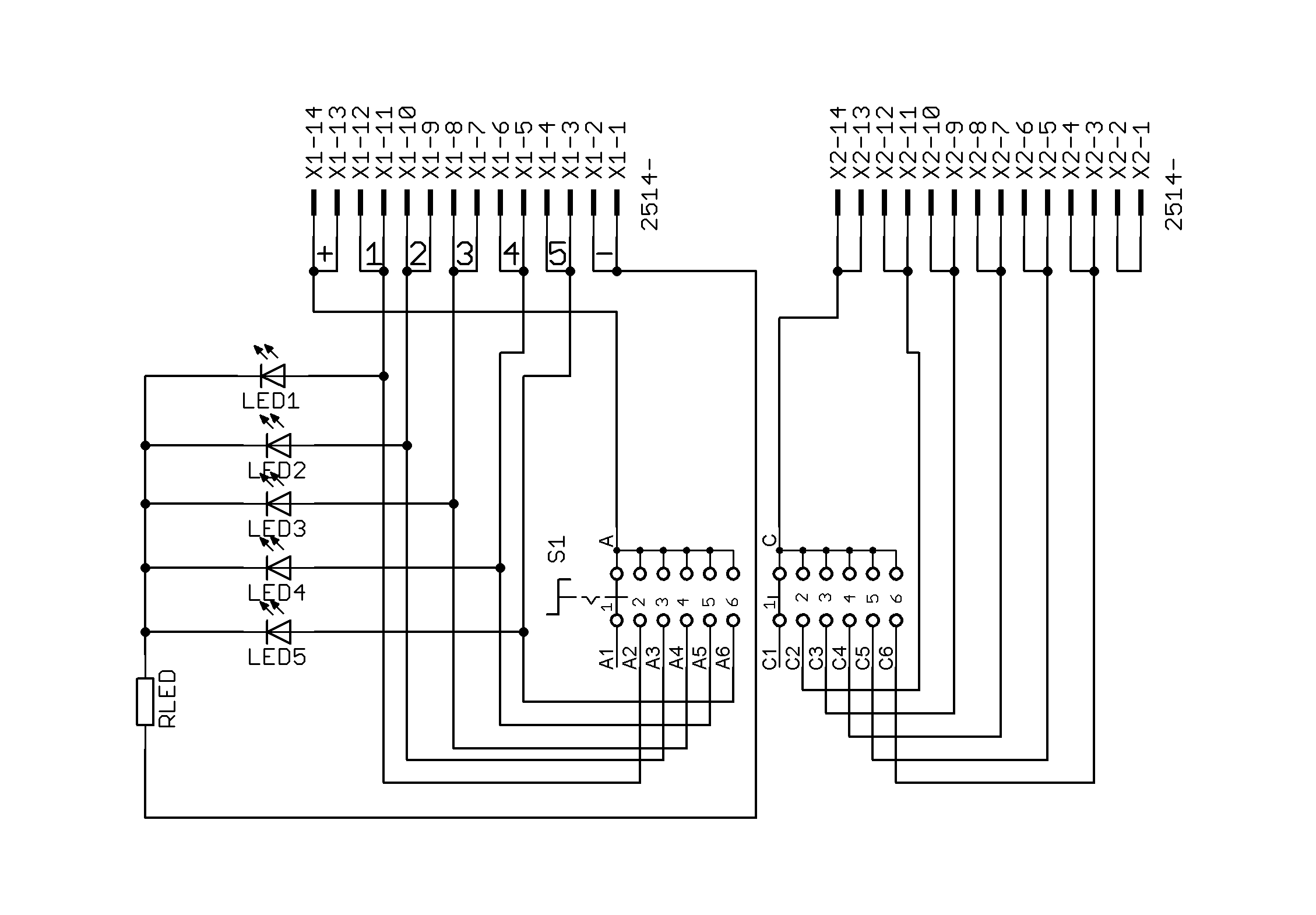

I'm pretty sure I've got it sorted in head now. Just wanted to make sure of "second" wire in schematic wasnt something I missed.
for a moment , look at IDC connector and adequate flat cable
you have 14 pins and 14 wires there ...... while we are routing 6 different current paths with it ; how many second/double wires we have there?
you have one current path lead with 4 pins and 4 wires, and you have 5 current paths lead with 2 pins and 2 wires
that's called intentional redundancy
frankly, there is no need at all that one understands it all , just to wire bloody thing as written, and it'll work as intended
and it'll happen for sure, once when listening da muzak, it'll just click from nowhere "aha! I got it now!"
" negative common for LEDs, all taken to switch"
Which, if you're a ham-fisted dodo like me... and short Rpos and Rneg... ooopsie daisy... :rofl:
Of course, as mentioned... I didn't follow my own advise and FOLLOW THE SCHEMATIC when I was checking the relays. Not relevant to Russellc, but for anyone else with the current boards - take care.
It's in my post above where I bungled (for the Bal version). However, it should be the same for SE except only one set of pins going to the "Twister" b/c you only have to switch one set of relays on one board.
Edited to add - just in case.... here ya go. And of course... wait for ZM to confirm I am using correct schematic :rofl:

Guys (not ZM)—would it help at all if I pointed out that the reason there are 2 rows of contacts in the switch zone is because the header blocks you can buy drop right into ZMs layout and fit ready made ribbon connectors that all have 2 x 14 contact points? I was making things very complicated in my noob mind trying to understand why there were 2 rows when it seemed I only needed 6 connections to make it all work.... (...until 6L6 fixed my brain....)
Also, I elected not to hook up a mute position. So I only have the common plus 5 wires running to the Lorlin switch. Common (pad "2" in my case) to "A" on the switch. then 1-5 on switch connected to 4,6,8,10,12 on Iron—No mute in my case—didn't see the point.
This makes it much simpler and is how DCG3 worked. With continuity buzzer hooked to either one of center pins, you can easily determine which half of pins to hook up to.

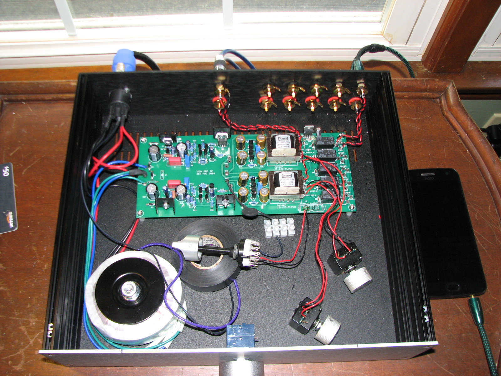

Oh, and I wired the one channel to selector pot, see pic
Russellc
Think I have pic posting problem beaten too! Good day!
