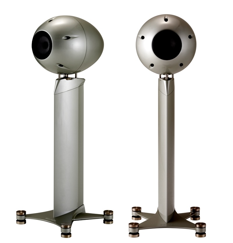

If you decouple the driver from the box all of the reactive energy has to be disapated by the mass of driver. This reduces DDR of the system.
A system like used by The FUJITSU Ten Eclipse where the egg shaped “box” is free flosting anf the driver is anchoured to a massive stand.
FUJITSU_TEN_exhibits_ECLIPSE_Home_Audio_Systems_Top-Class_Model_TD712zMK2_at_2014_Internation...jpeg
