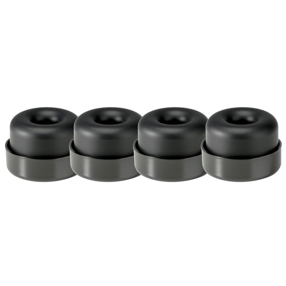

For subwoofers I use SVS isolators. For floor standers I have placed the speaker on granite pavers which sit on rubber strips.

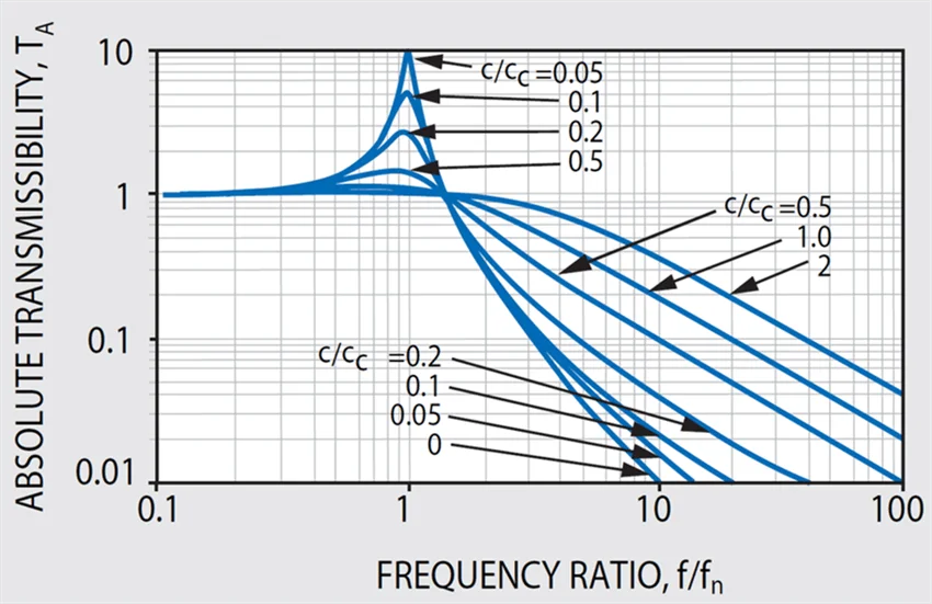

To decouple, natural frequency of the (decoupling) system needs to be below the (loudspeaker) system frequency response, like at 10Hz or so, what ever. You can dampen it as well, if you wish.
Keep in mind that adding damping into such a system will serve to substantially increase the transmissibility of vibrations above the fundamental resonance frequency of the mass–spring system. A plot of transmissibility as a function of different levels of damping (c/cc) is shown below:
Source: https://www.azom.com/article.aspx?ArticleID=23456
Just figure out what's your spring constant and how much deflection needed to get the resonance that low with mass you have. If the spring becomes impossible, add mass. Then do a mechanical design that implements it. Now it's decoupled.

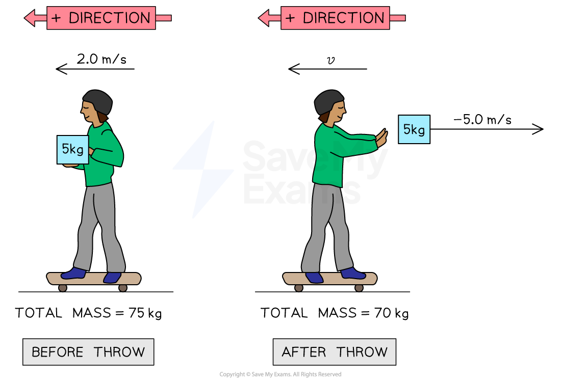

perhaps i don't understand the m1v1=m2v2, but i don't fear to explain things with simple words in order to be understanded by everyone and i don't know how adding mass can be a solution for a good decoupling.
And I like diagrams over words. More mass in the cabinet/woofer basket (m2) makes the cone (m1) move more (v1) and the cabinet/basket move less (v2). Good!

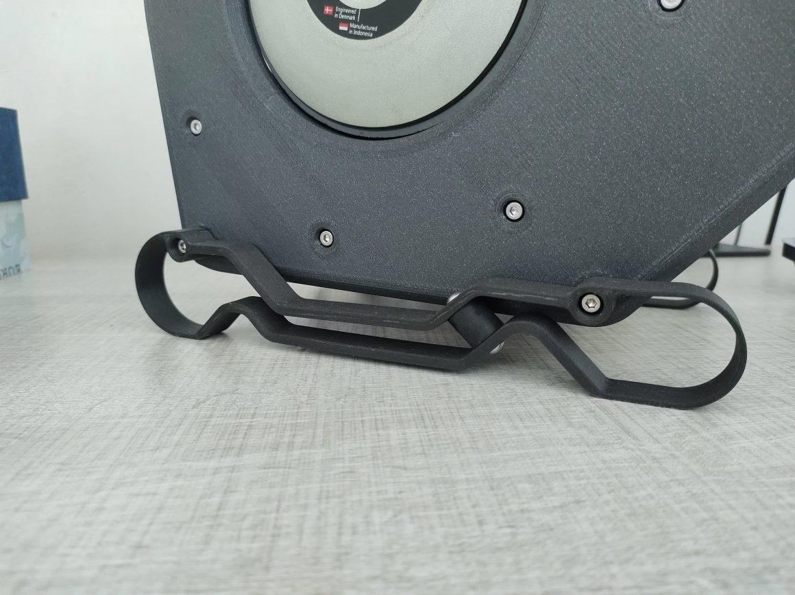

The feet arc shaped springs are deforming on all the axis, you will go nowhere without a CAD modelization and simulation of the entire system IMO

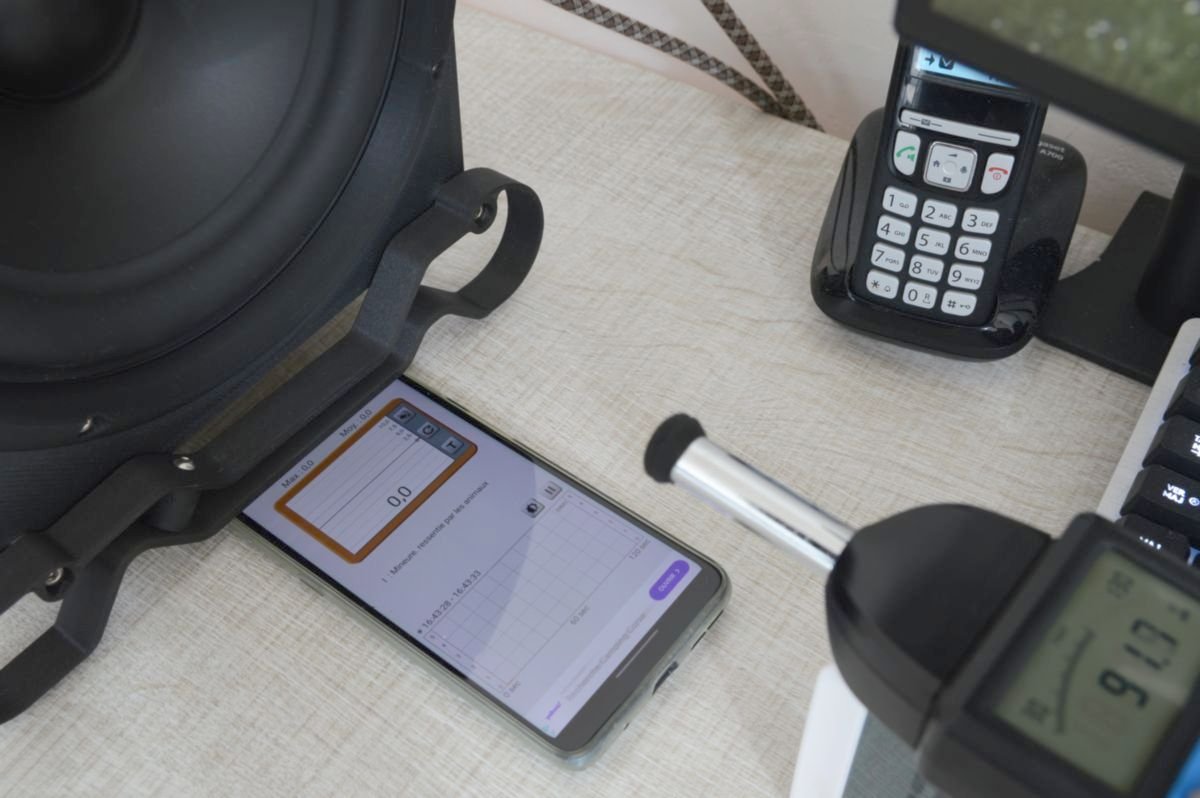

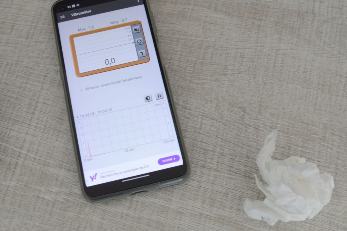

I've used a seismic application on my smartphone, calibrated the woofer on 30Hz at 90Bd(C) at 30cm and the application give me a seism of magnitude 3 when the smartphone on the cabinet and absolute zero when i put the smatphione on the desktop under the cabinet (between the feet).
I havent anything else to mesure but the desktop seems absolutely inert.
