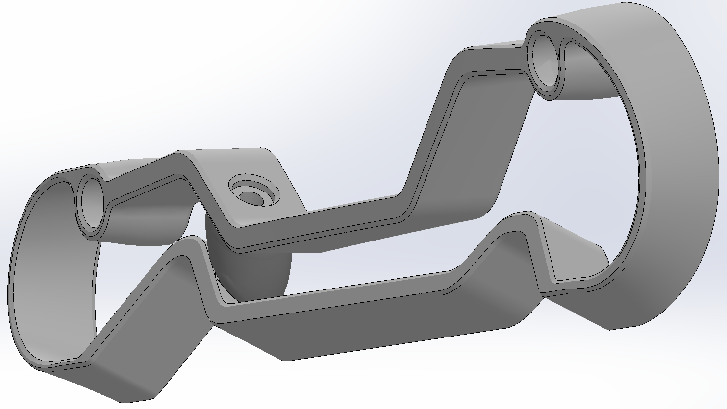

I've start the assembly simulation, ton of things to parameter for a very short moment of onanism.
Is there anyone that see the problem on this simulation ?

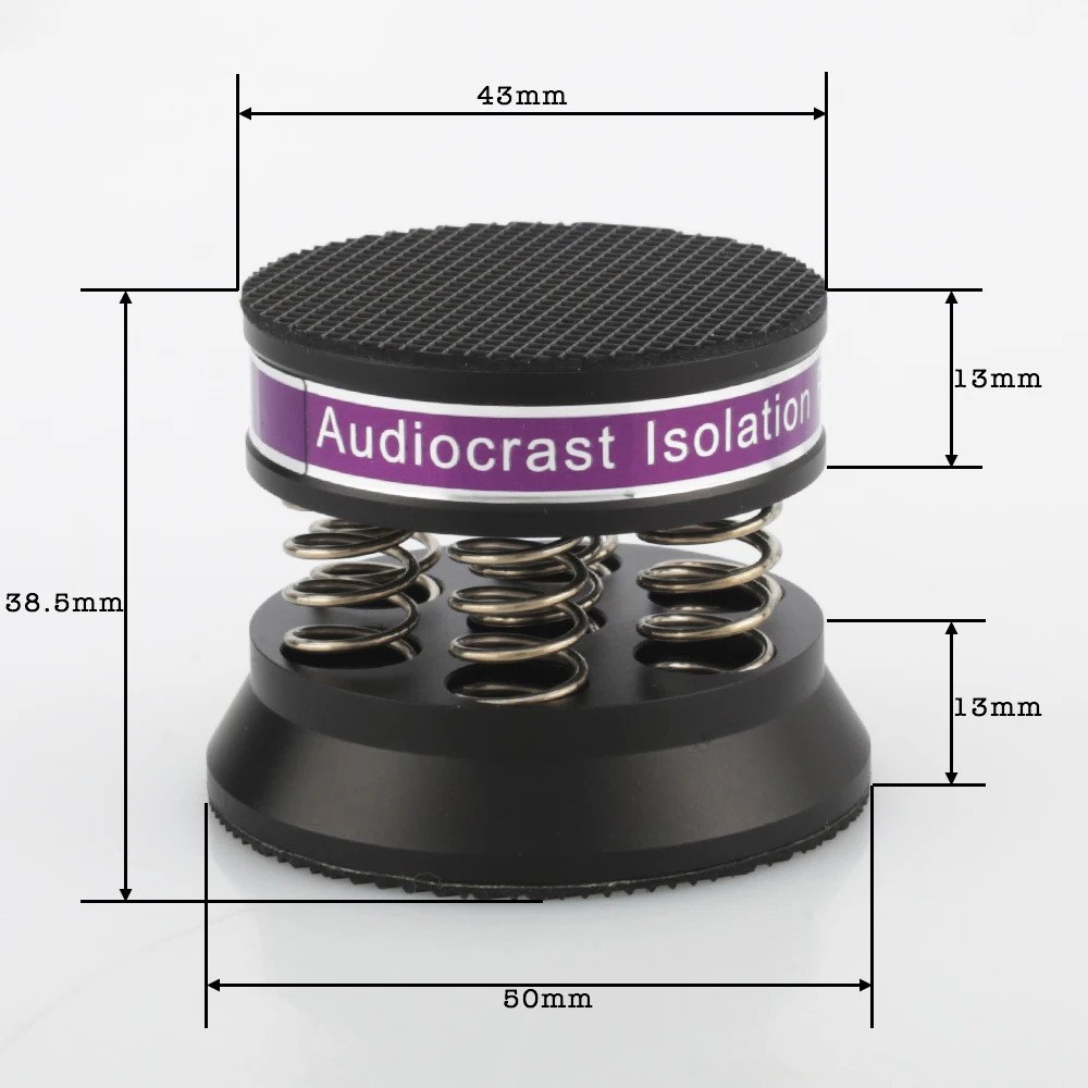

Aliexpress is full of strange spikes and ridiculous spring systems, are we all idiots ?

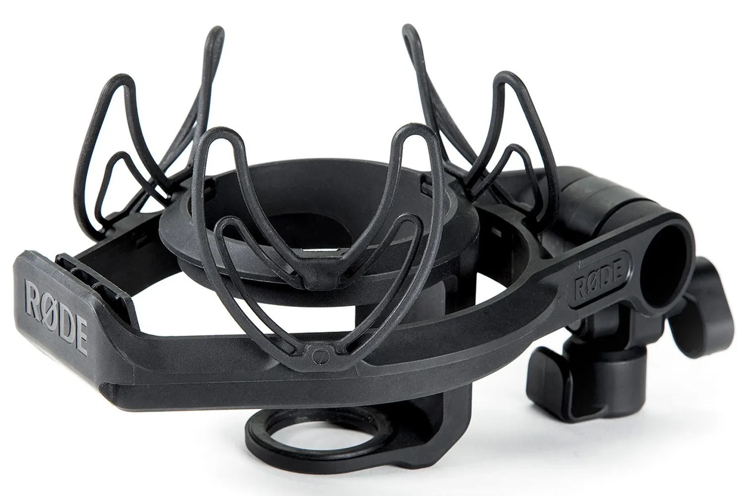

Here is a SMR for a microphone :

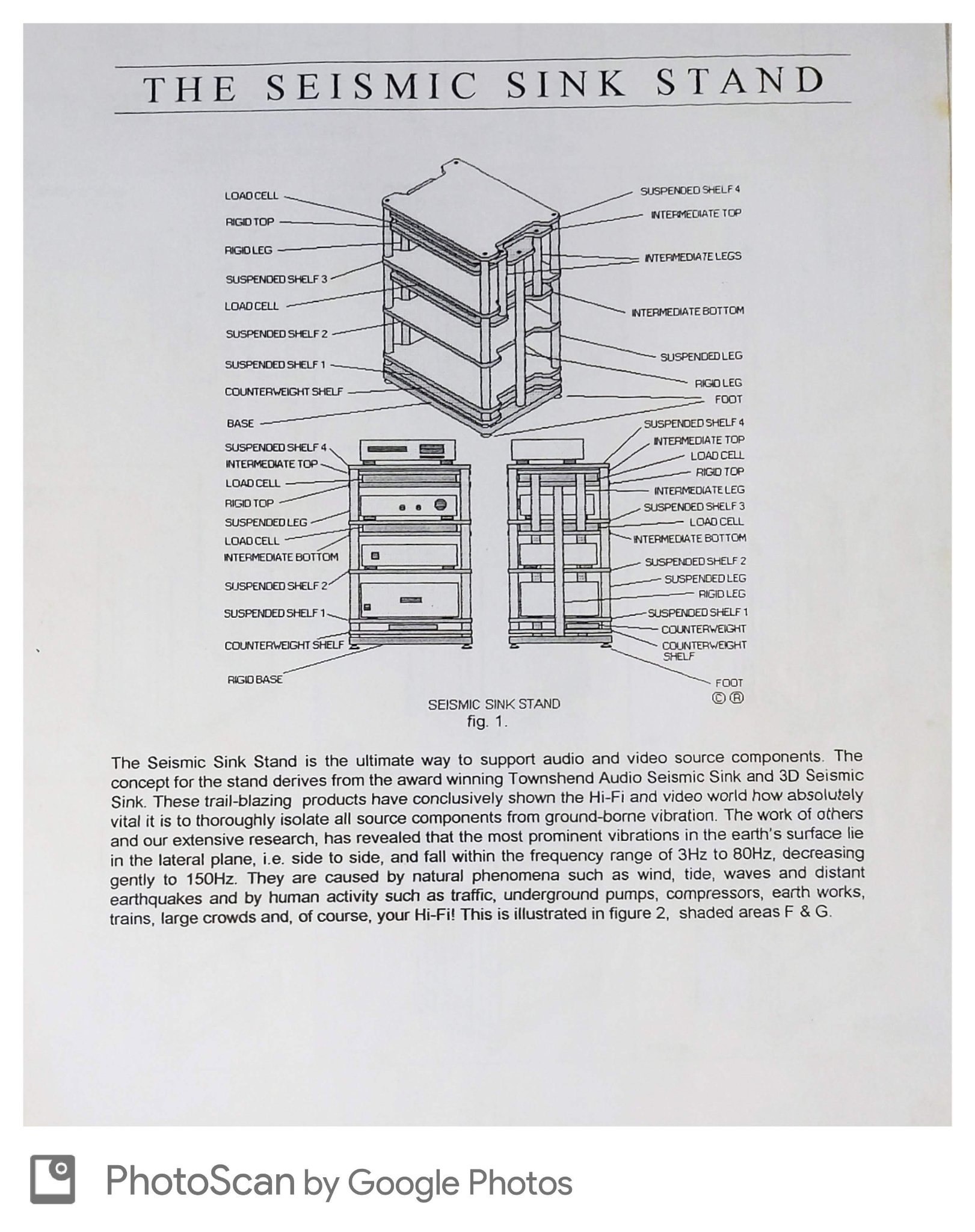

I was involved in development and marketing of the Seismic Sink in the 90's [https://www.audioaffair.co.uk/townshend-audio-seismic-sink-hi-fi-stand]. The reason you don't hear about it much is because of the current price and the absolute faff assembling it. I have one of the original develepment ones for audio kit and a hand crafted one for speakers which costs peanuts to make from MDF or PLY.
I'm being careful not to disparage the new Seismic Sink but it is a poor re-work of the original If fact, it doesn't resemble the original mechanically. You'll see from the attached file there are three air bladders which, when inflated, force the shelves mounted in one set of supports to float as is there is no gravity. It was a cow to setup...

I'm not sure it was ever there....
I suspect you have worked yourself up on this "issue" which isn't a big thing really... maybe reconsider the urgency of a "solution"....?

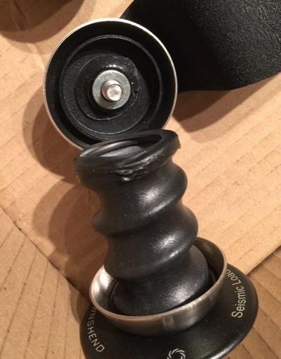

@Terry2000 it is interesting but the air losses in the chshions within time should be a problem ?
