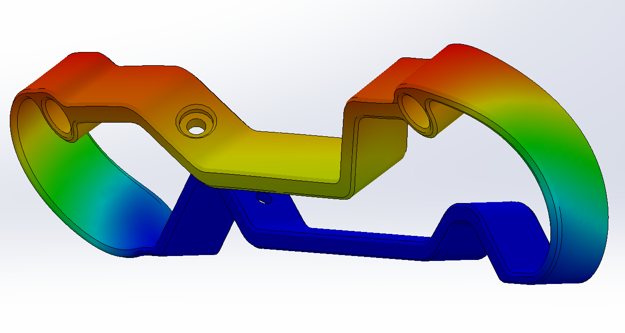

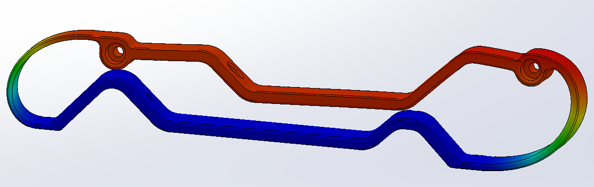

Great, but my goal is to minimize space and mass to the ultimate level, without neo magnets.Isn't it easier to make like this -pics, eventually-!??
All the "wires' are rubber-bands, just in case someone confuses them

The new roll of PLA is arrived and the printer is at work, the polymer springs will be a tad thinner to optimize the lateral deflexions.

Problematic picture for several reasons... black text on very dark background...And I like diagrams over words. More mass in the cabinet/woofer basket (m2) makes the cone (m1) move more (v1) and the cabinet/basket move less (v2). Good!
