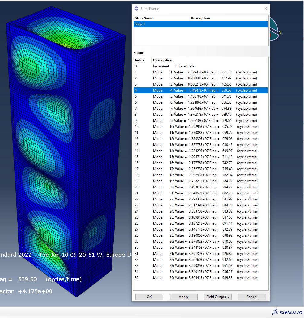

The soundpressure inside the enclosure translates to the order of tens of Pascals, i would think nowhere near enough to deform the enclosure to an extend where it starts to radiate meaningful SPL. Unless of course it tries to do so near an eigenfrequency of the structure, of which there are plenty in all enclosures. I believe this is why no vibration happens at ie. 38Hz, but i bet you there are SPL-producing vibrations in the 500-800Hz area.
Regarding stands i'm curious myself, but have always landed on damping rather than isolation, I just use rubber feet with the lowest Shore-value i can get away with. This way i get decent isolation where the enclosure resonates, and limit any resonation of the suspension system due to the damping of the rubber. A fully isolated tower speaker would be difficult to manage because of the bending moment caused by the height. I will try to do some simulation on it.
Eigenfrequencies of 19mm MDF enclosure 1200x350x240mm:
How about the amplitude of movement of the walls - is that also calculated?Eigenfrequencies of 19mm MDF

Except at low frequencies the forcing from the internal air is likely to be negligible compared to that from the drivers hammering away on the cabinet and is often ignored because the resonances which might be loud enough to be audible are at higher frequencies. Including the internal air pressure in a simulation isn't straightforward because both the background thermodynamic component of pressure as well as the acoustic component needs to be handled particularly for small sealed cabinets. This means a low Mach number compressible CFD scheme or perhaps a high Mach number compressible CFD scheme and putting up with computational inefficiency and dodgy speed of sound. This adds a lot of complexity for little gain beyond providing evidence that internal air pressure isn't important to the resonances. It might be of interest in checking how much the walls of a small sealed cabinet deflect and how that influences the cone movement but that could likely be done well enough with a simple lumped model.

I'm not there yet, but I am working on simulating displacement of the walls in relation to SPL. On this current simulation the force is not factored in, only stiffness and weight.
Are you modelling the drivers given they typically have a strong influence on the most problematic modes. I assume you intend to use the surface displacements for an acoustic BEM simulation? What damping models are available because these are likely to determine the accuracy achievable in simulating vibration.
If you are using simulia remotely it would be useful to have a rough idea of cost in terms of time and money for the full set of simulations in order to compare with alternatives such as grinding away with freely available software (hard work, time consuming and with important bits missing) or locally run CAE packages (straightforward but prohibitively expensive for DIYers).
You are right Andy, the mechanical force from the cone moving transfering to the cabinet would be a significant contributor to exciting modes. Probably way more than air pressure. Thanks! At this point i don't know how to include that in the modeling.
My original idea was to run a steady state modal dynamic with an equivalent pressure on the walls, but this won't take what you mentioned into account. I just finished a class on Abaqus, but will have access to running simulations remotely for another year. This topic was not covered in the class, so im learning as i go.
