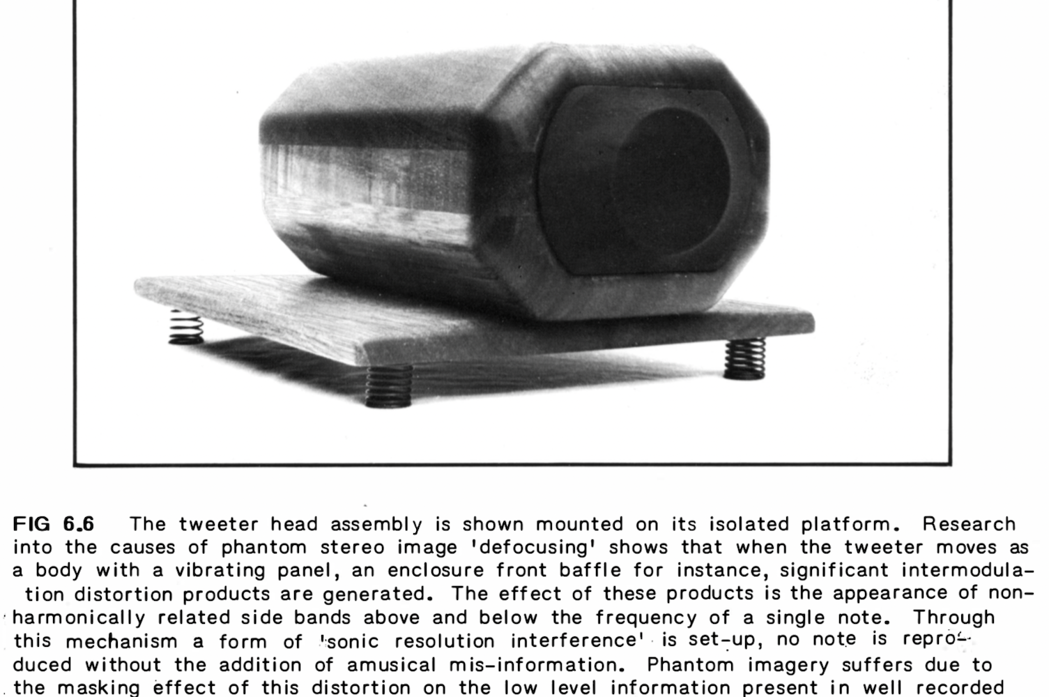

The tweeter mount on the Pearl PR2 was my first exposure to this in hifi. He goes intomore detail in his PR2 paper/short book.
