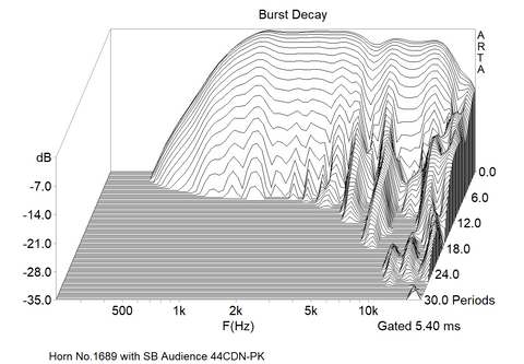

Would be much more useful if the time axis was in periods. Then the ridge in your graph would be comparable to each other and interpretation becomes WAY easier. Can yo do that?
I don't know what you mean by "periods" for the time axis, but the way this is displayed is normal for waterfalls.
A decay waterfall with periods instead of msec, is a pretty simple transform, and with all the talk of measurements you don’t know? 35-40 dB is more useful.
Also called burst decay. This is an example from @Joseph Crowe site. Toole gives a good explanation why this formatis better.
One can directly comoare the Qs of resonances, and it makes it easy to read the ring down. A good ring-down has nice parallelism curve.
