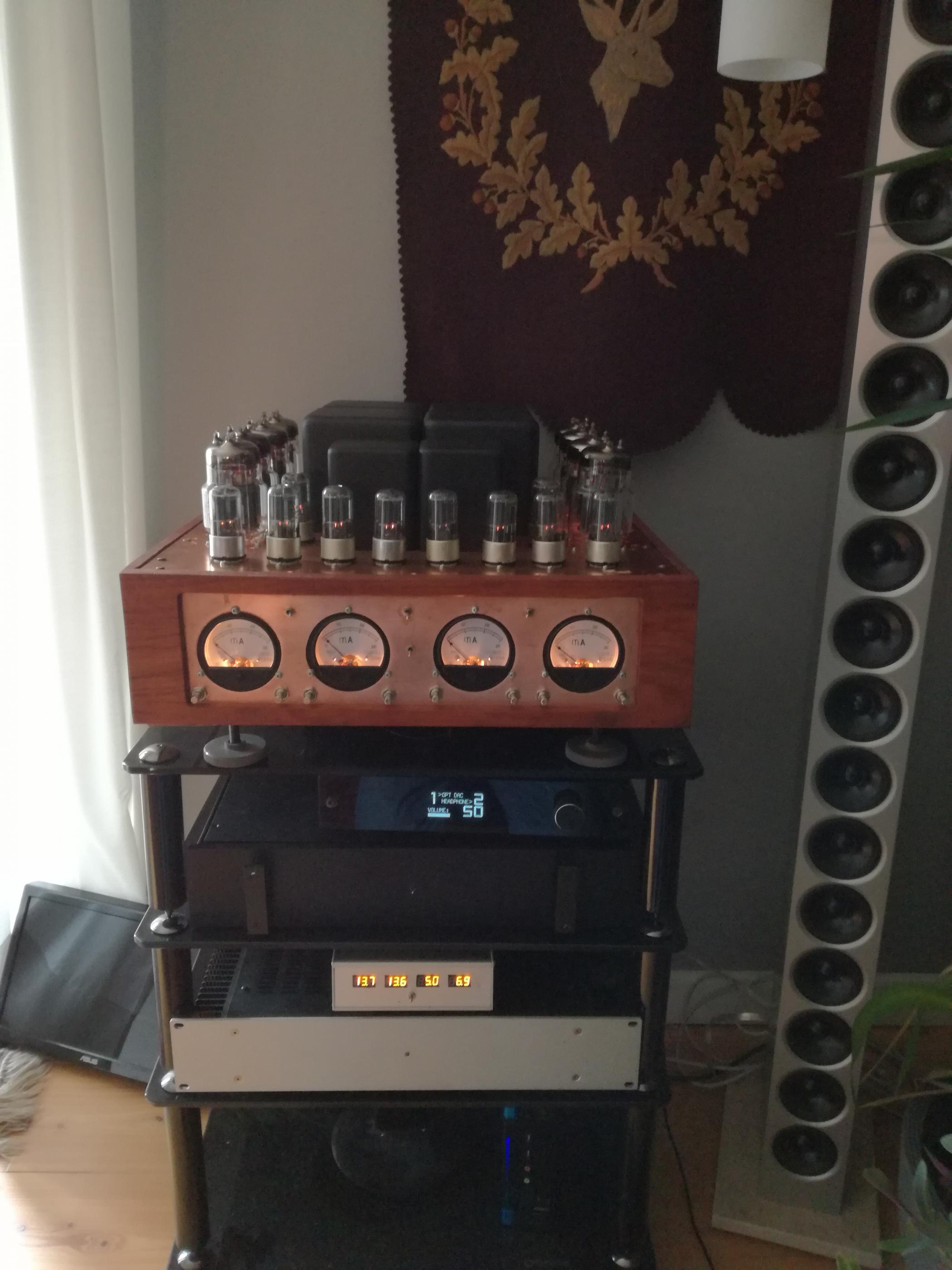

Not quite my experience. My 4 x 6c33 pr. channel are producing > 65W robust watts pr. channel and has been working perfectly without any hickups, not even a tube change for several years now and is the best sounding amp. of the very many I have made (and commercial amps too). The nearest competitors were a Goldmund Telos clone and My Fremen Ref. But the mighty OTL has some authority and natural timbre and a transparancy that I never have heard from a transformer coupled tube amp.

Hi Koldby, what building diagram did you use? What kind of speakers are visible on the picture on the right? I guess that with so many speakers you can create the best impedance matching your OTL amp?
Regards, Gerrit
It is basically a Atmasphere m60 input but with drivers for each 6c33 so it resembles , I guess, the Novacron.
And the speakers are a IDS 25 clone and the speaker impedance is nominally 8 Ohms 5 parallel groups of 5 series coupled drivers.I f I were to put them all in series I would have to redesign the amp as it is not optimized for such a high impedance, and then I could not use any other amp for driving the speakers.
