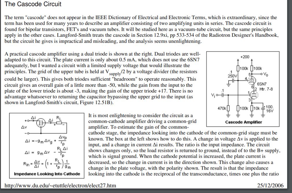

Look at the picture with a cascode using 6SN7 and 100 Kohm anode resistor.
Gain ca. -50
Total gain without feedback 50 x 0.95 x 0.7= 33,25 Witch is about 30 dB.
1 dB feedback --- 29 dB gain and then some not calculated losses...
Believe me the amp without feedback has normal gain for a poweramplifier.
The M-60 voltage amplifier has a bit more gain than the amp has overall due to losses in the cathode follower driver circuit and then again in the output section itself.

As for the cascode you making a mistake , the gain of this stage is aproximately the same as a common cathode stage , but with lower Miller capacitances and of course better high frequency response ! .
Only for solid state cascodes. For a BJT cascode, the upper transistor reflects re as the lower collector load so the gain of the lower BJT is: re/re or nearly unity gain. Hollow state cascodes offer more gain than the same CK stage would produce. Some loadlines:
The upper triode with a load of 68K manages a gain of 30.47, and reflects 2.1K to load the lower triode (orange loadline) for a gain of 5. The total gain is: 30.47 X 5= 152.35 -- considerably above the gain of a single 6BQ7A section, and well into small signal pentode level gain. Since this was for a cascode LTP, the gain is half that of one cascode: 76.175 -- more than enough to eliminate a second gain stage.

Your calculations are close to reality , but as Miles P said , the gain of the coscode LTP is half the gain of one cascode , therfore we have 25 x 0.95 x 0.7 = 24dB and with loses due to high output impedance of the cascode and NFB we came close to the 20 dB of the amp .

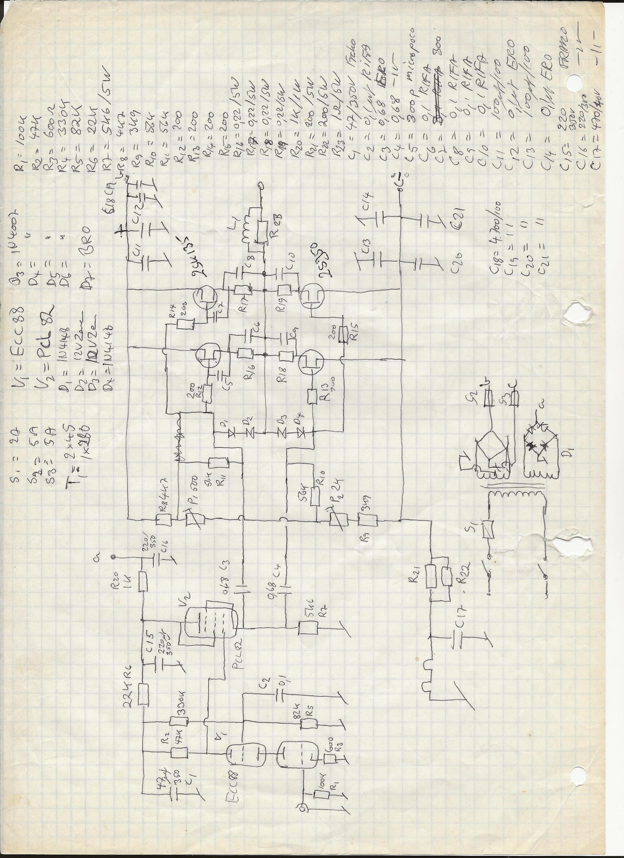

In the early ´80 I designed a commercial hybrid tube/MOSFet amp with a cascode (ECC88) voltageamp input and a triode coupled ECL82 (only used the L part) as cathode follower to drive the MOSFet´s.There is a definite lack of how hollow state, AF cascodes perform. That was the A Number One problem I had when working out the Le Renard design: nothing about audio cascodes except for a mention in guitar amp practice where the goal was gain, not sonic performance. It was another case of try and listen. It wasn't until much later I found an example in the wild: Hedge Amp.

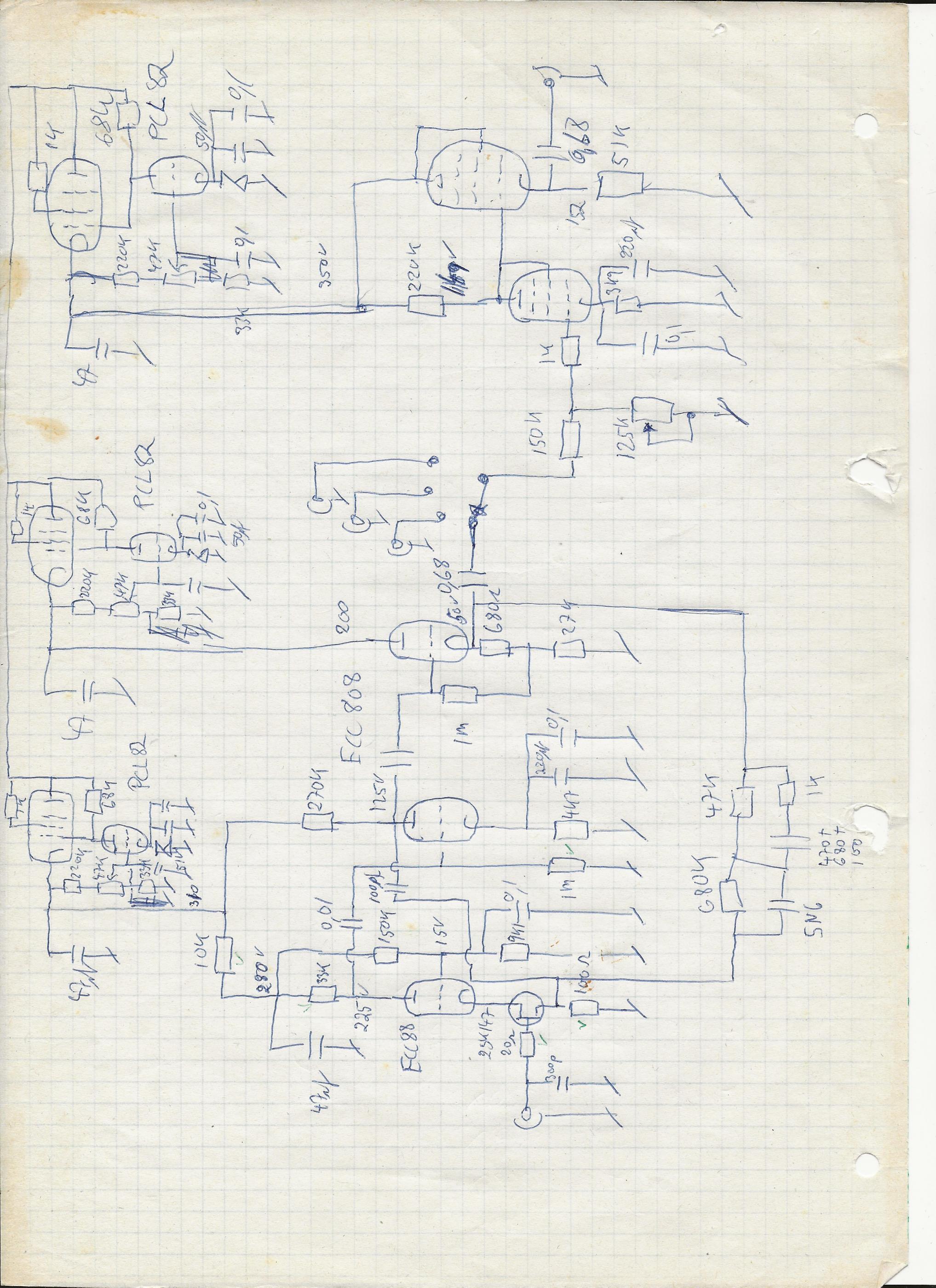

In the matching preamp , the riaa was very inspired from the Marantz 7 but with a cascode coupled ECC8 as first stage. Later, in order to have enough gain and little enough noise I put a JFet (2SK147) in the chatode part of the lower ECC88 cascode , fixing its grid at about 12 V.
Very low noise and very good sound from this combo.
Hi Koldby, you have any pics of schematics?
Dusting around in the old acrehives, I came up with this.
I made these under the brand name Audio Mirror looooong before anybody had thought about starting the american company with the same brand name..
Power amp was TFA3 (Tube Fet Amplifier) and preamp TPA4a (Tube Pre Amplifier) The "a" suffix was the J-Fet upgrade. As can be seen I had a pretty elaborated PS regulation in the Preamp and of course the filament supplies was too with lifted potential where it was needed, to avoid filament to cathode problems.
Thanks dear Koldby
You are welcome!
As Esteban points out to me, there is no need for the MOSFet source resistors and they were not used in the production units either. This schematic is a very early prototype and some changes were made. Don´t recall all of them though. I might have a more resent schematic
