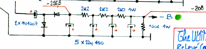

I got distracted by a 120hz hum at .0025V (loaded at 8R) on the output of the 4-toobe. Not enough to notice unless you stick your ear next to the woofer, but the other two amps are completely quiet. So I am hunting ground loops.

Well I found the 120hz coming from the bias supply. It is a voltage doubler. On the first Futterman I built I used the bias supply as it was on the original schematic. At the time I had to modify to get the -260V I needed even though I used all of the speced parts and even with the higher line voltage. SO, I used regulated supplies from then on. I am either going to have to build a bridge or full wave to get away from that and it will take another transformer (replacement for original with a 115V secondary) need about 165 - 170V. Probably just upgrade to the regulated supply. It looks like they were trying to save $1.50 ;-)

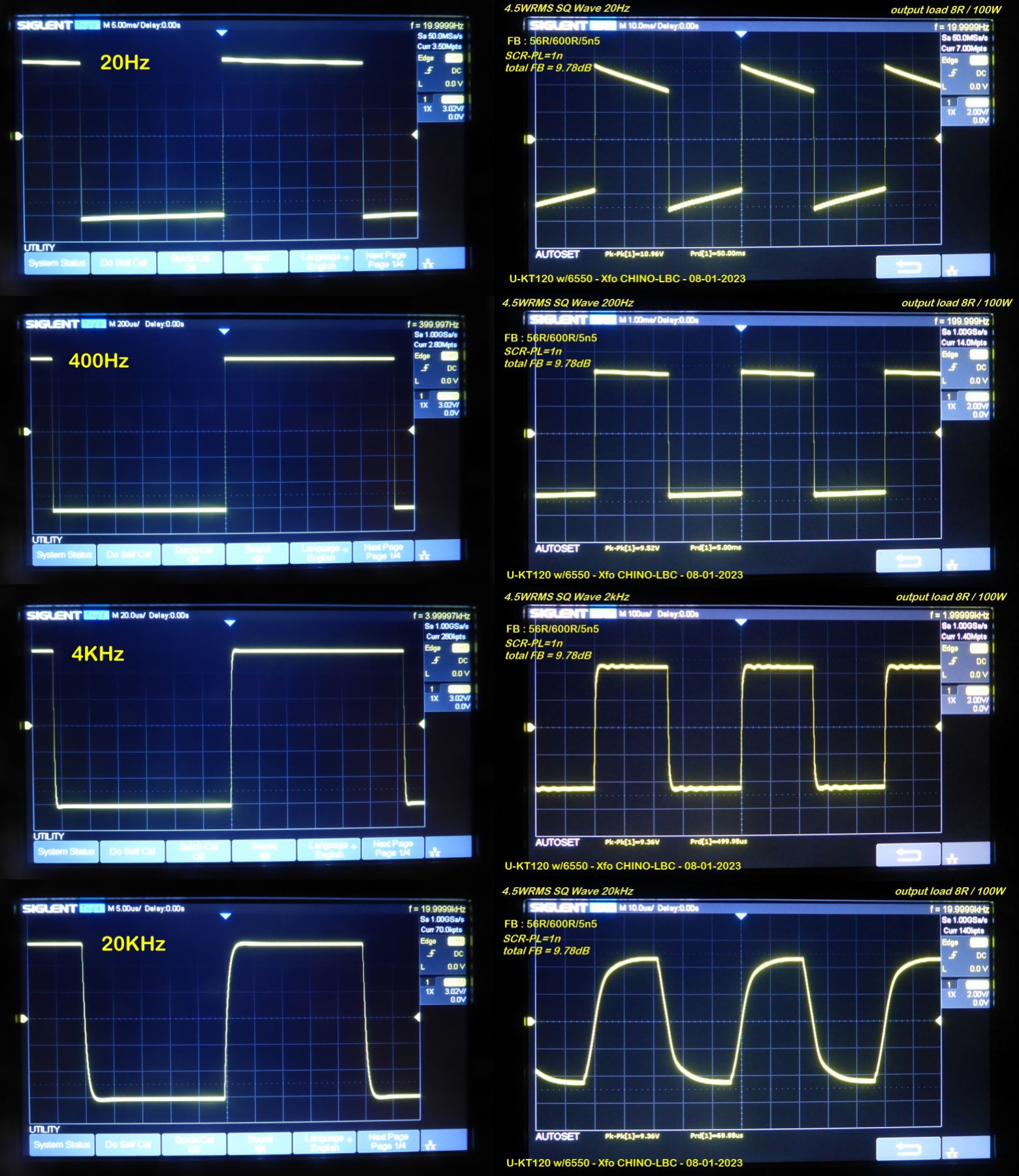

Yes. You understand why I use 13200µF (6x2200µF/200VDC) and 2 reverse-coupled double-coil low DCR (1R per coil) inductances, in order to make the final stage silent on my U-OTL, for only 3x6080 ! 😳

Yes, I do. The B+ (and B-) supplies are quiet. But the voltage doubler on the bias supply just won't do.

Those square waves look classically perfect. Now, get a test CD, and look at the square waves, they are not classically perfect.

OTLs tend to be excellent at square wave reproduction as they don't ring and have wide bandwidth. IOW, better than most PP tube power amps using OPTs and as good as solid state.
Ha ! Coïncidence ? I fronted the exact same issue on my U-OTL bias supply ! I ended to increase the filtering as below :

The particular problem I have is that I run the B+ an B- off of big isolation trans, so 120V out (or more) which gives me about 160V B+ and B-. So I need about -261V out of that circuit to keep my cats in line. (like herding 6AS7s - cats). The bias on the upper tubes (totem) is around -90V but the lower group is near -260V. That is one of the issues that people have building that amp. They are used to biasing their 6L6GCs at ~ -40V.
I have decided to go with a regulated supply and a new Antek 50VA. it has 200V @100ma windings (2) and I can use one of the 2 6.3V windings to buck it down to around 193V I was shooting for 191V. I need the other 6.3V winding to keep the 6EM7 hot.

For an OTL amp, it's very difficult to find a SINGLE power transformer which features ALL the required windings PLUS the suitable voltages AND currents... So I / We had to use "expedient" solutions.
- For biasing the upper 6080, I use a voltage divider taken on the lower 6080 plate supply.
- For biasing the lower 6080, I use a negative voltage doubler, as mentioned above.
Note that my 6080 runs in Class AB1, with only +115VDC/0/-115VDC supply, and idle current of 100mA per triode section. I have no regulated supply nowhere. No Class AB2 nor B operation here - with their permanent large voltage variations - that would indeed require another kind of supply, in power and size !
In short, it would de facto no longer be that simple and compact U-OTL design !

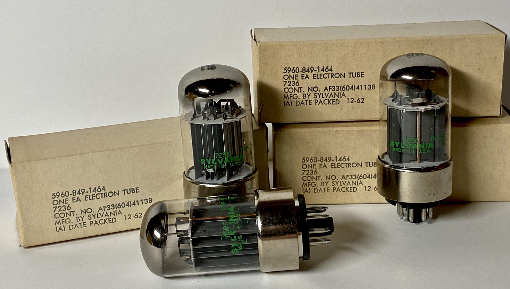

My pick for OTL tubes would be 7236 on the output ,they have mu of 3.5 an impedance of 350ohms,I have 6 of these for sale, if interested please PM me.
We tried that tube. Works well until it shorts. So you have to be a little more careful about fuses. You can probably reduce the shorting issue by proper preconditioning if the tubes are NOS. One thing to note is the grid heatsink. If you are employing a direct coupled driver as seen in our M-60 amplifier, it can easily drive the tube into grid current. That is why its nice to have a large grid heatsink like you see in the 6AS7G (and not in the GA variant, which seems to be why its so much less reliable).
