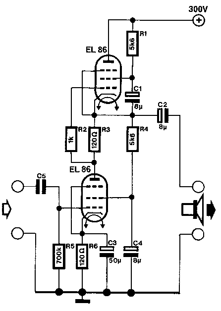

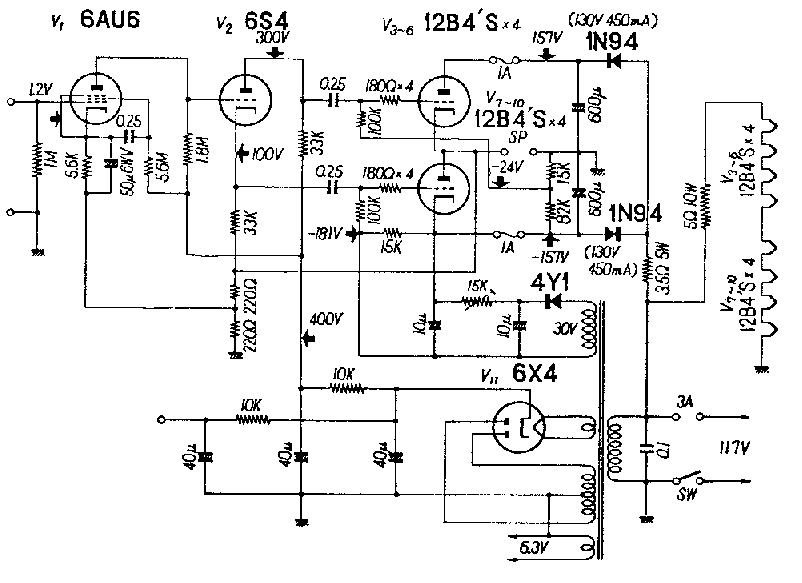

I'd be interested to hear about pre-Futterman OTL amp designs.
Yes. There was a model built by Philips using two EL86, a coupling capacitor and a 800 Ohms speaker. Something similar to this :
The Futterman circuit uses a direct coupling to the speaker, which is 8 to 16 ohms :

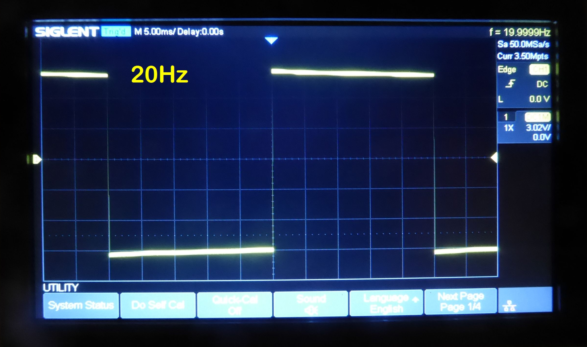

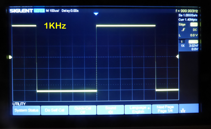

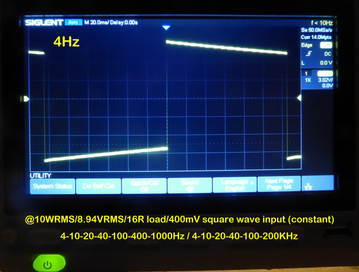

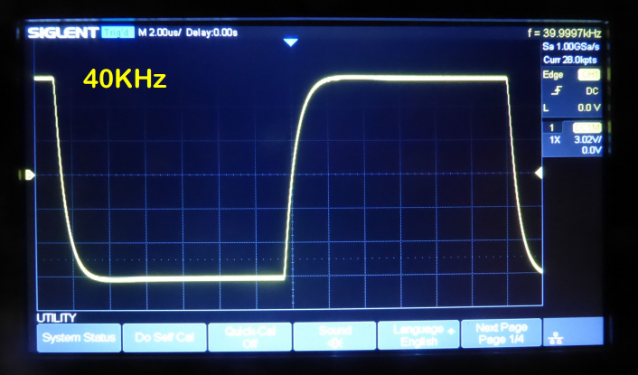

My U-OTL are the application of the Futterman patent, with some modern (and securitive) features, like a power transformer providing the output stage plate voltage, etc. But still completely tubes, not hybrid.

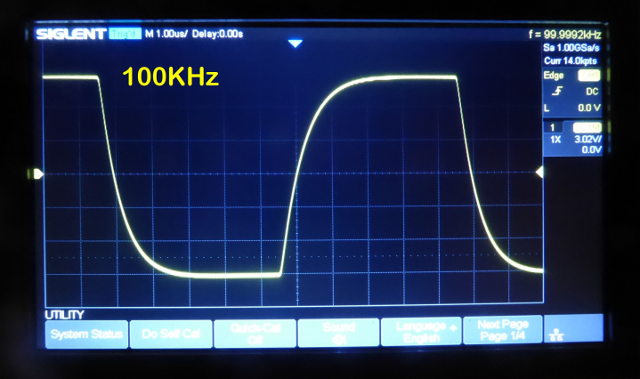

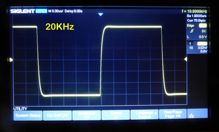

Performances are :
- Output power = 10WRMS @16R (clipping at 12-13W) for 0.675VRMS input sinus,
- Bandwidth = 1Hz-200kHz @ -3dB/10WRMS/16R.
- THD = not measured, no metering available for the moment. Simulations by member @Brice gave less than 1% IIRC at 10WRMS 16R.
- No global NFB loop.
Square waves at 10WRMS 16R :
T

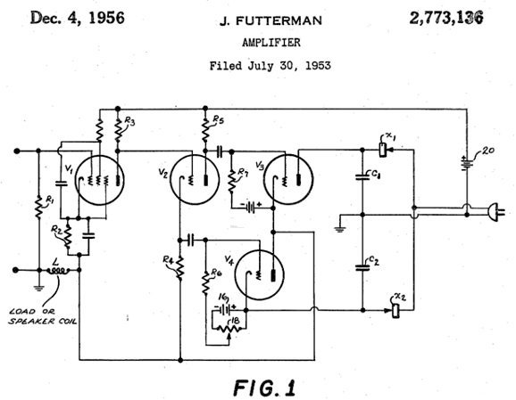

Now what could be simpler than a Futterman H1:I did a patent search decades ago and found a simple OTL that was patented in the early 1950s. I built it up for fun and it seemed to work. Much simpler circuit than either the Futterman or Circlotron types. It was a totem pole design. I don't remember the inventor.
A current starved pentode input
a cathodyne splitter
and a totem pole output ?
... maybe a self splitting output .... but "much" simpler ... ?

It appears that Fletcher/Cooke ['Electronics' Nov 1951] and Brociner/Shirley ['Audio Engineering' June 1952] both had true OTL designs for standard impedance drivers that pre-dated Futterman.

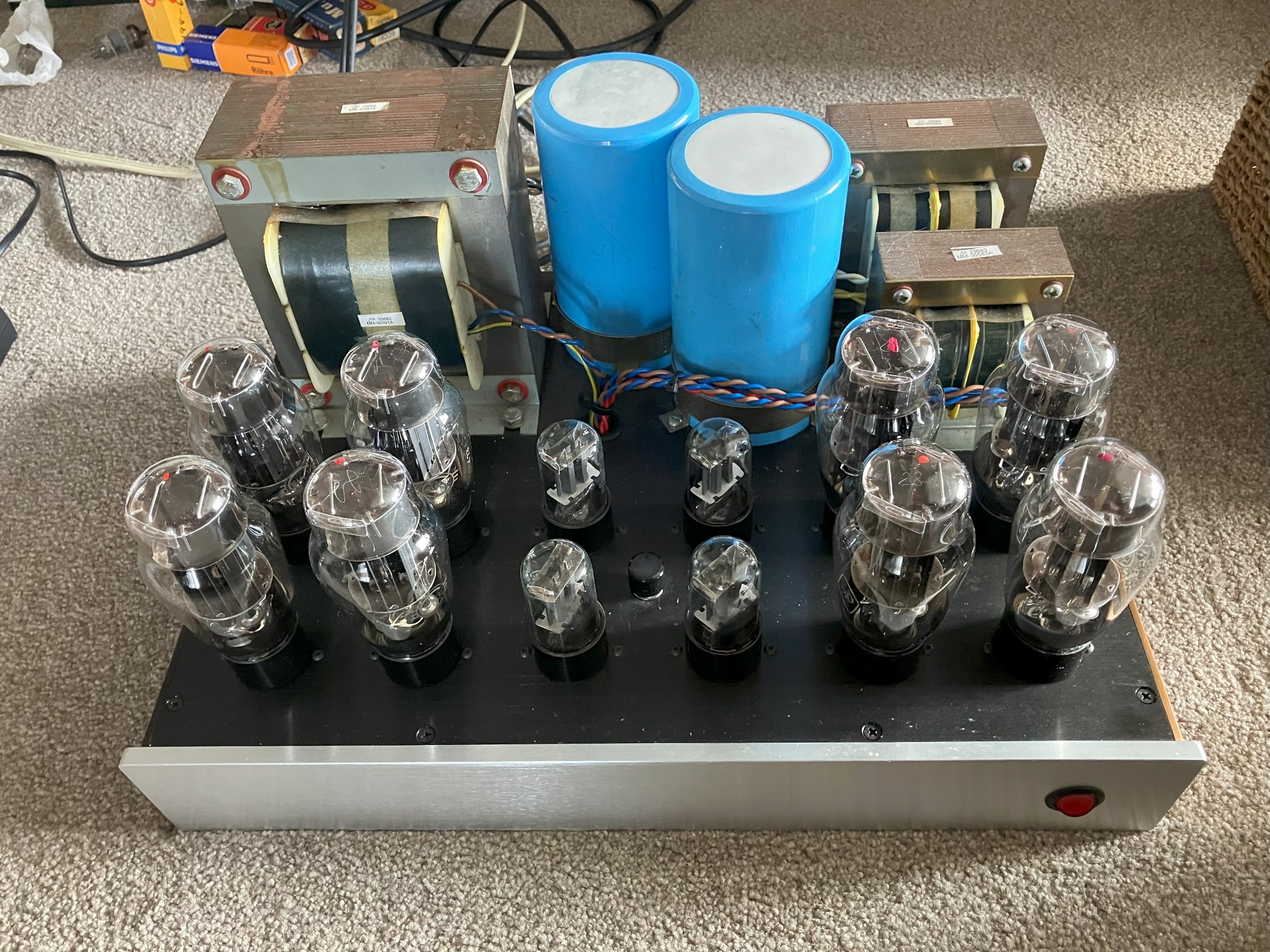

Have just finished up a single M-60 mono block I have built up from a bunch of parts from someone here in NZ many years ago, I initially finished this a couple of years ago but when i went to test it had pretty much zero gain and i only had a home theatre amp as a source which i thought was my issue and have recently got a couple of tube preamps (Conrad Johnson PV10a & Sonic Frontiers SFL-1) but it turned out I had the single RCA input splitting across both balanced input pins (1 & 4) on V1 instead of just to pin 1 and then having pin 4 to the ground of the input as per XLR shorting plug design!
The build is a bit of a hybrid of the information contained in this forum and now I'm getting back into it I see there have been some updates, still have a couple of things to tidy up due to finding that issue yesterday and I have roughly connected those up, have left out the A/AB selection but something i would love to know is the reason for the feedback switch, which is shown in some diagrams and not others? I currently don't have one fitted but is easy enough to add, i also don't have a DC balance switch or meter installed and have tried to set this using a digital multi meter for the moment without much luck at getting in spec? Was trying to find a nice meter to use for this but couldn't find one when I was looking a while back so I better resume that search.
I also need to add a second switch so i can tuned the heaters on before the high voltage stage but currently it appears to function perfectly fine.
You will notice the two big capacitors which are 3400uf 350v for the Bridge1 & Bridge2 supplies, I used these as I had them but these will probably be something that could be upgraded in the future as I see most builds are using 1000uf quads for this! I did pick up some 2200uf 200v PCB mount caps at a flea market that I might use once I make a version two case! Couple of pics attached. Cheers

@fabio1983
The feedback switch was sometimes an option. I'd leave it out and run the feedback.
We typically ran 6600uf per bridge supply. The earlier amps used a smaller value. We had it spread out between 3 filter caps of 2200uf each. That allowed us to install a 1 Ohm 5 Watt resistor between the input of the supply and the remaining 2 caps, rounding off the top of the sawtooth waveform a bit. When the amp is properly balanced, the sawtooth cancels so isn't heard.
The Mk3s all used a 5 Ohm cathode current limiting resistor rather than 1 Ohm.

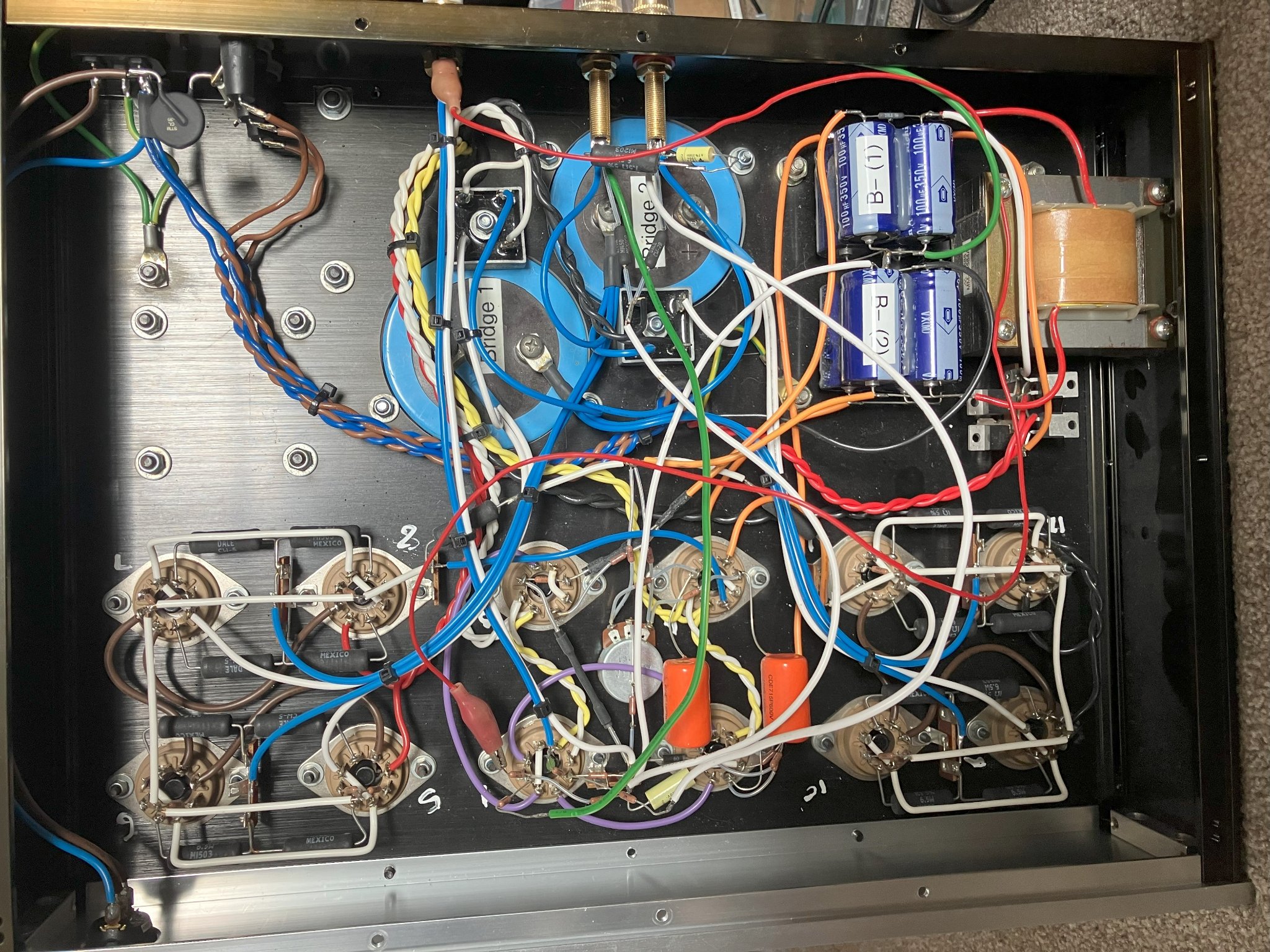

I have noticed how hot the case gets even with the bottom open, am going to redesign the layout and have some vent holes added around the 6AS7s and reposition the transformers on top so its more balanced and then will have a new arrangement for capacitors underneath instead of the two beasts i currently have!
If all there is in one of the bridge supplies is 2200uf it will work but you'll hear it sounding better (particularly at higher volumes) with double or triple that value.@atmasphere
Thanks for your reply! The 200v 2200uf ones I have should be suitable then? I don't have a scope to check a few things and I do have a noise that is very much like a sawtooth when I make one in a sound generator! When I connect my multi meter across the speaker terminals this noise does reduce, if using the multi meter to set the DC offset i should be aiming for 0?? (in mA setting?)
I will update the cathode current limiting resistors to 5 Ohm for my next block build.
If you look at an actual M-60 chassis they have a lot of cooling holes- there is a pattern of holes around each power tube. The bottom cover has slots as well and the power supply cover has more.
With the 5 Ohm resistors if a power tube shorts its less likely to blow the links in the base of the power tube. This can result in the amplifier pushing a fair amount of DC current. So its important to pay attention to the fuse rating of the B+ transformer and in the case of lower power full range drivers an inline fuse is recommended. That's a good idea for such speakers any time the amp can make more power than the rating of those drivers.

Those square waves look classically perfect. Now, get a test CD, and look at the square waves, they are not classically perfect.
