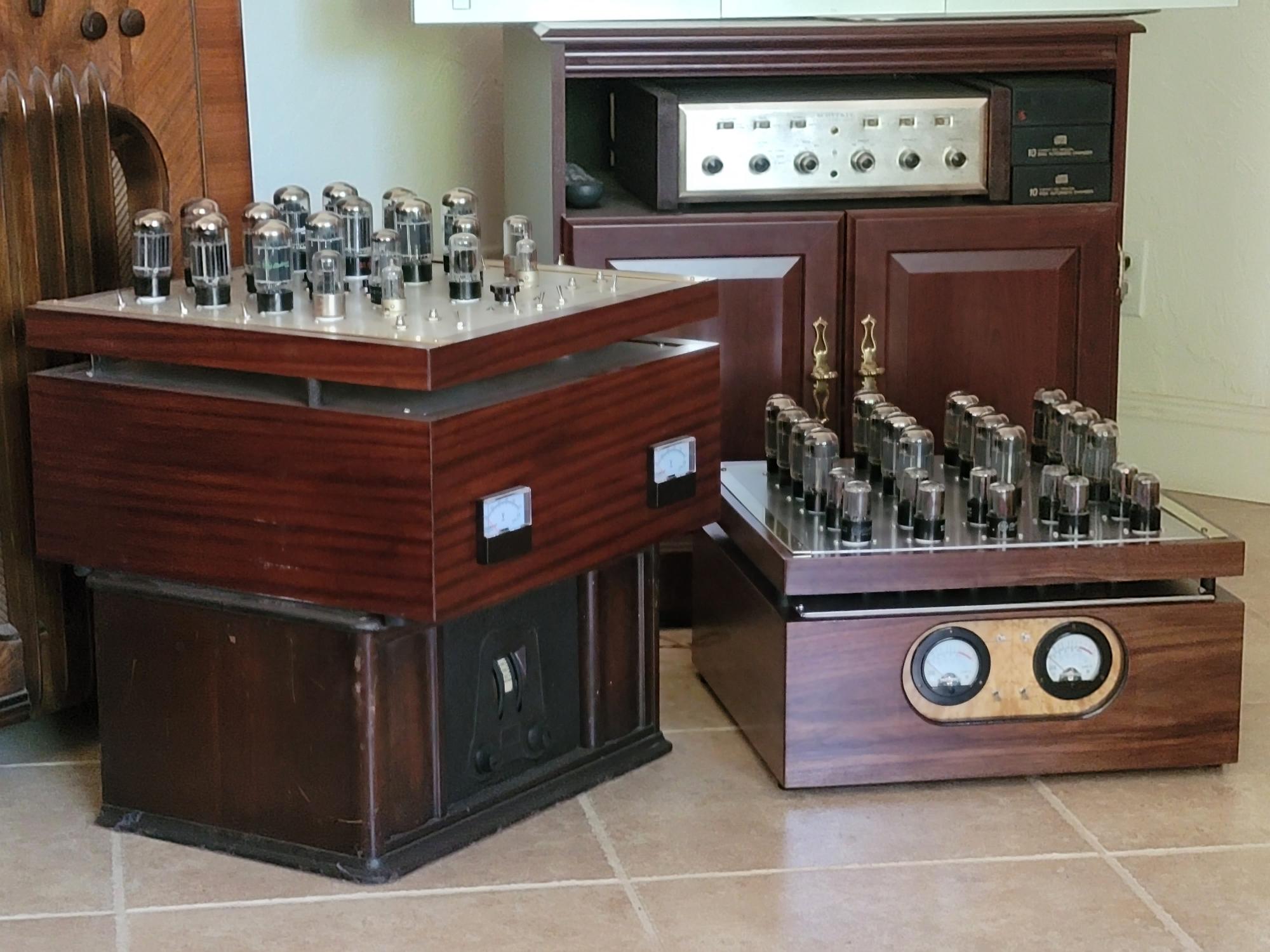

So, I felt strong this morning. Picked up and moved the 6 (12) tube Futterman and hooked up the Circlotron in it's place. At first I was sure I had a phase problem. The sound stage was wide, but I could not point at the lead singer. The bass was strong but it seemed that some frequencies were muted - - Lifting OTLs and early mornings seem to affect my golden ears. After lunch I swapped +, - on the rt speaker. That was defiantly wrong. Returning it to normal and retesting proved the issue was with me. More coffee! (or less blood pressure)
I have a lot more experimenting to do , but initially the Futterman and the Circlotron sound very similar. There is no hum in spite of my RCA cables. There is better gain on the M-60 clone(s). I had to add another stage (unused portion of the first triode also changed to 12AU7) on the Futterman to get that kind of level. I think most people would consider that a real plus. The song I was just playing just ended - it is so quiet, which leads me to say - don't forget to turn it off. It's going to be 100 deg. plus and I don't need a space heater.

I used a similar cabinet design that separates the hot tubes from the power supply. The top is hinged. The heat shield below is where the bias pots, fuses and other maintenance items reside. I intend to place a screen in the gap, probably chromed or polished, but I need about 51" x 2". Finding 51" is the problem. If a person wanted, this could become a 2-piece construction with the lid separated from the power supply. I had to add a fan to the first Futterman. Even with the tubes on top it was getting too hot inside - I don't like fans. It only had 4 6AS7s per channel.
The Futterman is setting on a 1920s radio cabinet. Every inch off the ground (floor) makes for easier lifting.
The Circlotron cabinet is solid walnut, the Futterman, mahogany. They have the same footprint but the Circlotron is an inch or two shorter and because of the toroids, is a few pounds lighter.
All of the 6AS7s used in the Circlotron are RCAs with the single grid radiator (sink). The Futterman has GE - GAs with no sink. They have been ok at 160V but if you can get the RCAs for the same price, get them. If you can get the STs at the same price, get them (2 sinks).
