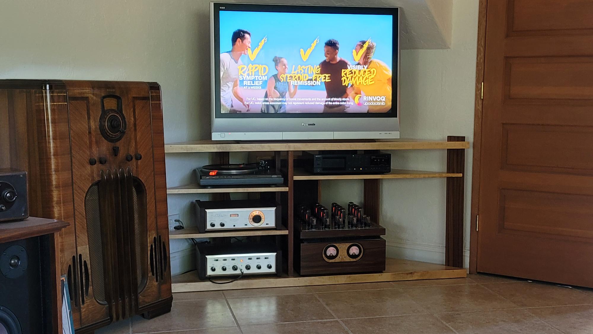

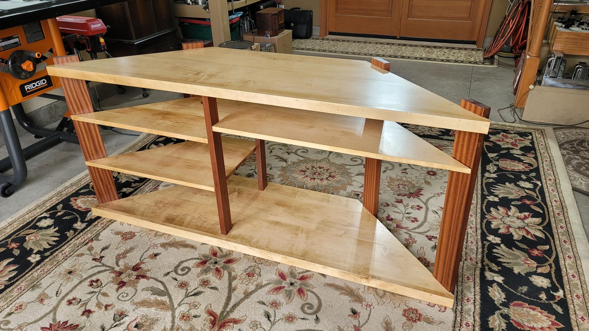

I needed a way to switch out the amps for a listening comparison along with being able to switch input devices. So I built a new entertainment ctr. Oh yeah, I tried to find one to buy, a corner unit with shelf spacing to accommodate the large, hot amps. I must be the only one that needed something like this - so I built one. It is .8 in hard maple and 1 in mahogany.
Using the Scott as a pre, for a while. Now I can continue my comparison, though the differences between the Futterman / Circlotron are more related to practicality and construction. I can tell you now they sound very similar. One other surprising observation is that my Lenovo (used as music server) sounds better than that Sony disc changer. Both have variable output not requiring a preamp.

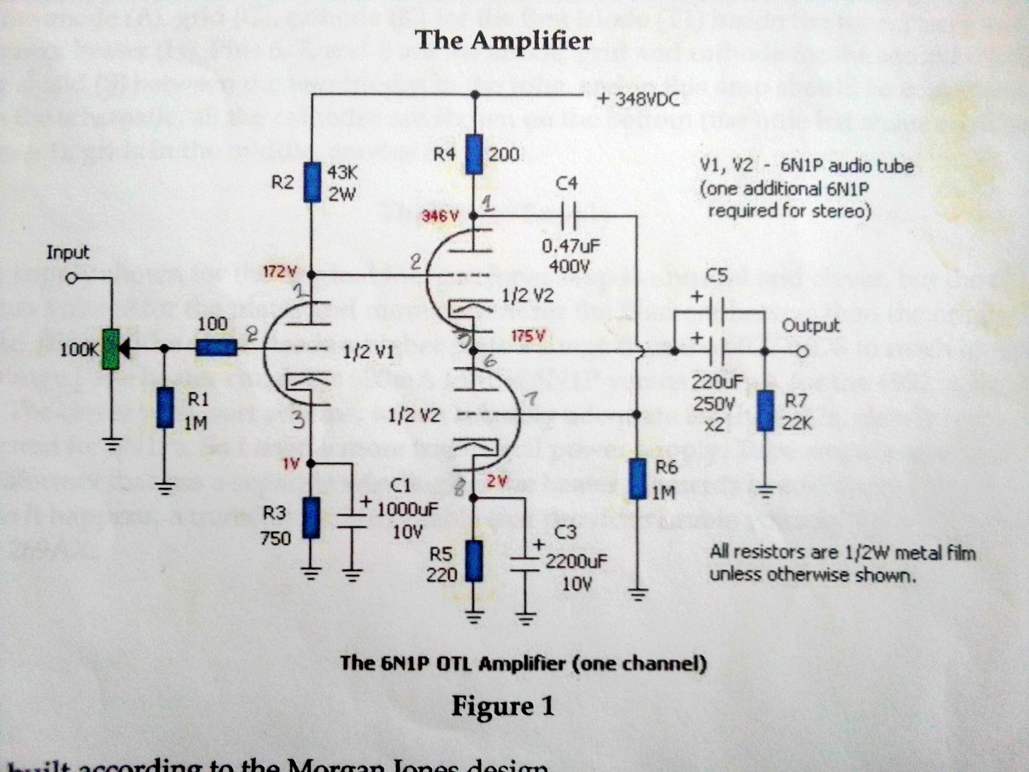

Driving a 38 Ohm Headphone with a 6N1P OTL.
Amazing!
Is there anything special or unusual about the circuitry or parTh
Amazing!
Is there anything special or unusual about the circuitry or parts?
There isn't anything special about the circuit, it is very simple, it's just a standard triode gain stage directly coupled to the grid of a White Cathode-Follower output stage that's been modified so it is balanced properly, here's the schematic, the value of resistor R4 (200 Ohms) has been chosen so that the triode in the top half of the White Cathode Follower has a voltage gain of 1, the signal is AC coupled from pin 1 to pin 7 via a .470uF/400V cap, the two triodes act like a push-pull output stage, and the signal on pins 3 and 6 is AC coupled to the headphones via two 220uF/250V caps in parallel, since the top triode in the White Cathode output stage also acts as a cathode-follower, or common anode amplifier, it provides a low output impedance.
Amazing!
Nothing special or unusual about the parts I used, which were all standard electronic components you can buy online, resistors were 5%/1W and 5%2W Metal Oxide types, nonpolarized caps were standard yellow RT metalized polymers rated at 630V DC, the other caps were standard RT types rated at 25V DC, and 63V DC, the output caps are standard RB can types rated at 450V DC, the main +HT filter caps are standard dual can caps rated at 500V DC, the tubes I used were three brand new Svetlana 6N1P medium mu (33) dual triodes, the three 9-pin sockets I used were standard Belton types, I used a standard Alpha 24mm dual-gang 100k log pot for the volume control, I used gold plated RCA sockets for the inputs, I used a standard 1/4 inch stereo Cliff Jack for the headphone out socket, a standard Hammond 369AX power transformer, a standard 3AG panel mount fuse holder, a standard 240V AC 3-pin plug and 2m of standard 240V AC 3-core mains lead, no special "unobtanium" parts were used at all.
