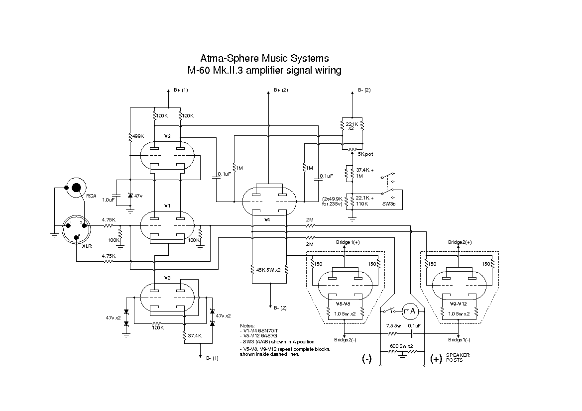

@Bambini,
This should be similar to the m60 Amp.
Best regards, Frank

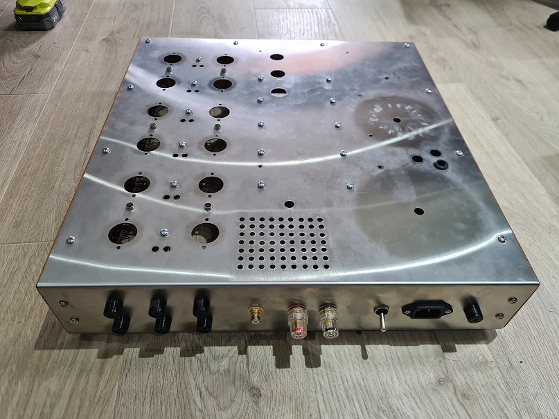

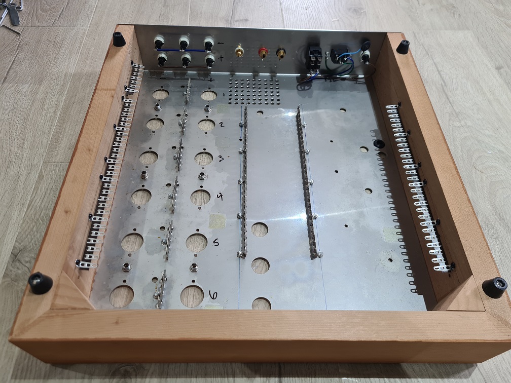

Hi All,
Almost ready to start the M-60 build. As mentioned in a previous thread, am using the chassis I built a pair of Transcendent Beasts in some time ago. The pcb's and output circuitry of these amps have gone to a new home. Still missing some key parts, but got plenty of bits already, and planning on spending some time over Easter with the soldering iron
Will post a few pictures on the forum as I go.

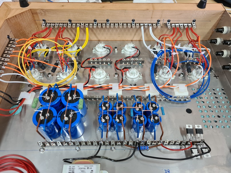

Amp No.1 progress

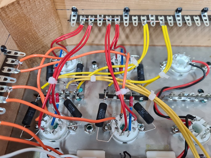

Hi All,
Thanks for the comments and feedback. A few photos attached of the build of the 1st amp. Output stages and power supplies now almost complete. Just the driver stages and then the fitting of the transformers and we should be almost ready to go. The predicted Siberian weather that we are expecting in the UK tomorrow should give me a good excuse to lock myself in the cave and get this first amp finished off. 😀
Hi All,
