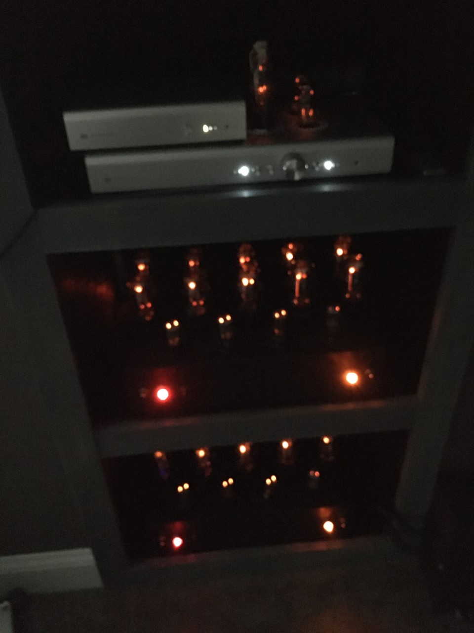

I built my mono blocks based on the Atmasphere M-60 about two years ago.
It's a proven circuit and I've had zero issues with them other than putting
the large toroid transformers in a separate box to lower hum.
They sound amazing and drive my super Heresies effortlessly.

It’s based on the atma sphere M60 amp but uses ecc88 in the differential cascode and individual cathode follower DC coupled for each output tube.
I run the cascode at 2.5mA per side and the tail is also a tube based cascoded ccs.
Input stage cascode loads are 100k 0.1% precision wirewound resistors.

No, on the 6SN7.
If you have a differential cascode with a 6SN7 acting as a cascode CCS, you have cathodes at a wide variety of voltages.

I think you'd need 2 or 3 separate heater supplies for the drivers to keep the heater cathode voltages reasonable.
Yes you are right. I'm trying to decide on the best solution.
Properly done it should reduce the noise floor a little?
Thank you for the heads up. Will let you know what I come up with.
Thanks again
It will reduce the noise floor significantly and prevent damage from occurring to your driver tubes. If you hear a noise that's more of a sizzle than a power supply noise, that's your heather cathode insulation begging for mercy.Yes you are right. I'm trying to decide on the best solution.
