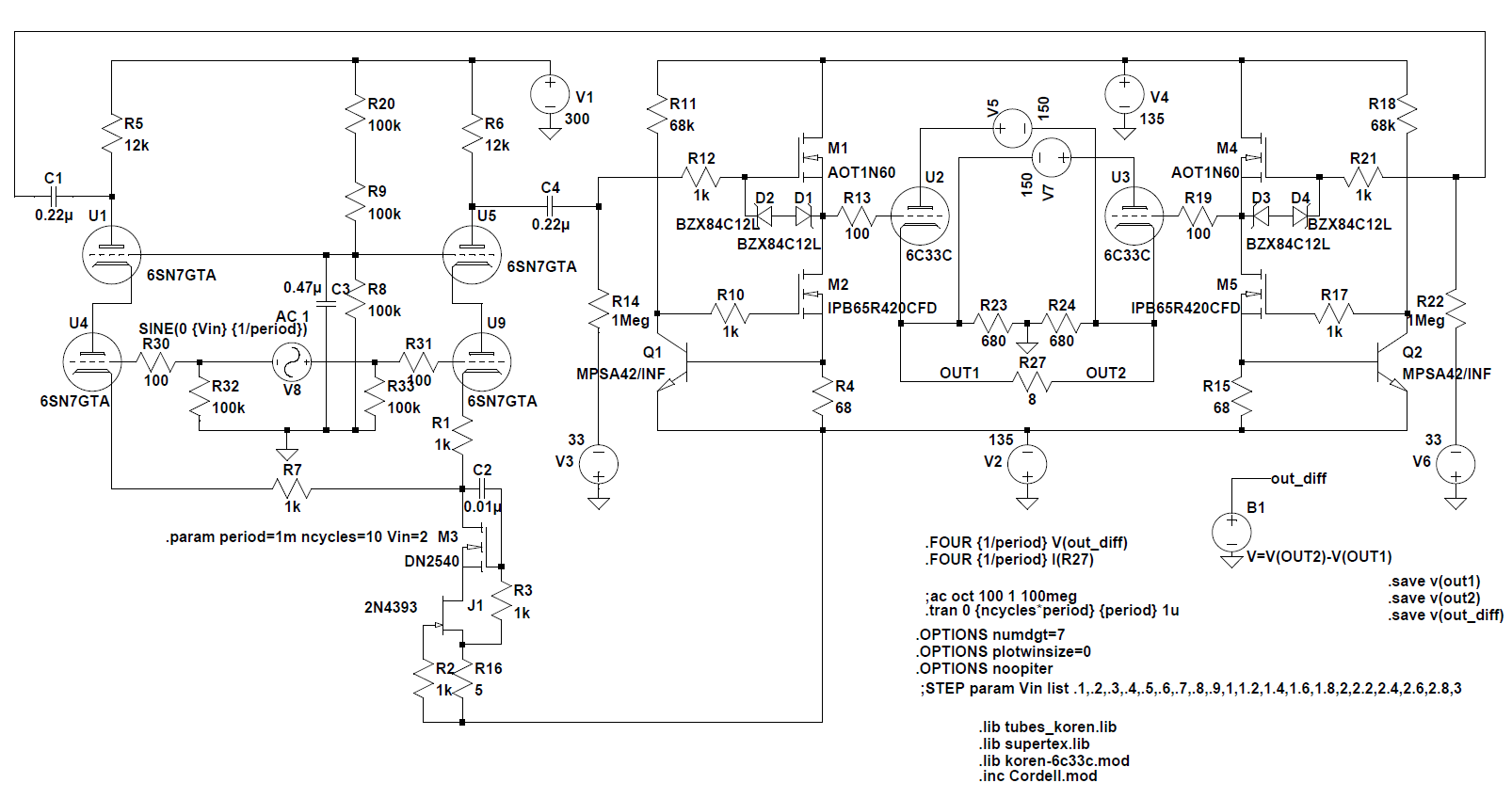

^^ I think you can eliminate R1 and R7- that will improve the CMRR.
I think also that the performance can be improved by using a zener diode in place of R8 giving the same voltage. However, some zeners can be noisy so you might have to install a PI network to feed the grids of the top tubes of the voltage amplifier.
It appears that J1 is being used as compensation for the DN2540. IME a 2-stage CCS with two MOSFETs in series gives better performance with improved CMRR of the voltage amplifier as a result. The DN2540 is a good choice but should have diode protection on its gate; We usually run this part as the bottom part of the two stage CCS with an IRF820 on top. The resulting circuit looks a lot like its tube counterpart that I posted in the M-60 schematic way back when on this thread.

^^ High impedance and linearity are both important. A good solid state CCS is a bit trickier to execute as well. If you do it right, the solid state CCS will have about an order of magnitude greater performance but if you don't do it right in a word it will suck.
For some reason, most of the solid state circuits I see online in amplifier circuits are terrible. I have to assume the designers don't realize that performance is being left on the table.
