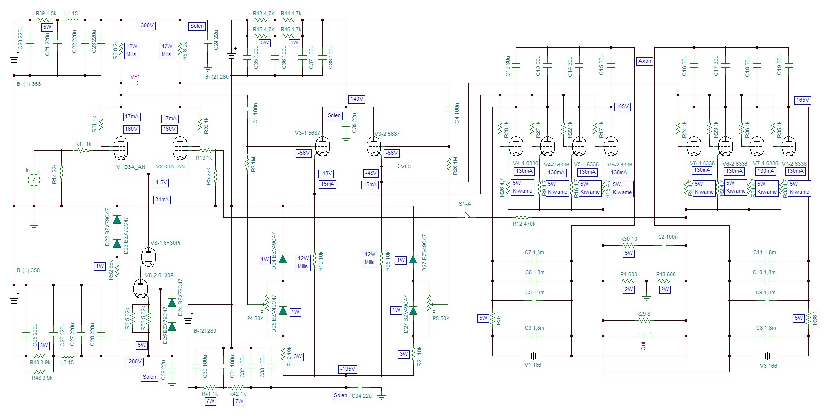

I have planned to build my own 6336A circlotron OTL amp (2 monoblocks), I have got all the parts but I have not yet found the time to build it.
If you are interested I attach the schematic so you can take a look at the driver stage (D3A + 5687).
Andrea

Yes, but you can deal with those capacitances by using a driver with very low output impedance! but still difficult to achive 250KHz (-3dB) without global NFB, even if you use a common grid voltage amplifier in your circuit.
It could be a Circlotron then, wider bandwidth as input capacitance is very little in cathode connected load?
I presume the output of Circlotron is always< unity if cathode connected, the overall gain does not increased in parallel tubes. Maybe I have simulated it to make sure.
Oh, beside the mu of 1.5, the actual input capacitance Grid to cathode and heater(6080) is 5.5 pf, there is much difference if the stage has net gain or not (when parallel more tubes GM always increased) as capacitance due to Miller effect would be more in totem pole, esp the bottom tube which is a common cathode stage.
I know Miller efect well 😀 I said that it will be no great difference because we have mu of 1.5, meaning that this difference will be small compared to a tube with mu of 5 for example , beside this you are making a mistake here, in Futterman topology the two tubes are working as common cathode not only the lower tube, in the inverted Futterman topology (which I use it in my amp), the two tubes are working as cathode followers, that's why we have lower output impedance by using this topology!

Miller capacitance in a cathode coupled amplifier is cgp*(1+A) where A is the actual gain, not u, in a totempole OTL the gain normally is so low that miller effect is very low also. In my 25W OTL amplifier I have about 50V pk grid drive and output Pk is only 20V, (25W in 8 ohm) so gain is about 0.4, thus Miller capacitance is only 1.4 times Cgp, that gives wide bandwidth.
Don't look at the Futterman topology as a totem pole, the two tubes (or even many parallel tubes) are acting as common cathode stages, therfore there is a gain, in the inverted Futterman topology there is no gain because tubes act as cathode follower, read this circlotron-output-impedance.
