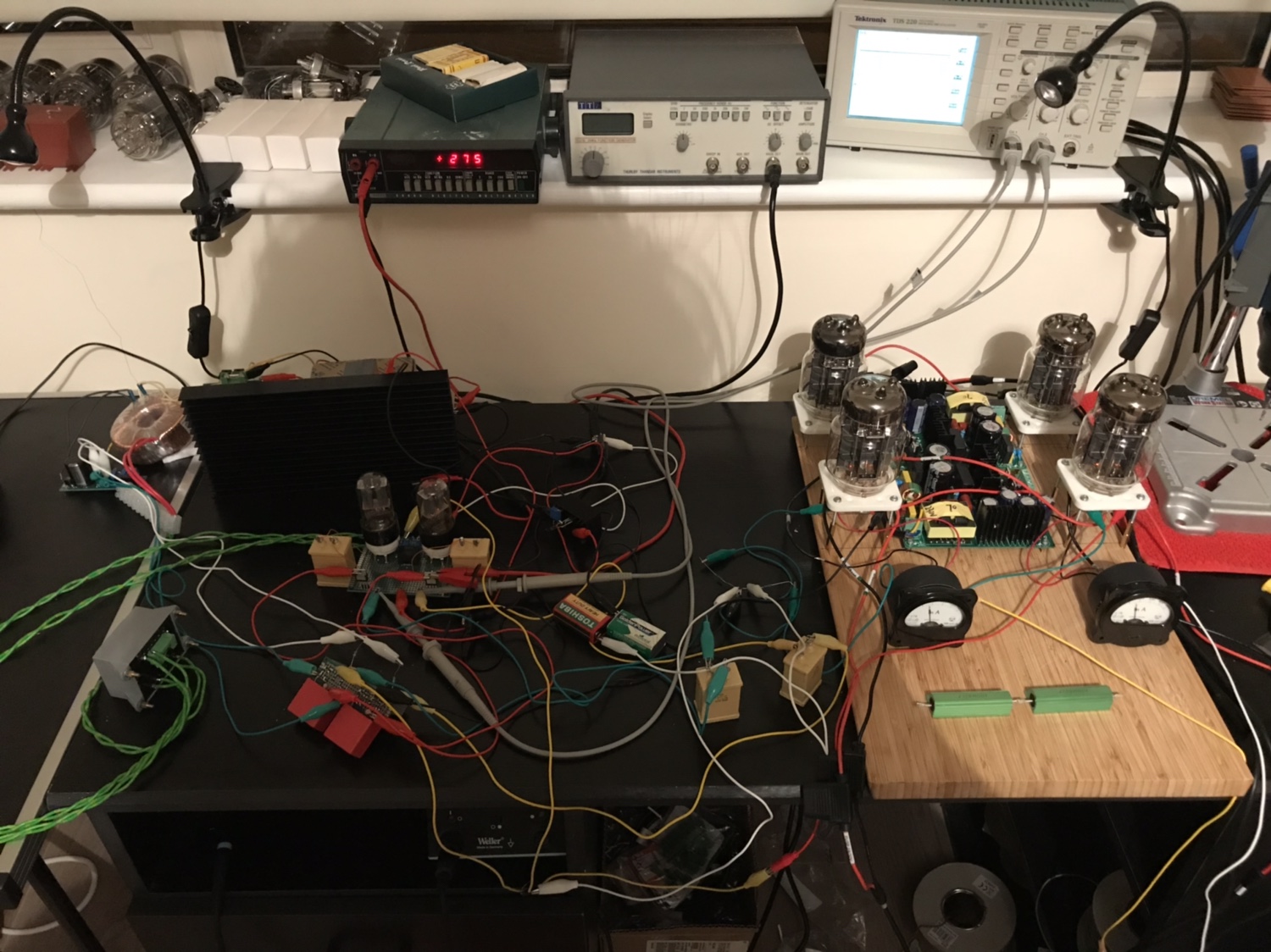

Hi PET240,
Have you made any progress?
Mine looks like this at the moment. It will have 4 output tubes, each with it’s individual dc coupled mosfet driver. The input stage will be a differential cascode or a differential pair (based on the gain needed) with a cascoded fet + depletion fet tail CCS set at around 16mA. Anode loads will be resistors or chokes... for the moment it’s all in pieces since I still need to decide on the input stage. Input stage has a salas high voltage reg set at 300V and an unregulated tail at -135V ish. Driver has a separate power supply, unregulated differential +/- 135V ish and power stage has two switching power supplies at 140V each. Coupling caps are 0.1uF russian silver mica or teflon. Speakers are Quad ESL 63. Will keep you updated if anyone is interested in schematics, pictures, tips and tricks, etc
